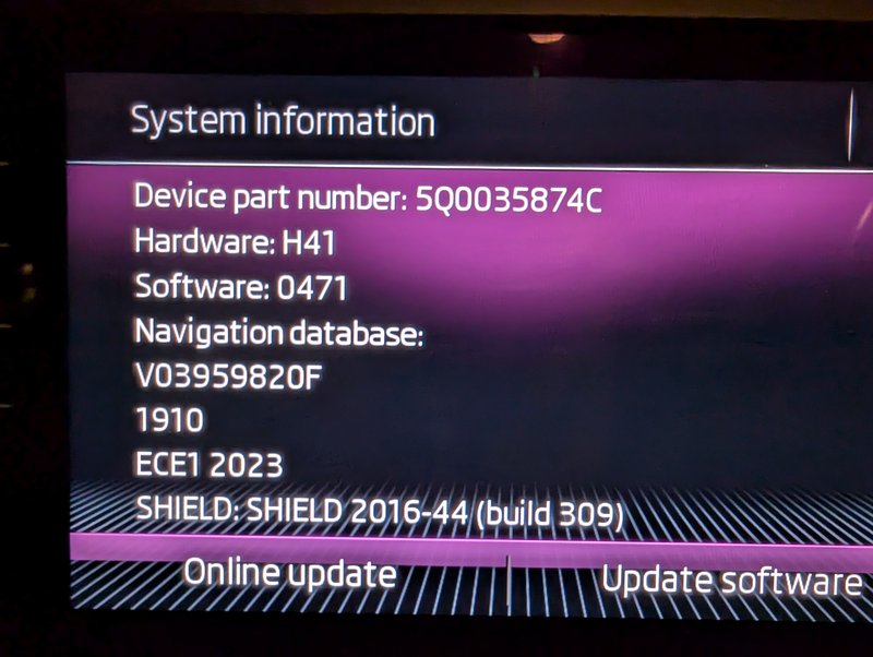

What version of firmware do you have?  The SOS function can be a bit....tempremental....I've found that an MIB firmware update usually settled it down.

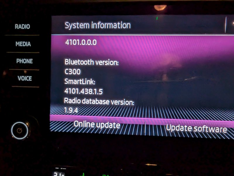

Not sure what's relevant so I've grabbed it all (i think!)

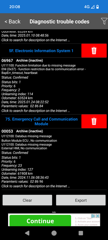

I did have a couple of possibly relevant DTC stored, not sure if they're relevant but the time is correct on the top one
Thanks for replying:  You need to get that firmware up to 0480.  Please look at the various threads about getting hold of the new firmware.  Your maps are also out of date (need updating to 2025).
