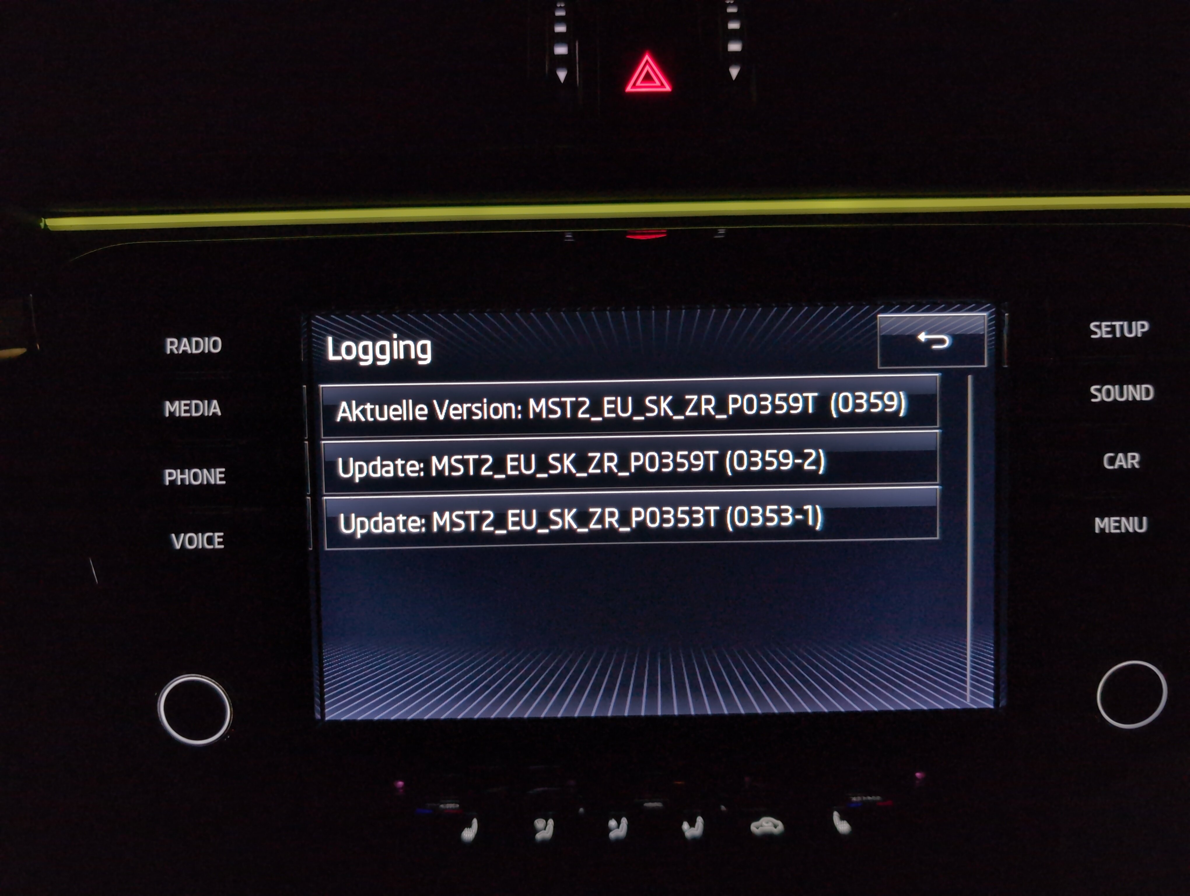

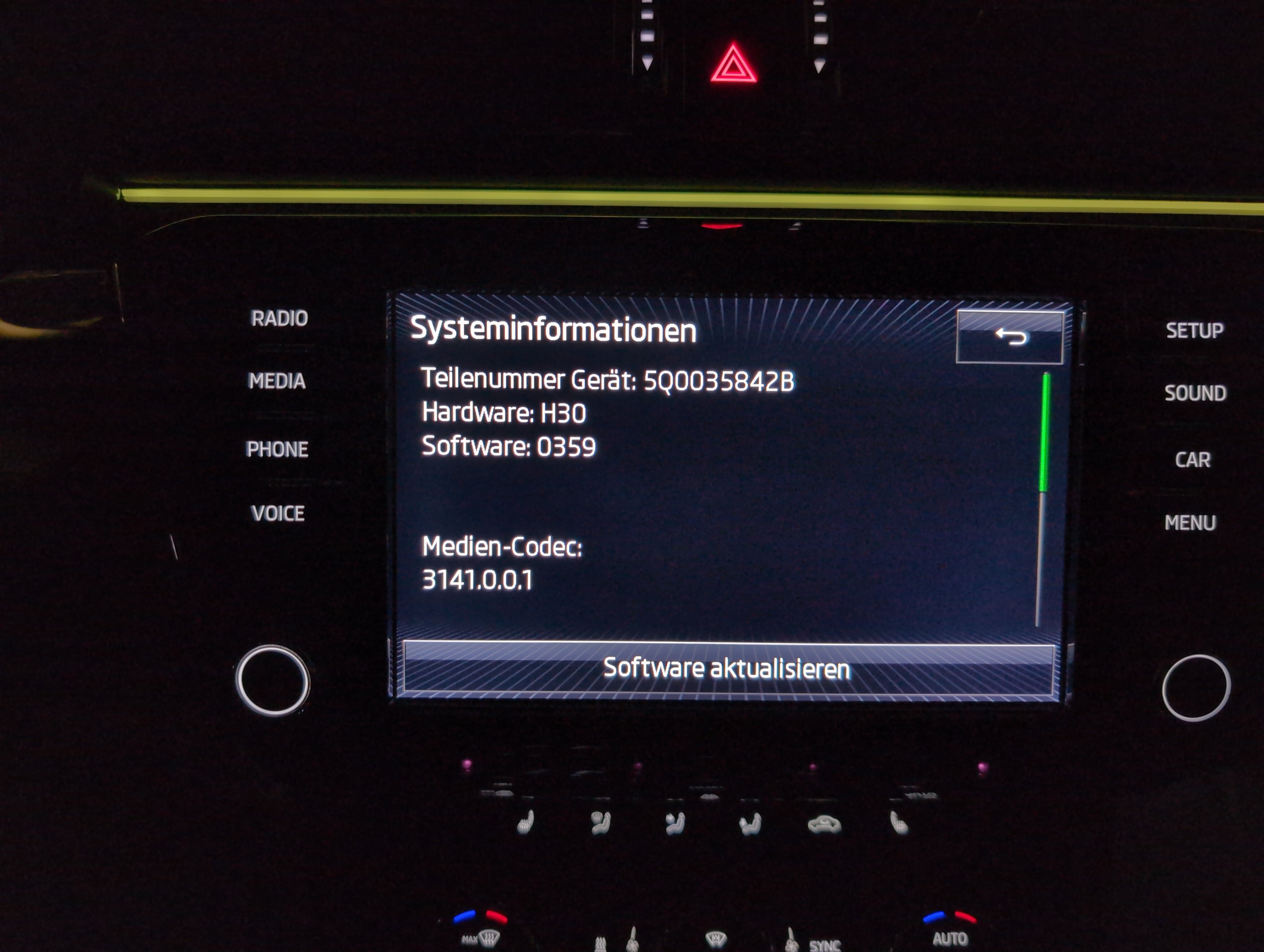

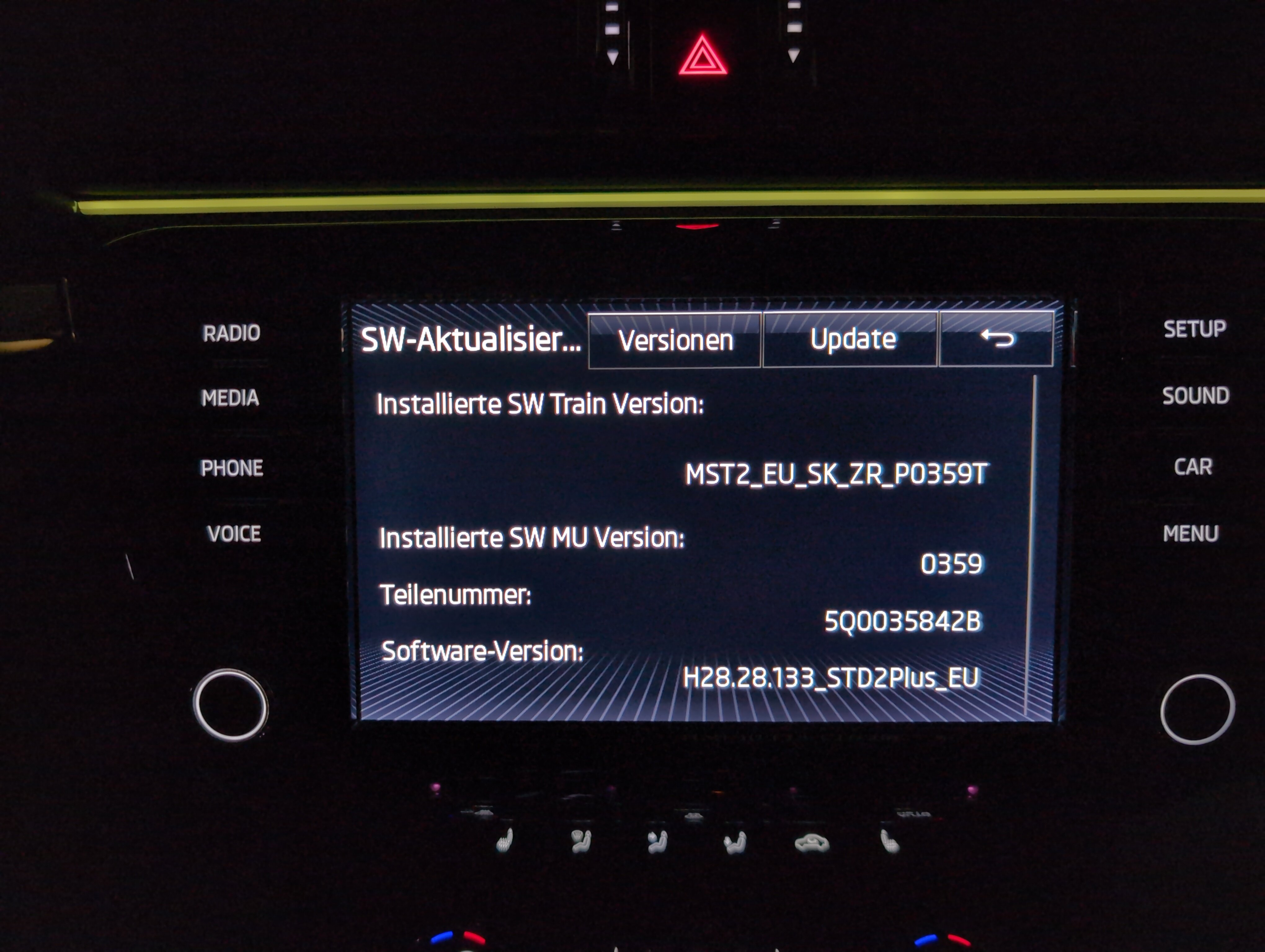

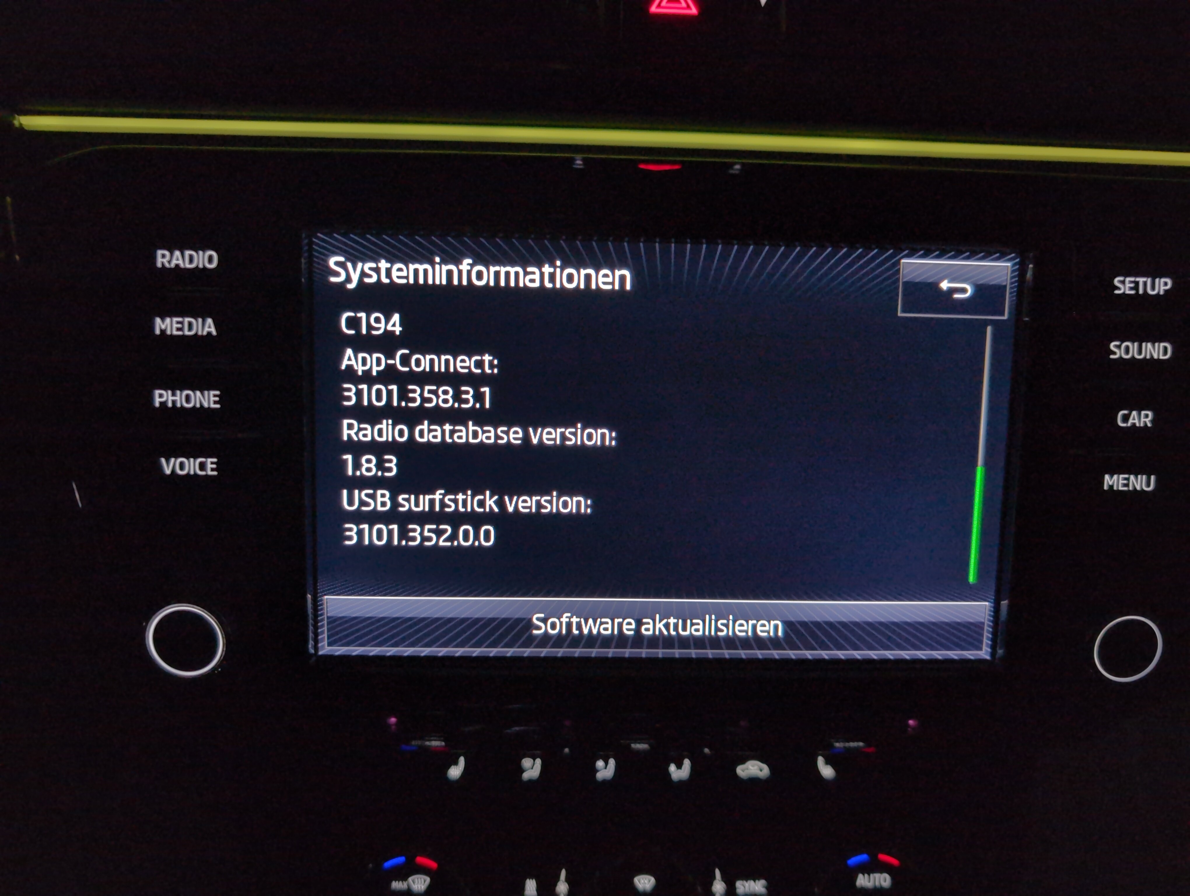

Installed firmware, see pictures.
Is there a newer firmware?
I have successfully updated from 0359T to 0369T.
I also updated the RadioStationDataBase to 1.10.52.
I have read that a toolbox is required for an update to 0480T, which requires eMMC access. Is this correct?

I've done update via SD card normally to 0480T without problems
Which version did you update from? From 03xx or 04xx?
Ye sorry updated from 0475
