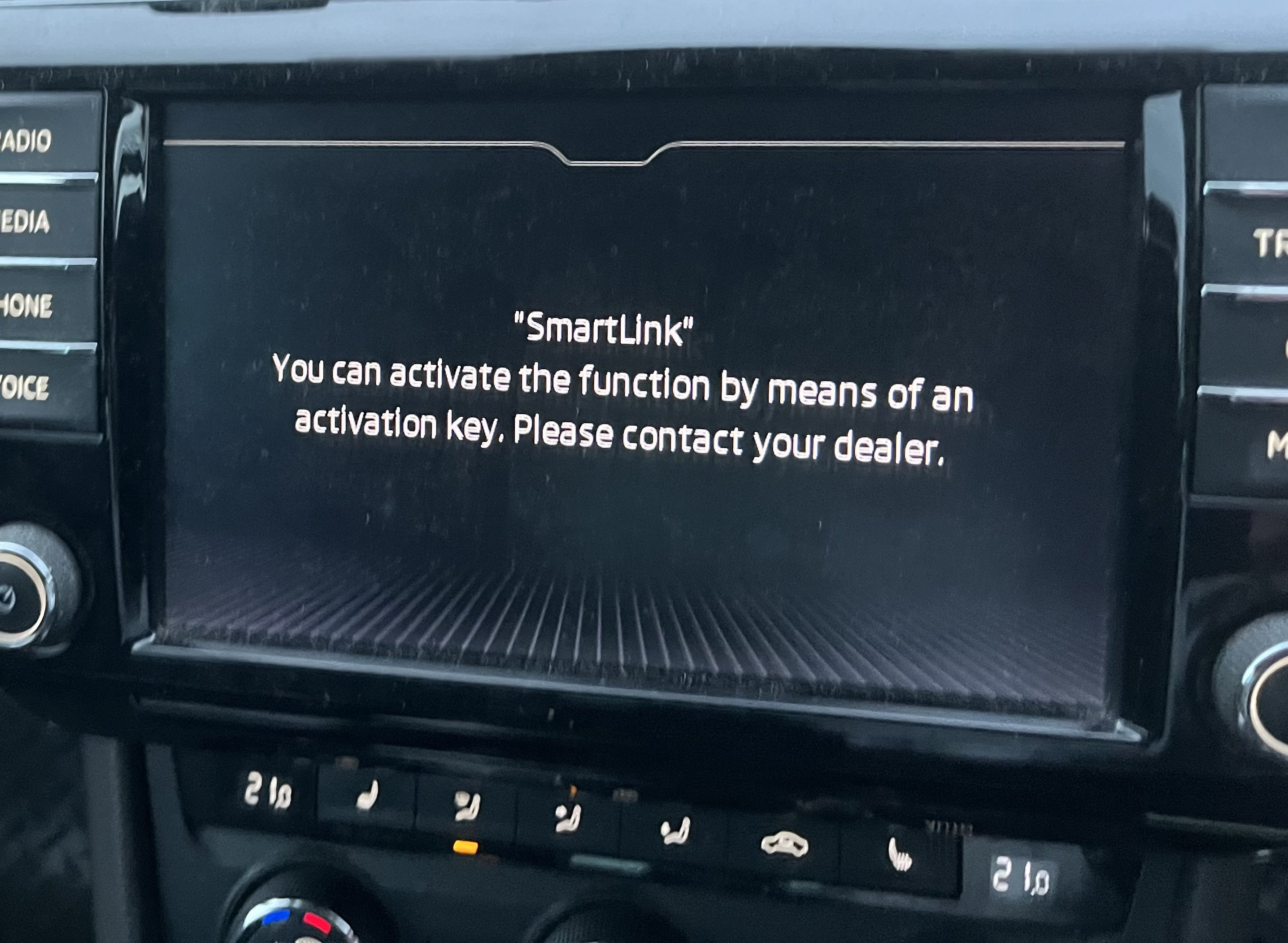

Hi All… could do with a pointer. Had my iPhone plugged into car … smart link working.. then nothing. Get a message saying “You can activate this function by means of an activation key . Please contacts your dealer “. I have held the on/ off button for 10 secs AND done a factory re set. Nothing. Any suggestions ? (Car is a Mark 3, Laurent Clement bought from Arnold Clark ). Cheers

@Craig0 - u need to take the car back to a Skoda dealer and get the SWaP codes reactivated/enabled again.
Is this a quick job ? Will it need booked in or you reckon it will be a quick pop in job ? Thanks

It's not a quick job as it needs back door tools/software.
Also depends on how busy the workshop is.
