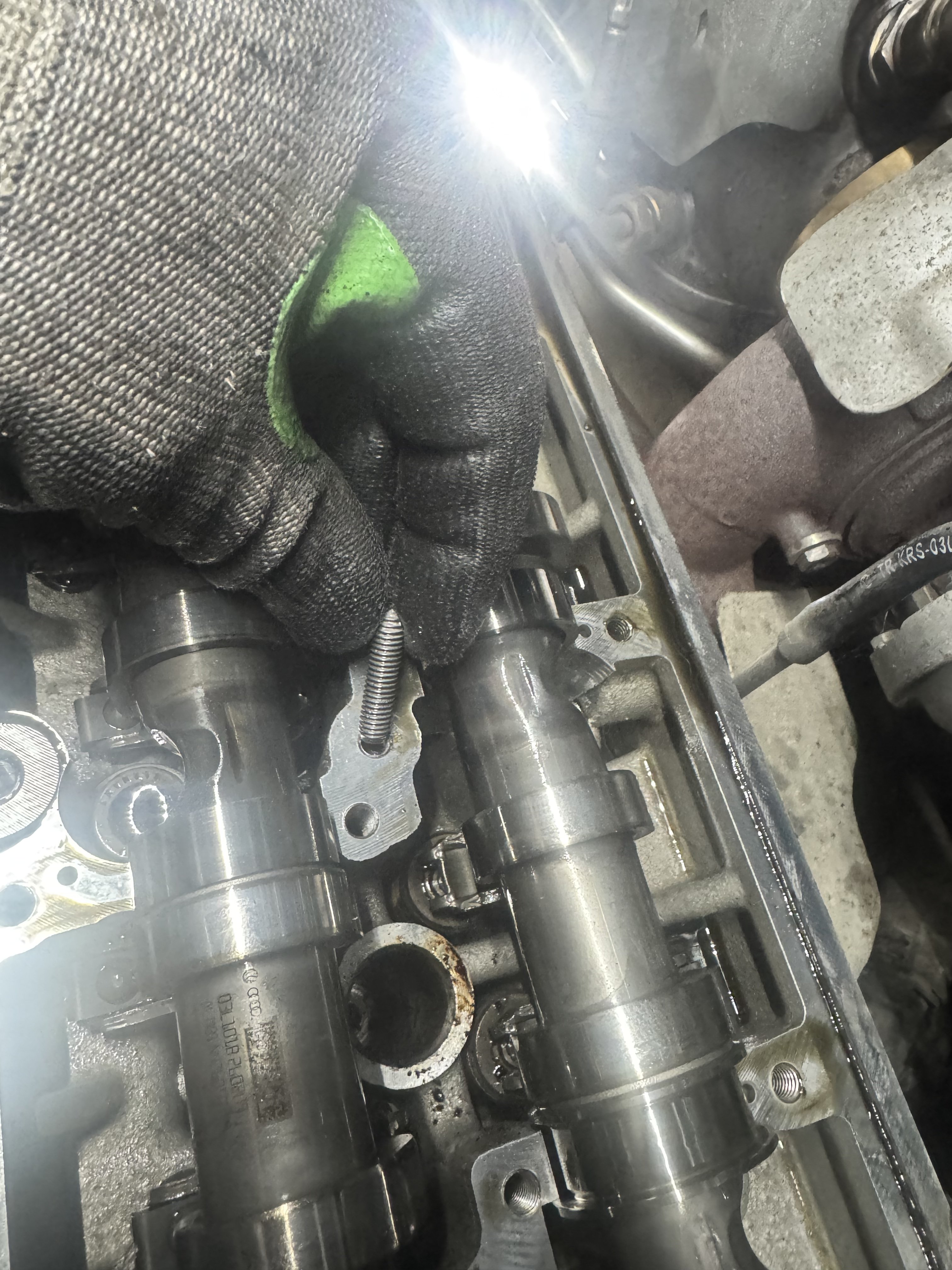

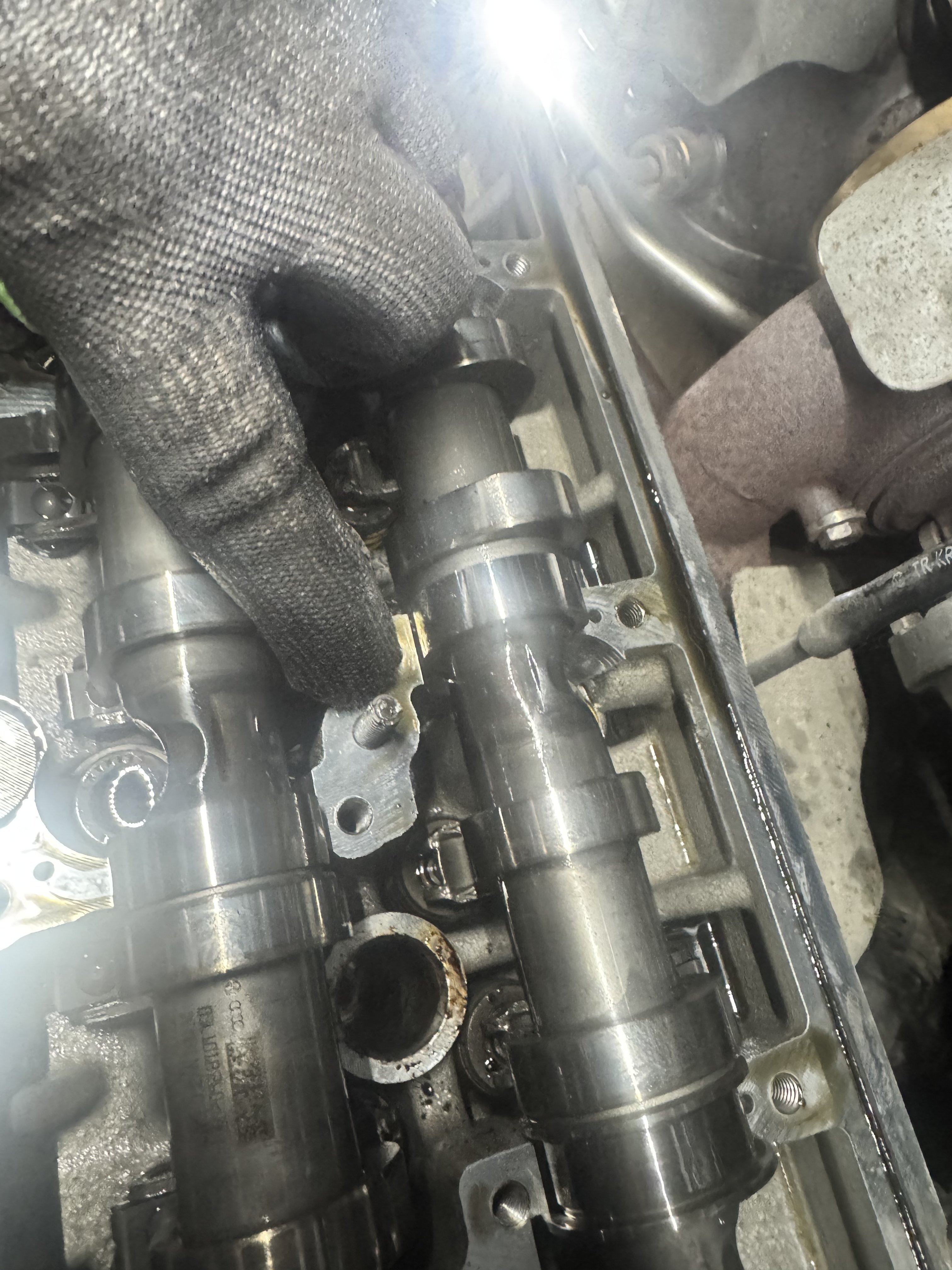

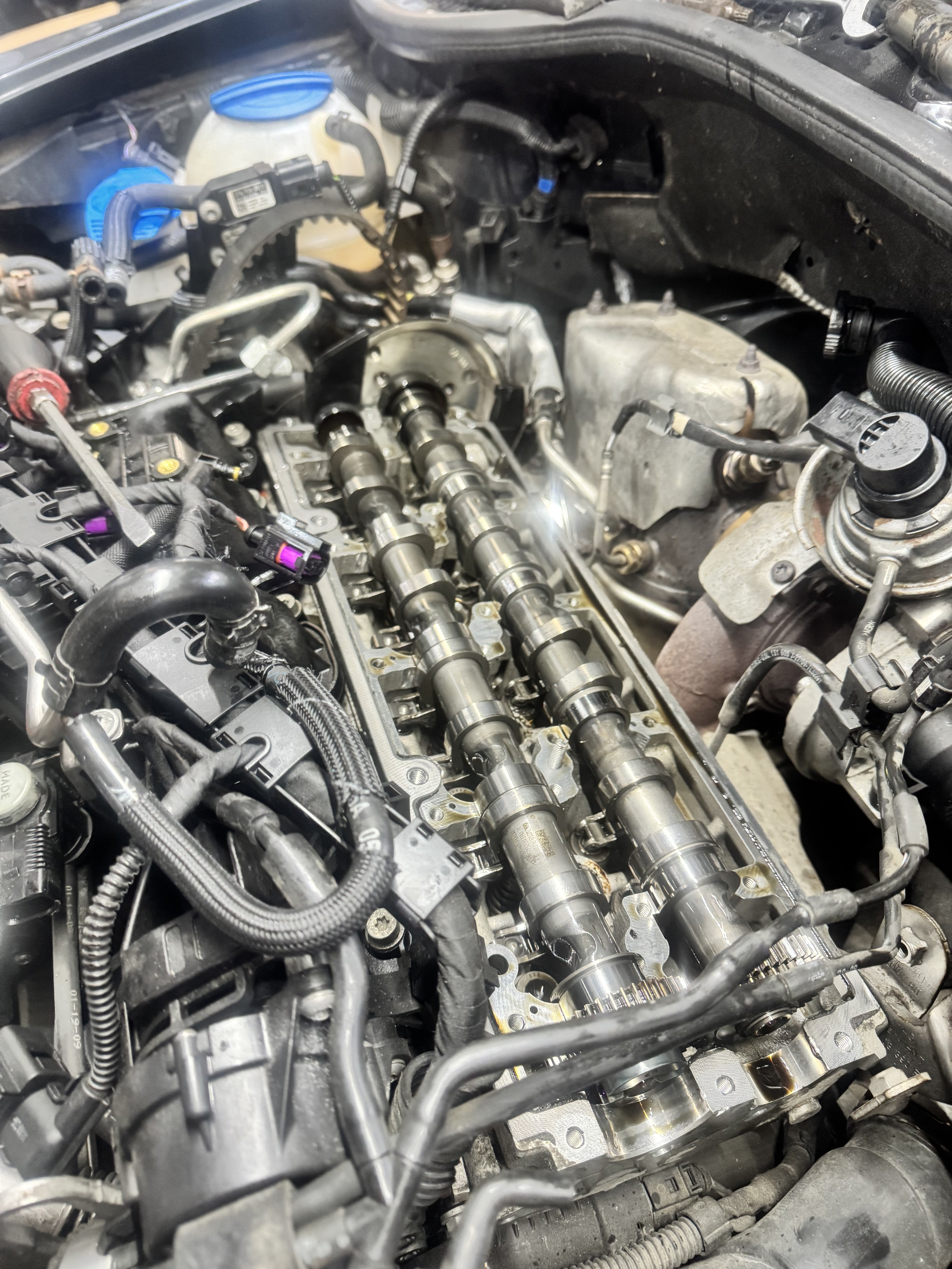

So it was indeed a screw or bolt, and from the looks of it:
- it couldn't really have fallen anywhere
- we dodged a bullet if the hole in the cam cover (?) had been threaded too!

- 1 cam cover (or whatever the cover is called that was removed to take the pics above)

Apparently the broken bolt did also thread into the cam cover because that part has had to be usiné (bored/drilled/sawed, no idea), presumably in order to get it off.

Almost 2450€ because of 1 broken injector clamp bolt which required boring out the cam cover in order to remove it, but also to replace the cam and accessory belts. And have the last remaining original injector replaced too, while we were at it.
