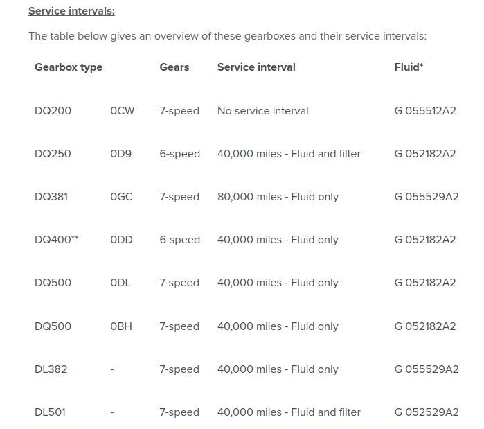

The official schedule for DQ381 seems to be at 80k miles. An oldish service cost illustration lists DSG oil change at 4 year/40k miles, and then 8 year/80k miles.
Is there any age related deterioration of the oil, or should I only consider an oil change at 40k miles at the earliest?

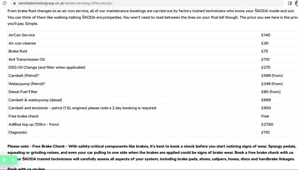

Oil and filter change at a dealership is going to be somewhere north of three hundred. The three quotes I had were all within a couple of quid of £330.
Quotes from independents (none of whom needed to be asked if they would change the filter) ranged from £280 to £370 .
For what it’s worth, those are not London or Home Counties prices.

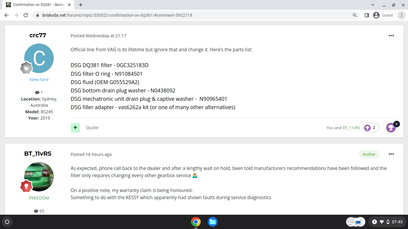

@SimonB68  DSG,s like a DQ250 or a DQ381 are not serviced by year and a DQ250 is not at 4 years unless that is @ 40,000 miles,
a DQ381 is at 80,000 miles or sooner, but 4 years is not relevant.
