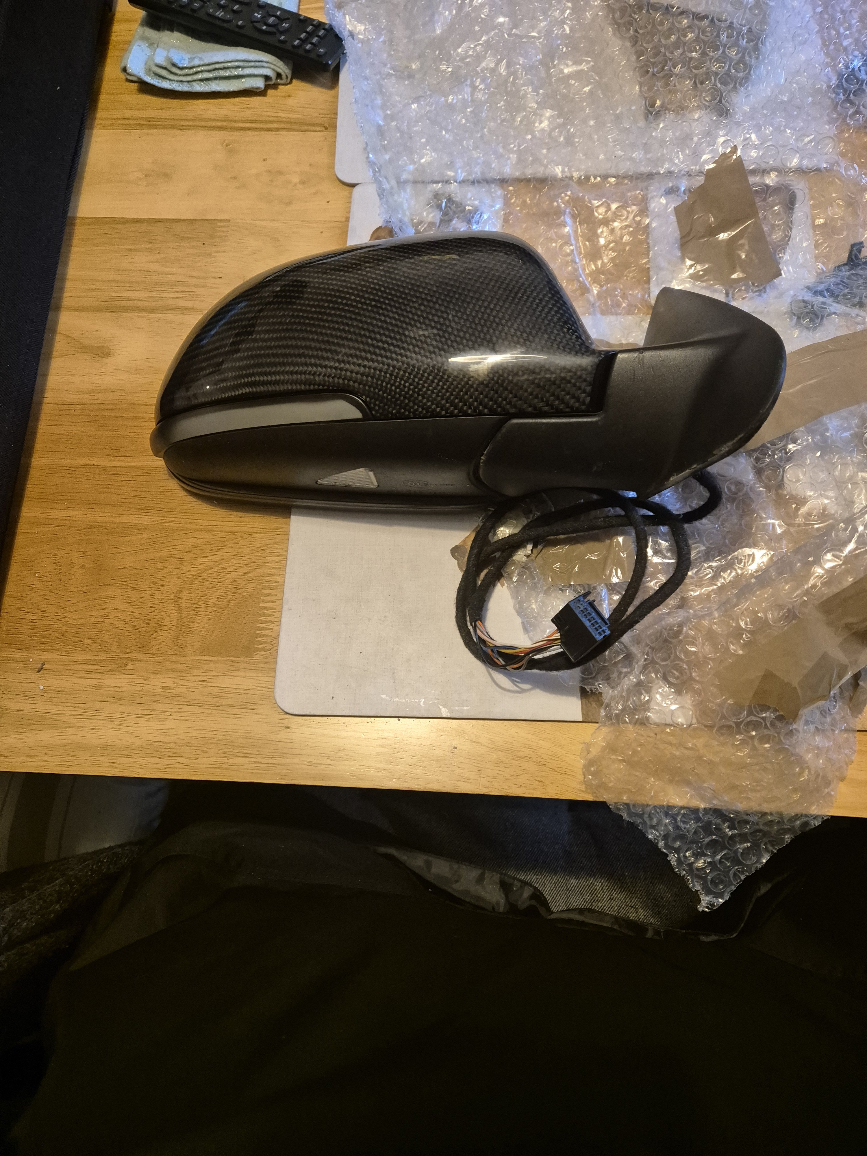

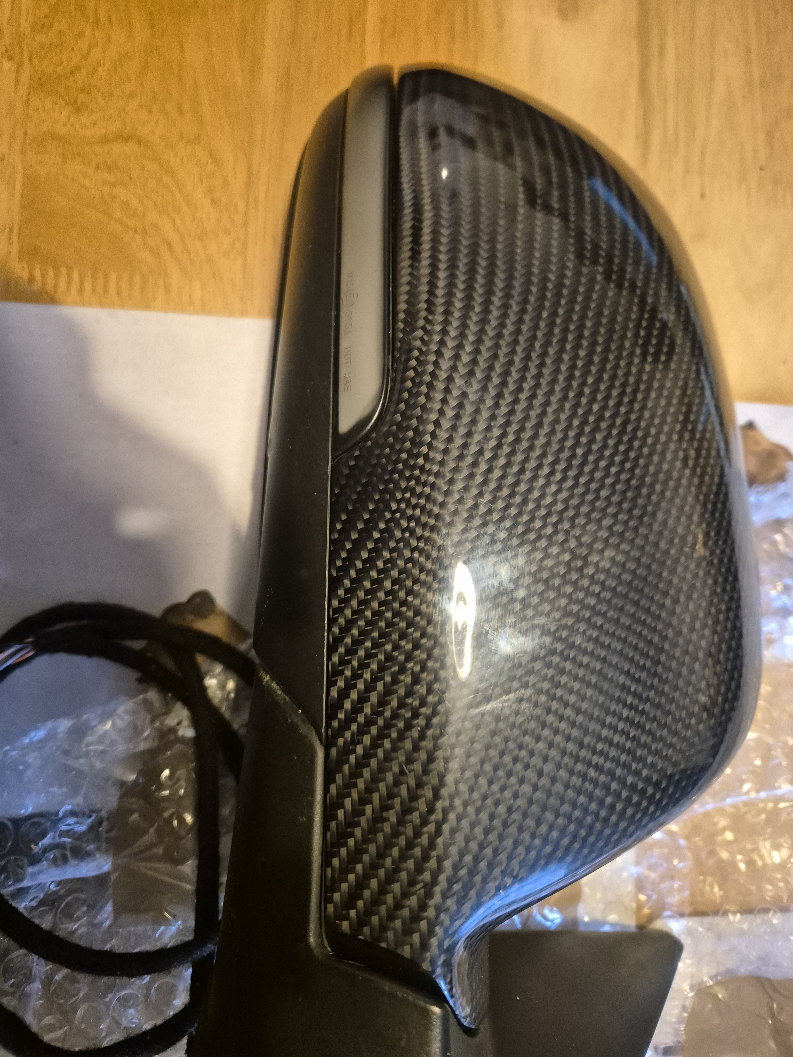

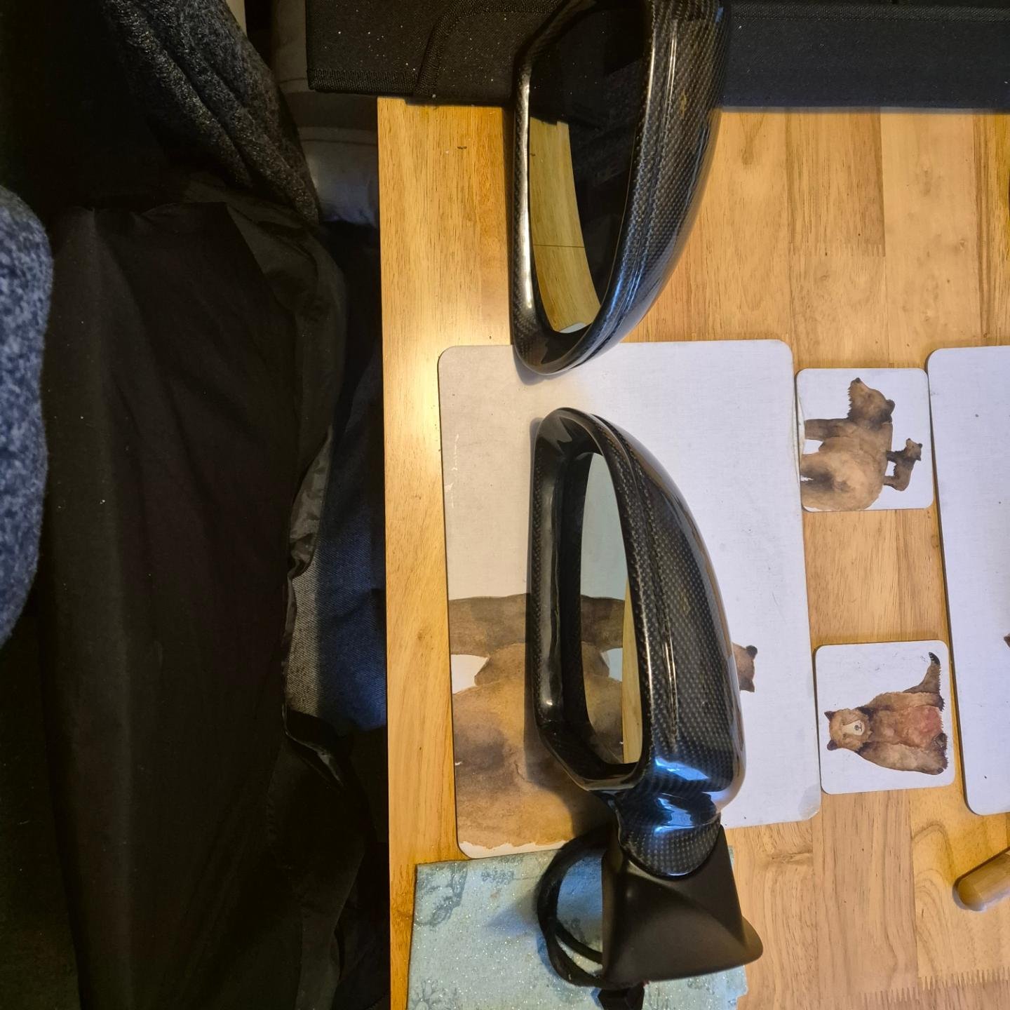

I have an 07 vrs and fitted the powerfold mirrors from a newer fl mk2. The job is as simple as it gets. Remove the door card and sail panel trim. Access the 3 bolts to remove the mirrors and unplug the electrical plug, then refit the powerfold mirrors. Then remove the door module/window motor. Replace with the new door module/motor. Then plug all the connectors into the module including the extended one from the new mirrors. At this point double check the window mechanism works correctly as it will reverse the opening/closing if on the wrong side (a mistake i made). Also check the operation of the mirrors folding smoothly. Then reassemble the door. While I was at it I fitted dynamic indicators and carbon mirror caps. Once done sit back and enjoy the fruits of your labours. You will also aquire puddle lights which I also replaced with led units. I'll try and get part numbers for everything required. And share on this post.
