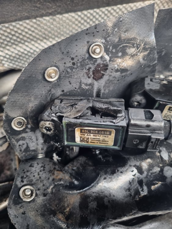

Hi I have a 2017 Superb Diesel LK and I had a cam belt change at a dealer about a month ago.
2 weeks later I get a engine light on the dash and after using OBD11 it pointed me to the DPF particle filter pressure sensor.
Semi melted mess as you can see in the picture.
If I changed this sensor do I need to do anything else? I can't see a setting in OBD11>Engine>Basic Settings>Adaptation of diff pressure sensor particulate.....
Others have seen this but after some research I conclude one of the following is true
1. My car is 2017 and therefore the above doesn't apply
2. I need to fit the new sensor first then perhaps the item shows up on the app
TIA. I don't really want to take it to a dealer as its a simple part to change but will if I have to.
Doesn't OBDII only have a fraction of the capabilities of VCDS?
Yeah maybe but I've seen posts showing OBD11 with this feature but when I look on my OBD11 connected to my car the feature is missing.
Others report similar but no one seems to know why, so I am none the wiser.
Ta.
Update:
I rang around a few dealers today to enquire about this part.
The latest revision now is D so the code now reads 03L 906 051D
£104.76 ea. but apparently it doesn't require any coding/adaptation with your vehicle.
