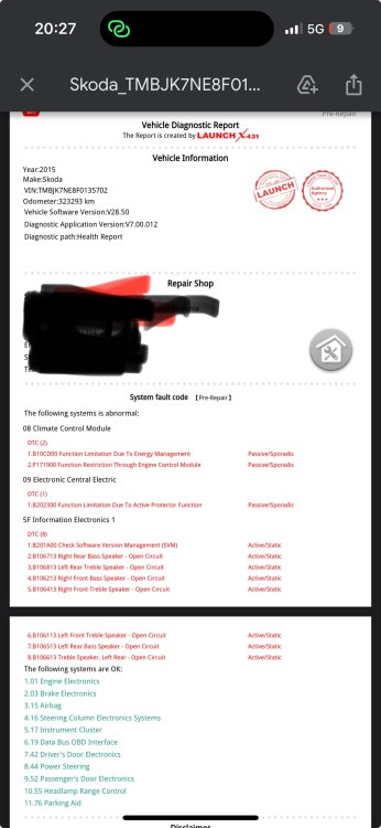

Here is scan from my Launch diagnostic i can also scan with vcds but must get it i dont have it right now if it would be better?
i think this function limitation active protector is becouse diagnostic was connected to car when driving

Well, from that report, the only thing I can see is: there is a power management problem... possibly caused by a dying battery and the MIB system has locked itself (Component Protection) and all the speakers have connectivity issues.
No issues reported with security or locking.
It was becouse i took the battery clamps down for 10minutes, the infotainment speakers have faults bcouse they are not connected they are connected to hify amplifier. What about microswitch am i thinking right? If they are showing on dashboard when i open doors they are ok right?
