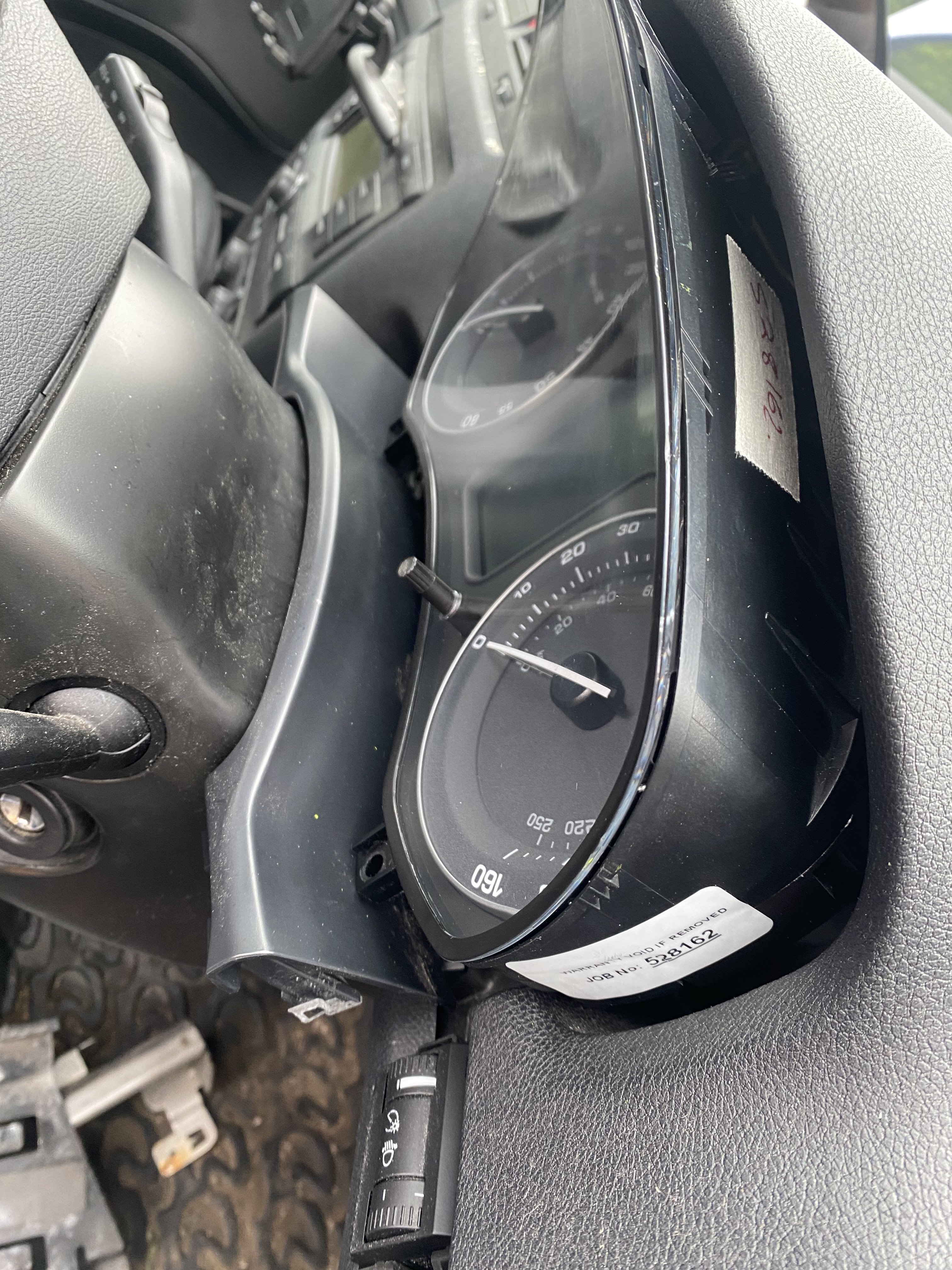

I sent the clocks off to get them checked out, clocks come back but same problem is still happening.

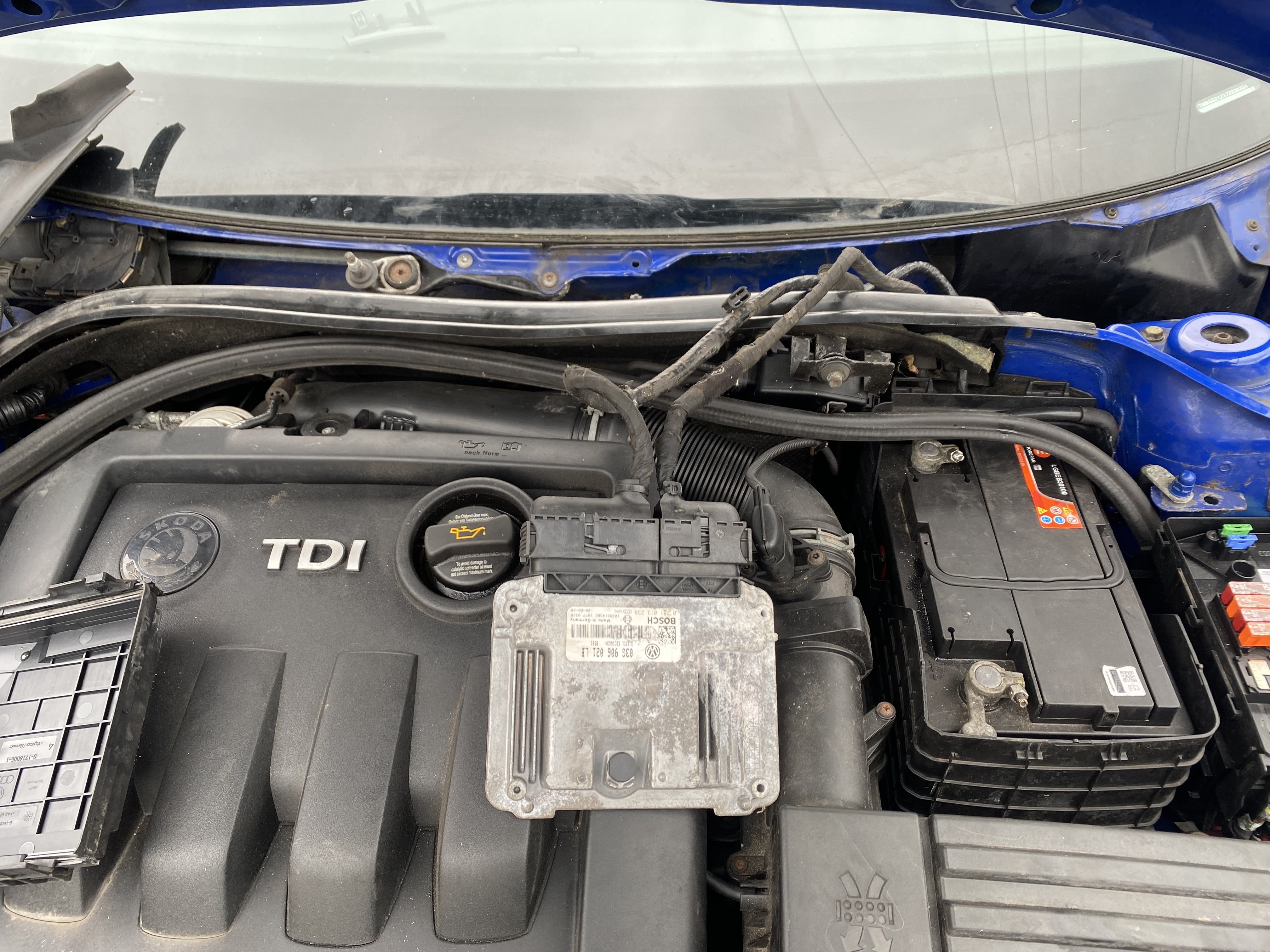

I have removed the ecu from the front scuttle for testing.
No corrosion on the ecu pins at all

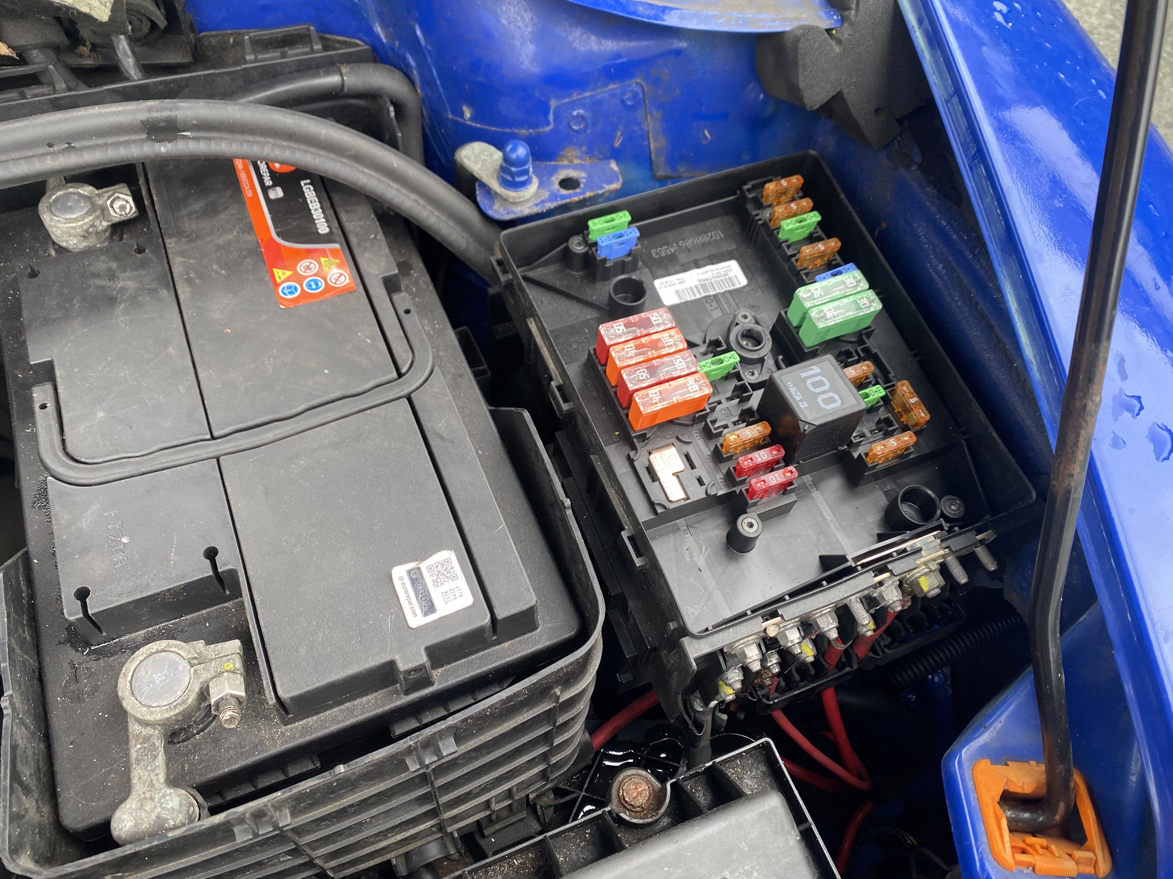

All fuses are fine.

It did have at least half dozen error codes come up , but I’ve just I’ve just gone back out to it and reattached the ecu, bloody thing started straight away and ran fine
I plugged in the diagnostic and it’s showing no codes present

Its typical when that happens. My Seat imobilser was stuck on so ended up buying a Skoda octavia to keep me going. Its a very long story!!. The Seat was sitting with battery disconected over December a few years back.  Start of Jan I thouht I try again charged baattery and perfect. No codes nothing. Started first time. Wonder if the ECU had a blip and needed to be reset, probably never know but Ive never used the spare key again and its never happened again. If you disconnected the ECU and reconnected it it may haave reset it. Hope it doesnt give you any more bother.
