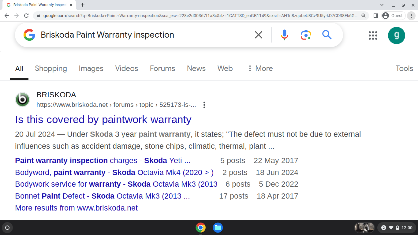

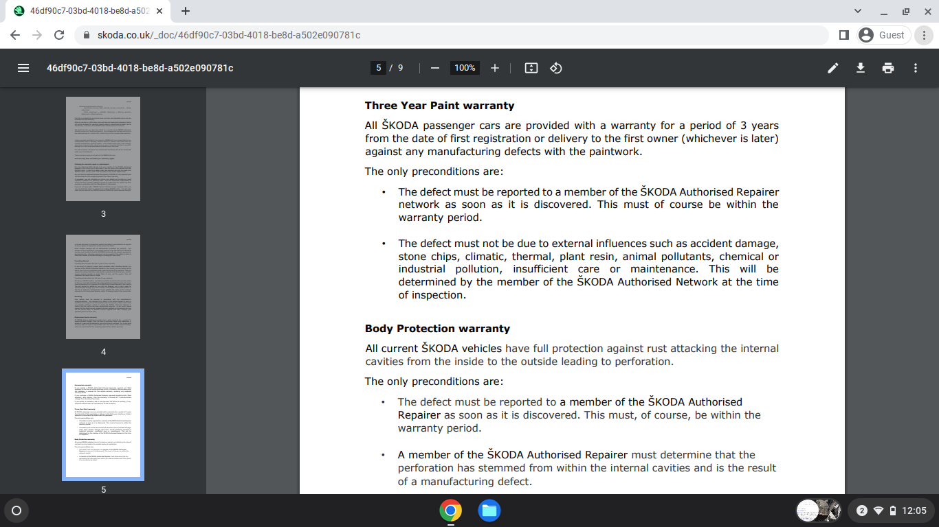

Everything to do with Skoda and the Paint Warranty.  The Dealership is only the Agent you report to and that can get the Warranty Manager to have the Inspection & Report carried out by a qualified person.
Has that Report been done?
Have you got past the Skoda Customer Services Provider to Skoda and a Communications Manager or Resolution Manager?
The T&C,s are in the warranty.  Best read it.   Report ASAP to an Authorised Repairer.

Cheers, I'll check it out thank you. I have not the report yet although I might have to but Skoda want £90 for that which is frustrating considering the defect is so obvious but I may have to do it to get the ball rolling.
With regards to Skoda Customer services I did get as far as the resolution person however they said they didn't have much leverage on the dealership as ultimately it lies with the dealership and the warranty claims manager they said.
They also said as the car is 8 years old that this is acceptable wear and tear, which I totally disagree with. It's not an area that is subject to abuse like say alloy wheels or your bonnet, this to me is a paint defect from the factory. If this area was rusting instead what is the difference?

Is the car out of the 3 years Paint Warranty?   Tough luck really if it is & not reported while in the warranty period.  In the UK anyway.
