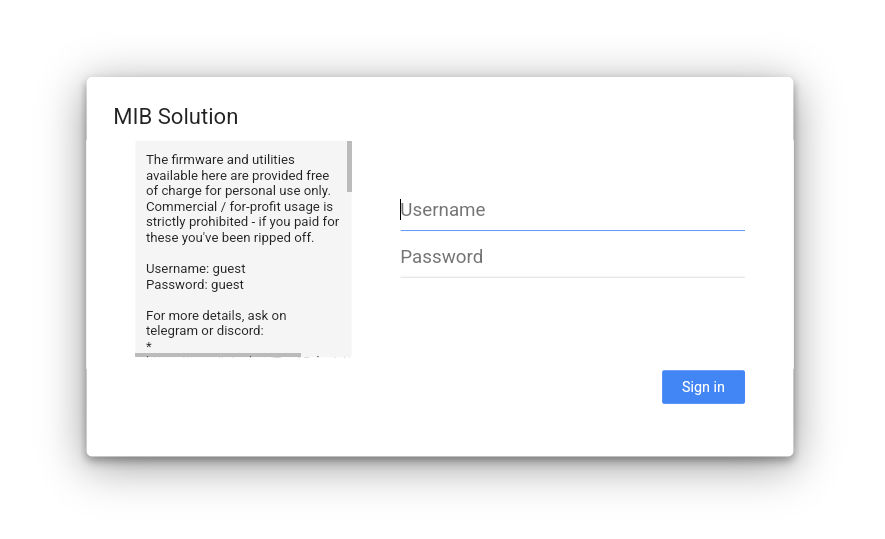

Just checked the link, it's asking me to sign in and  nowhere to register...
“Guest” is the username and password. It should be on a pop up but it might not be visible.
You may also have to click through a few folders to find what you’re looking for - there’s some sense in the making but not always!
Edited by travs
@wylee - don't use ur phone. Use a laptop/PC.
Login (details r on the login page itself - screenshot below), navigate to the folder, as I provided above, download the file, unzip it, burn it to CD, insert into ur Columbus, start the Update process.
