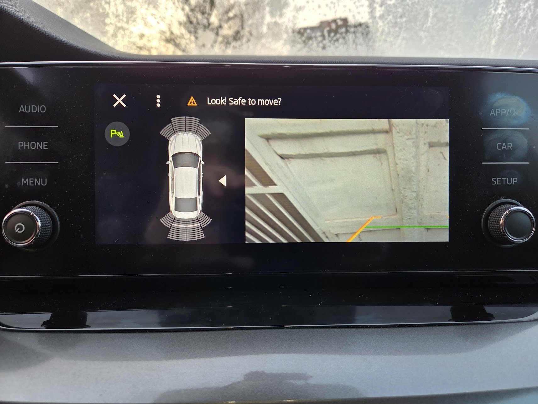

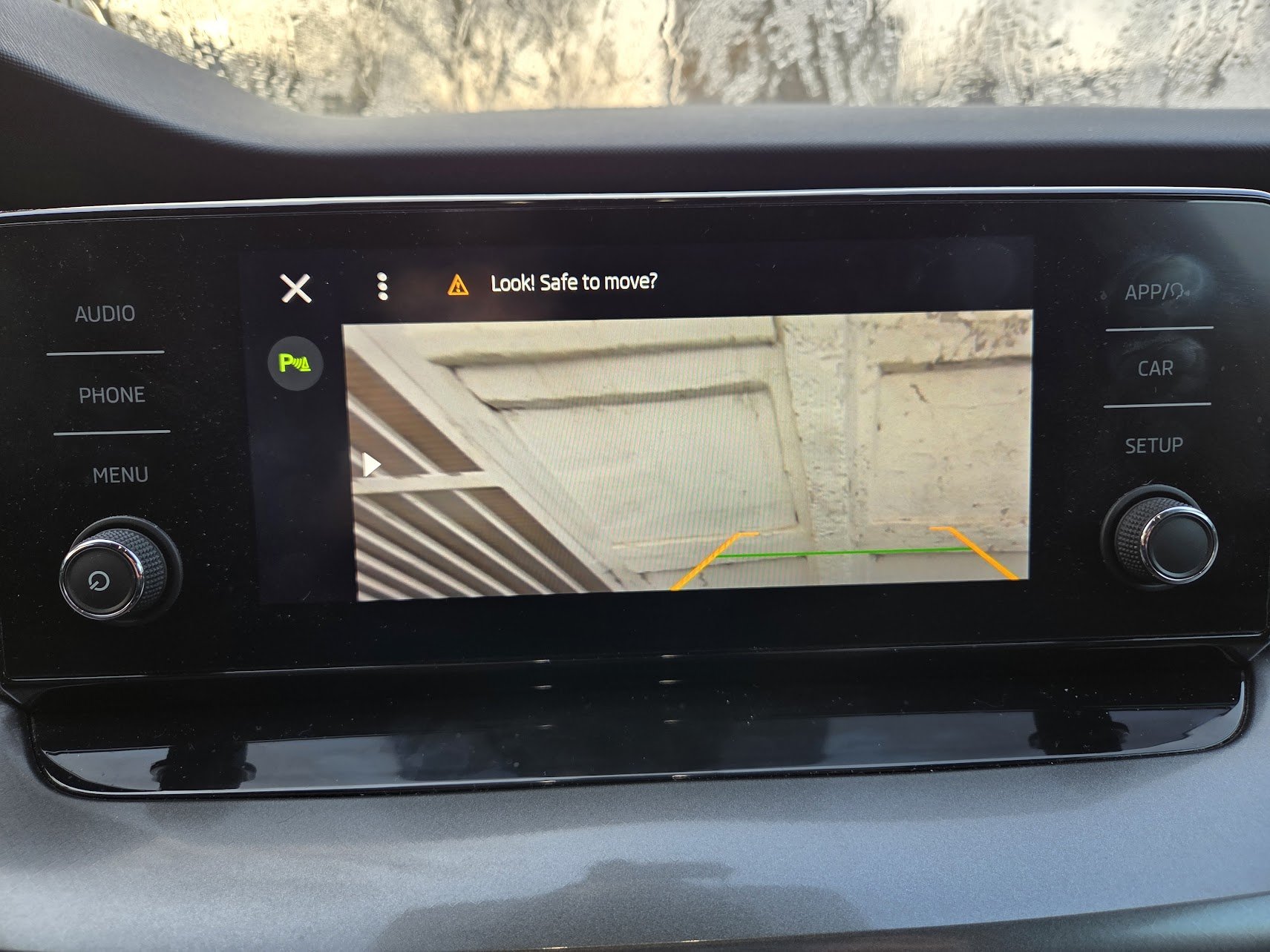

I replaced my rear view camera (5WA980556A) with one from aliexpress (because the original one got water damaged). The camera is "OEM replacement" and kinda works, but the image is off center.
I went to a car service and they did a calibration with ODIS but it didn't change anything.
I asked Skoda about it and they told me "they can try and fix it but it will cost about 300 euros and the result is not guaranteed"
I have attached two images, guide lines seem right but the image seems bigger than the screen and doesn't correctly.
Does anyone have any idea? is there such thing as resolution settings? The car is a Skoda Octavia 4 and i have an OBDeleven but i'm not very proficient with it.

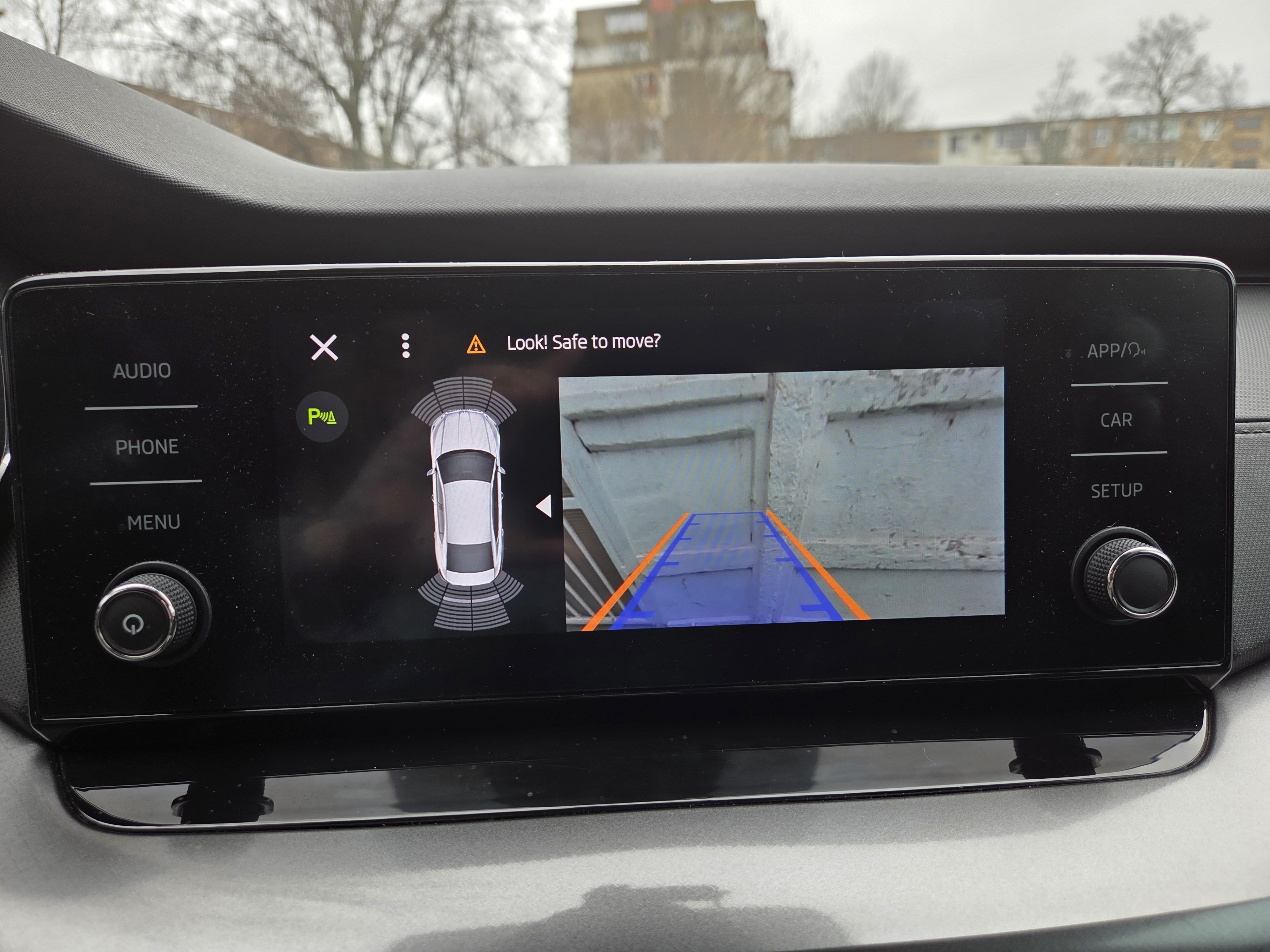

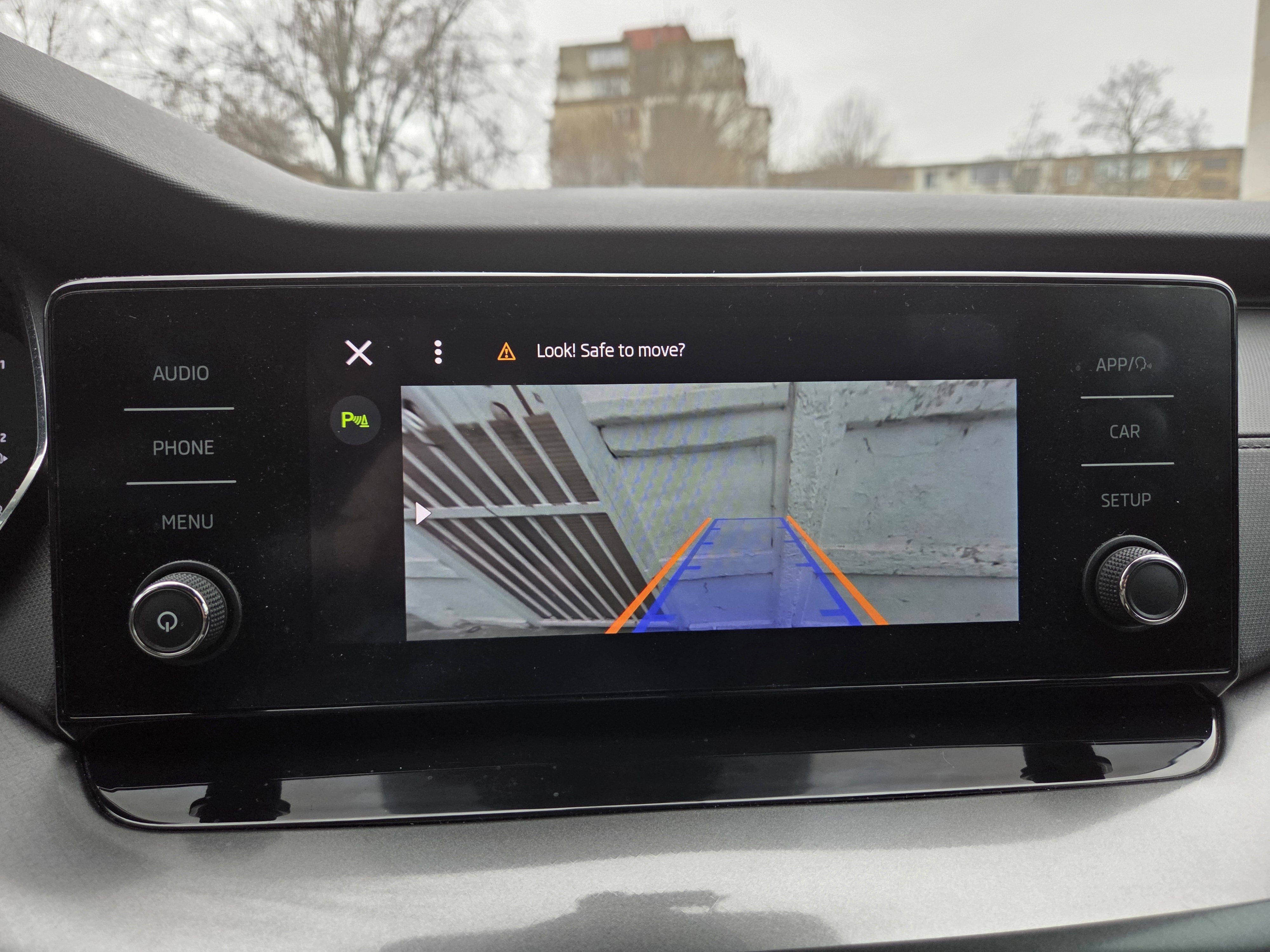

I have a quick update.

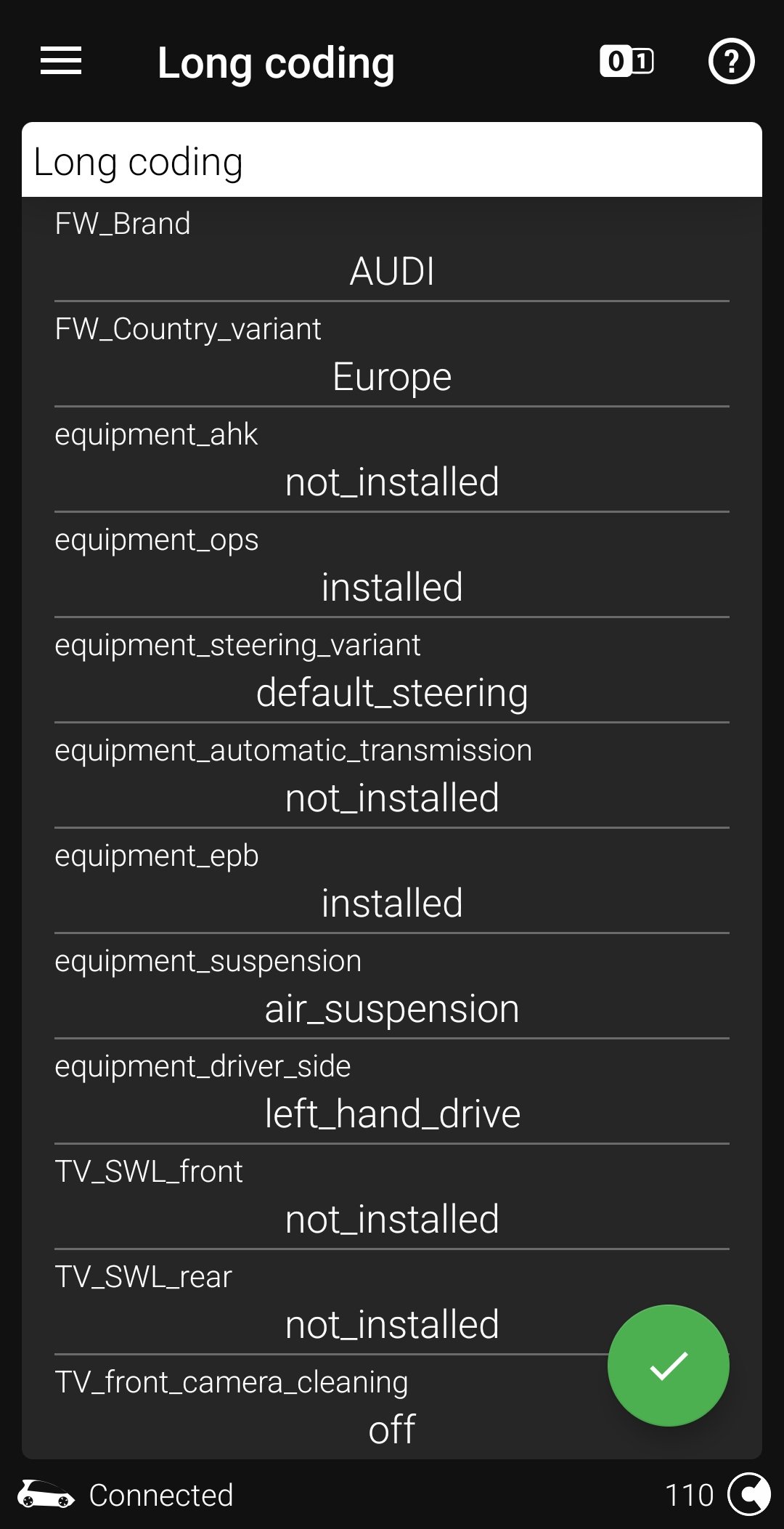

Changed the FK_Brand (in 6C) to AUDI and the image seems to be centered now. The only downside is the guidelines are from audi.
