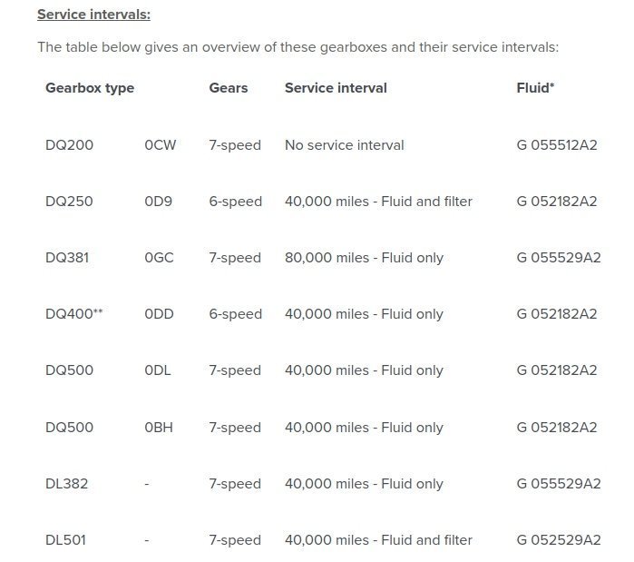

Do it right for a DQ381, not as with a DQ250.
VAQ Diffs, (Front) Mk3,s @ 3 years / 30,000 miles done properly. Some say, tracked / hard use @ 20,000 miles. MK4,s if a Dealership even bother to tell you might now say @ 20,000 miles / 2 Years.
Plenty cars not done. That can cost you. They need Serviced Properly.
Pointless really doing oil changes without filters being changed.
Or when screens then cleaned at least. Properly cleaned.
1834448921_Screenshot2021-09-26at15_11_38.jpg.9096289fe25276182dcd7ffd2631377b.jpg.372fc328a1312e2a8e37a703a5c24a3f.jpg.e5c19f7392af7e2404069076b4a3daed.jpg.3438d86c1009673b8b5ec8c310879d69.jpg
585848287_Screenshot2022-12-2814_19_08.jpg.a622554865cd35b0aa0635744f07aef0.jpg.10683be14f7ddf7785066f2b79647582.jpg.eb91574b580b0acdf9bc903e2a5e61a3.jpg.ca2ec73ea5a51a2981e706f38a534cbf.jpg
