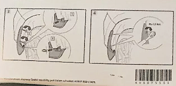

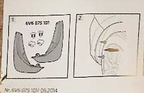

I've copied below the fitting instructions pictures provided on the advert. The quality ain't great, but the pictures do suggest that (as one might expect) the uppermost hole in the mud-flap should have a fixing screw in it.
Besides the two mud-flaps, the 6VE075101 'kit' includes two clips and two 'fixings'. It appears from the instructions that (for each mud-flap) the car's original two screws are used in the flap's uppermost and next-downwards holes, while the two extra 'fixings' in the kit are used with the clips that attach to the top of the flap's lower section.
'Genuine' Skoda mud-flaps are designed so that no extra drilling of the car's bodywork is required. Consequently, directly beneath the (empty) uppermost hole in your Fabia's rear mud-flaps, there ought to be a matching fixing screw (or a hole!!!) in the car's wheel-arch.

@DerekU Thank you so much for taking the time to look this up, I am really grateful. I will go and chat with my dealer to see if it can be put right. Thanks again.

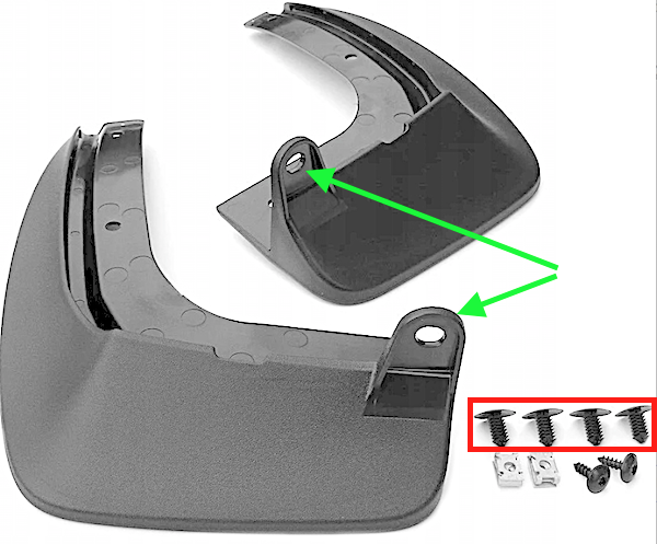

This photo shows what the Fabia Mk 4 rear mud-flaps 6VE075101 'kit' is said to consist of.
It's possible (as gumdrop mentioned earlier) that the existing wheel-arch screws may not be long enough when mud-flaps are to be fitted and that's why the kit contains the 4 extra screws I've marked. The two clips & screws are also shown and I believe these go on the flaps' 'extensions' (green arrowed) and attach the flap to the wheel-arch liner.
It's regularly stated that fitting the mud-flaps is a 15-minutes task, so (presumably) the installation instructions are adequate... 😉
