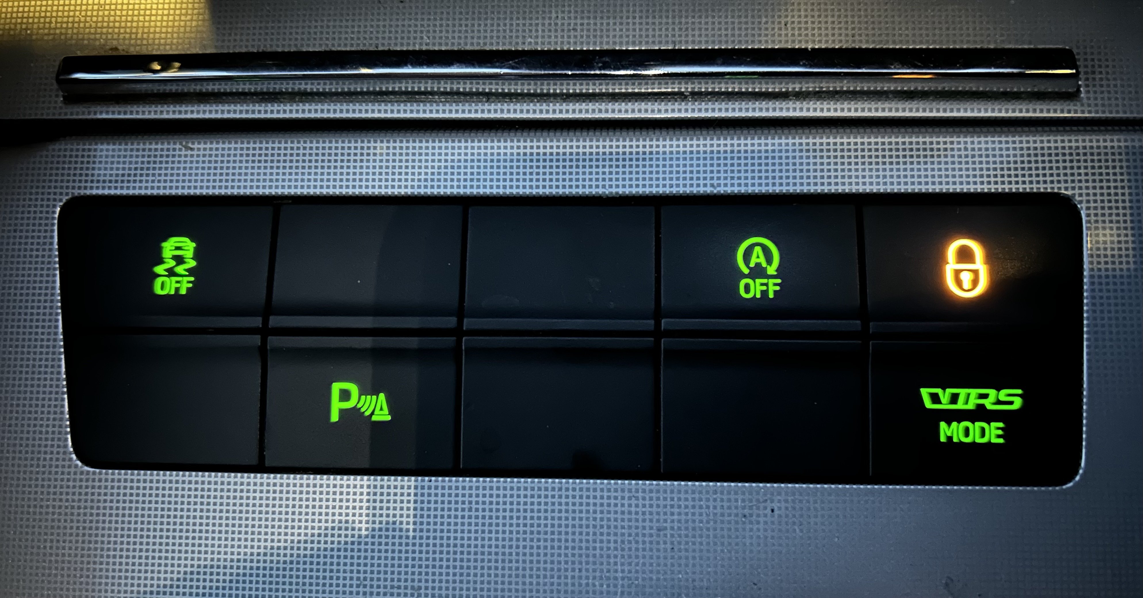

I have today been playing with my car and attempting to wire in the required wires for these two additional buttons, honestly I don’t need the extra buttons but doing a number of other small upgrades / retrofits and I don’t like so many button blanks…. So we’ll Why not?
The Mode, Auto and central locking buttons all work as they should (had these already)

ESC / ASR button

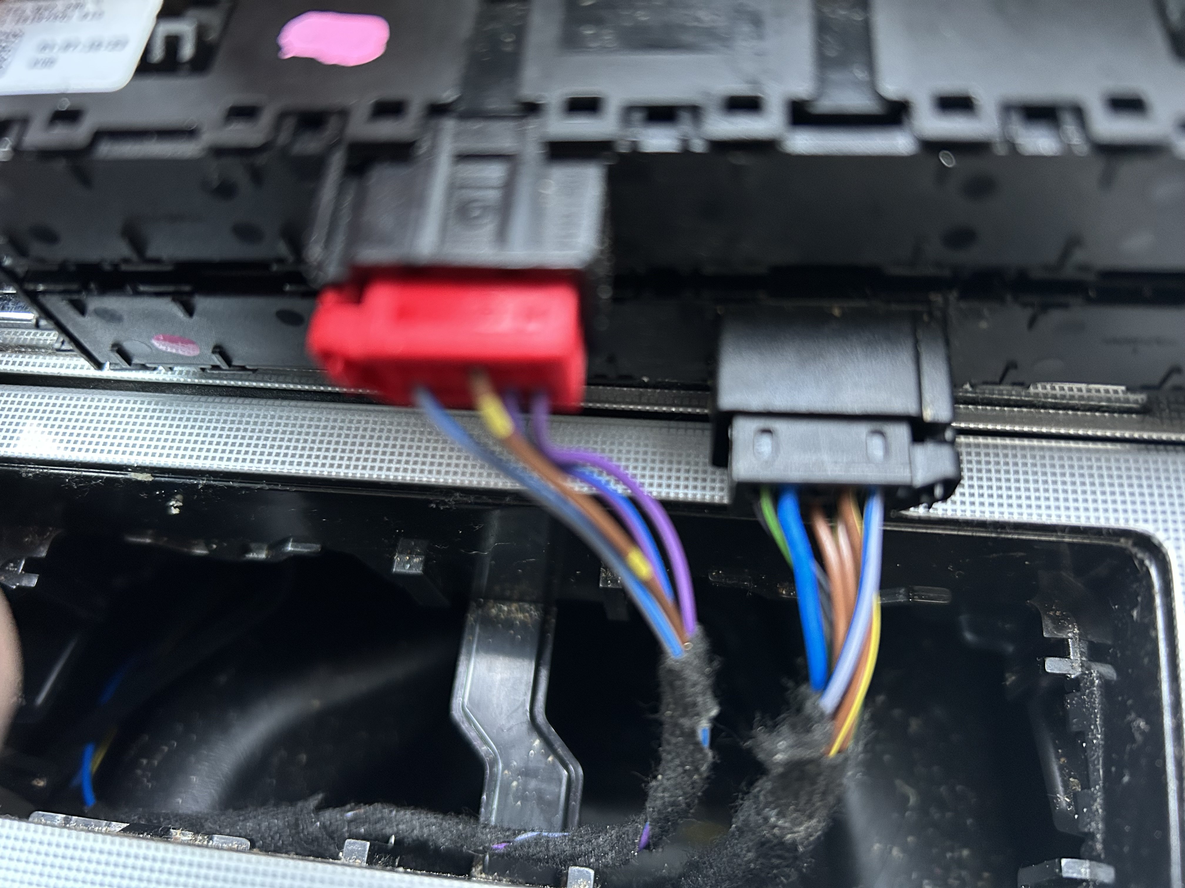

From reading elsewhere the only similar guide I could find for this was for a Golf M7, on the face of it the seems very similar or the same, however after adding the missing link wire, the button is still not working.
So far I have established there is a wire from the ABS unit to the TIUL Coupling Connector T17d, I have run a wire from pin 5 on Connector T17d to the Black Switch Block connector (T10ks ??) Pin 9, The guide states also adding another wire to pin 10 with a 12v supply, but my connector already has a wire in that pin. I am guessing here that there is a difference between the Golf and Octavia from this side, so looking for advice on the pin out for the button blocks.

ParkPilot Button
I haven’t attempted to do this one yet, but my research so far implies I need to run two wires, from the red button block connector Pin 3 to T26 pin 16, and Pin 6 to T26 pin 17 of the OPS Module, again I am not 100% confident on this as I am struggling to find a reliable guide/information.
