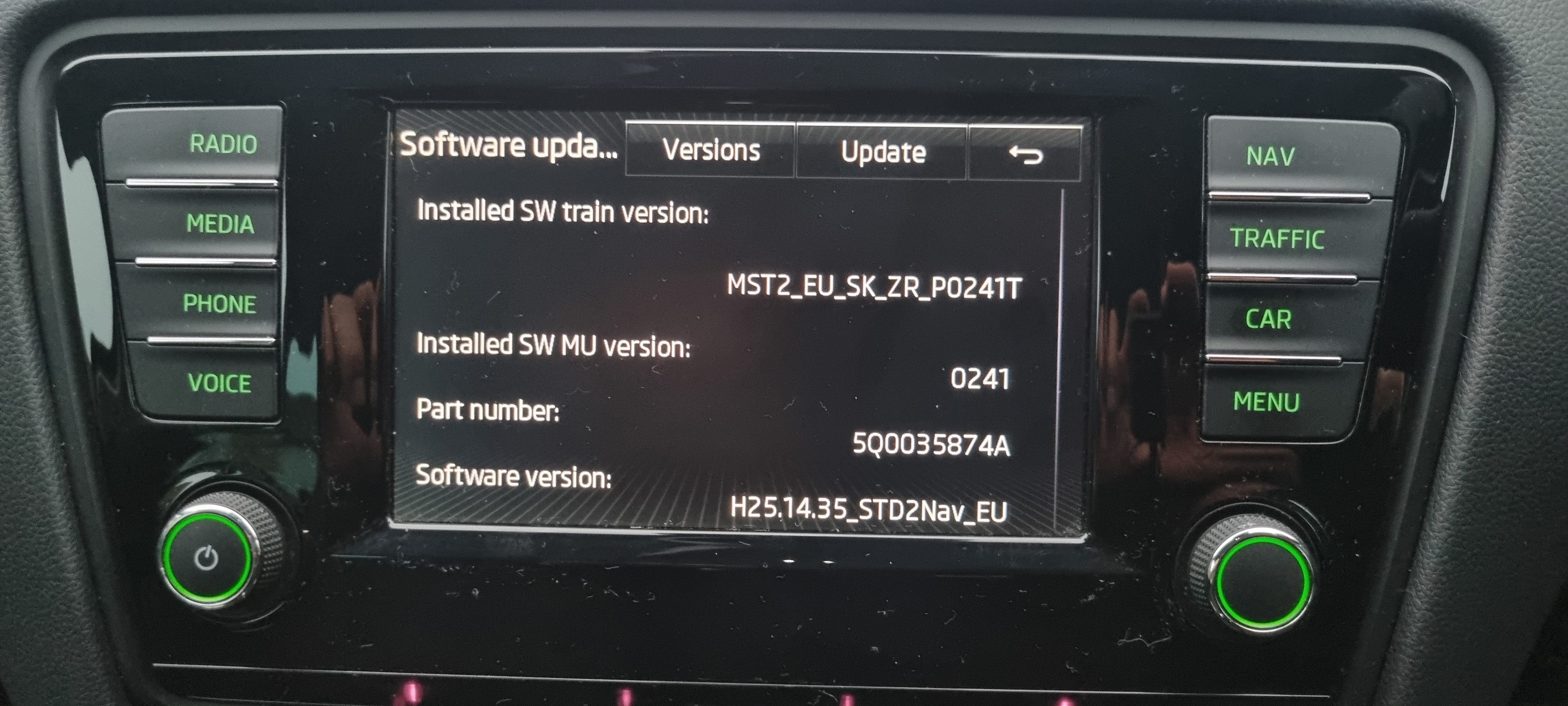

You need to tell us what MIB version you have. Boot up the MIB / Infotainment system, press and HOLD MENU and then go to software versions. Take a photograph and post it on here.

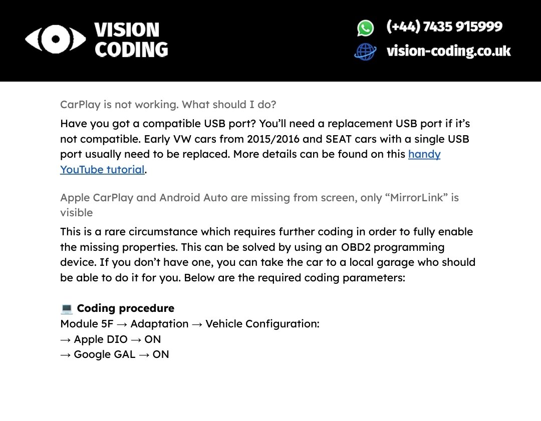

I've uploaded the sd file to install in but I'm missing android and apple on the option screen. Company that sent activation file sent this

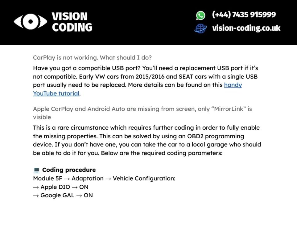

Your issue is that you need to enable the 2 settings as instructed at the end of your Vision Coding post. You will need someone with VCDS/0BD11 to enable the 2 settings and then you should be sorted. Here's a link to a Youtube video which explains the procedure:
