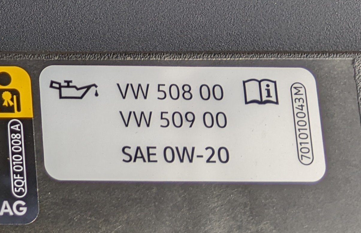

Have you looked at the oil specification label? (It's stuck to the front when you lift the hood.) I think this engine uses 0w20 VW508 00 / 509 00.

The Factory Fill oil in 2018 was certainly VW508 00 / 509 00. So that is the recommended, advised, oil they guide you to use.
But as shown from the owners manual VW504 00 / 507 00 can be used.
Just not by Skoda / VW Group incase a car was subjected to a WLTP test as it was imported into a country.
There was a reason they went 0w 20 FS IV pre WLTP Certification was started.
