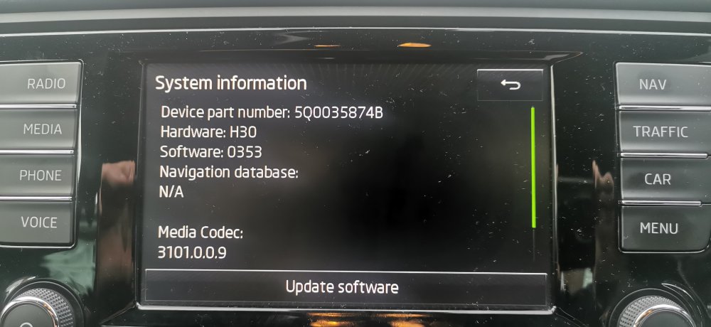

Hi all. Just bought a Octavia VRS 2016. It has the nav media system and the SD card is missing. How do I identify the correct SD card to get? I have tried to download the maps from the Skoda website but it still comes up with the no navigation media detected. I have attached a picture of the head unit version but the manual which came with the car has all the media head units in it so no real help.Uploading Attachment...
This is the picture, it would not upload with the original post.
There are lots of fake Skoda Nav cards on ebay and the such. Try getting a genuine 8G or 16G card for your system, downloading the latest maps by putting in your VIN into the Skoda maps portal and trying again.
