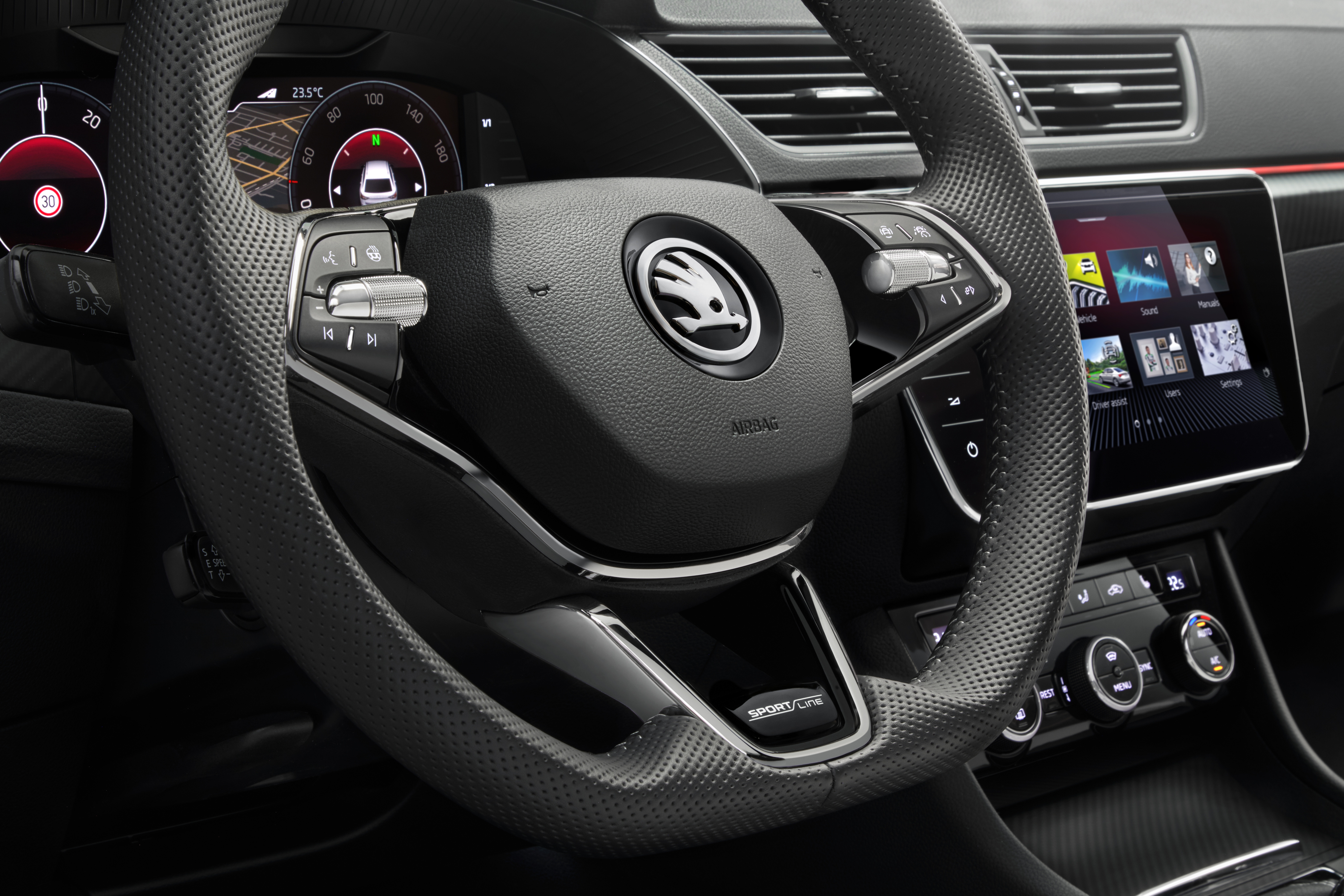

I've been trying to retrofit a facelift heated steering wheel to my 2015 MKIII (see attachment); it's RHD. I have the upgraded squib etc. Installation went okay, but when I put the car in park, a message popped up saying "Move selector to P position and visit workshop", even though it was in park and the dash was showing "P" position. All the parts are correct and compatible, and the 16 to 14-pin adapter I'm using is Kufatec 43696-1 (https://kufatec.com/en/heated-steering-wheel-cable-set-for-vw-skoda/43696-1). The message means I can't lock my car.
The issue went away completely when I reinstalled the old steering wheel. My thinking is that it's the adapter; I had tried one from AliExpress before and it gave the same message, so I put it down to the quality and ordered Kufatec. The pinout is what it should be (I've confirmed it's the same as in this guide: https://www.briskoda.net/forums/topic/515572-how-to-retrofit-a-heated-steering-wheel-to-a-mk3-octavia/

I don't know. Is that steering wheel ok for a 2015 car? I've been trying to find the answer for my 2019 car.

Yes, it's been done before: https://www.drive2.ru/l/658001635204673399/

One year later, I finally have an update! Got busy with life so didn't reinstall the SW until now. The issue was extremely simple; I took screenshots of the current coding of the steering wheel under Address 16 with the old steering wheel, and just ensured that after the new wheel was installed I entered exactly the same coding. Went for a short drive after installation and the issue disappeared! Hopefully this can help someone who's being as dense as I was. Big thanks to @zacko_O for all of his help!
