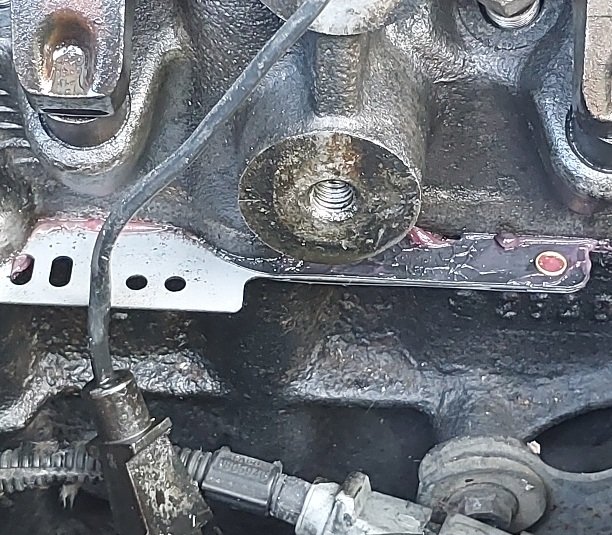

I havethe Fabia in Dominican Republic, you can not leave the car alone for a second because then the super genious mechanic do something.... creative...
Background: car had some bent valves and i had to do the cylinder head.
When installing back, i found that the mechanic used grease in the new head gasket.
Why? (If i asked him je will twll me that have beend doing that for years and that that is how must be done bla bla bla....)
Now, what can i expect? How long will it last?

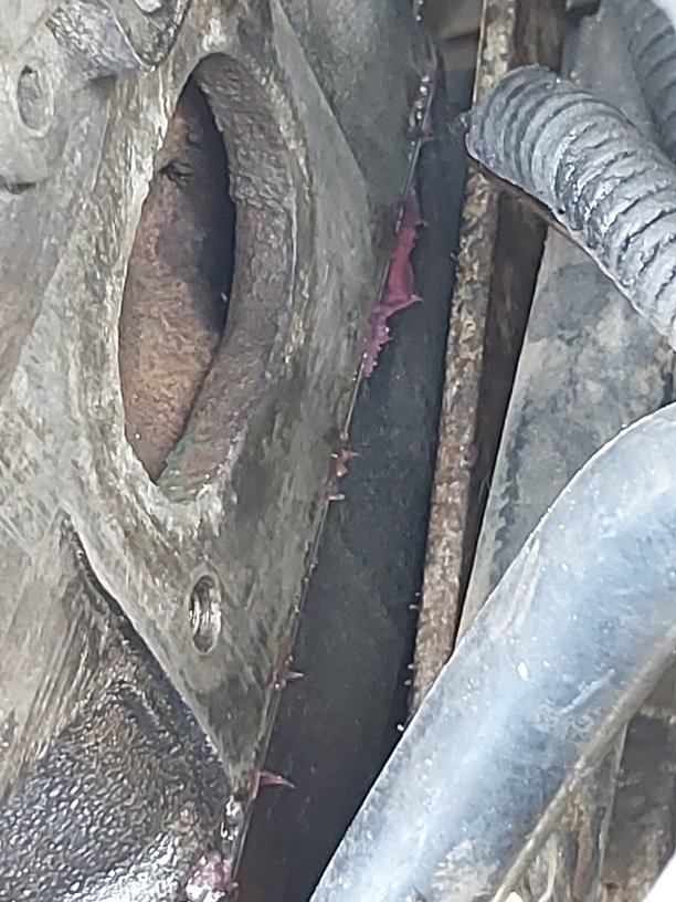

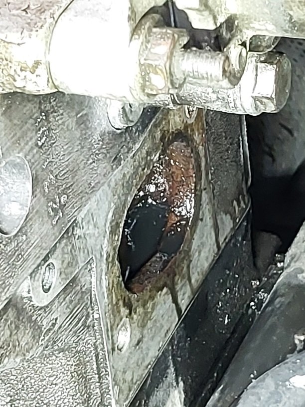

The engine has already been assembled, but when the mechanic tried to start the engine, it started quickly but expelled a lot of oil through the coolant outlet, on the side below the vacuum pump, it spurted a lot as if it were an oil line.
Doesnt look good. Hopefully just waste oil in coolant passages but could be cracked head/block,head gasket perhaps wrong one? I wouldn't have thought some grease would cause the problem so soon unless its affected the heas bolts torque.

No, it is not waste oil.
The flow of oil when we start the engine waa like if was an live line, lot of oil comming out of there.

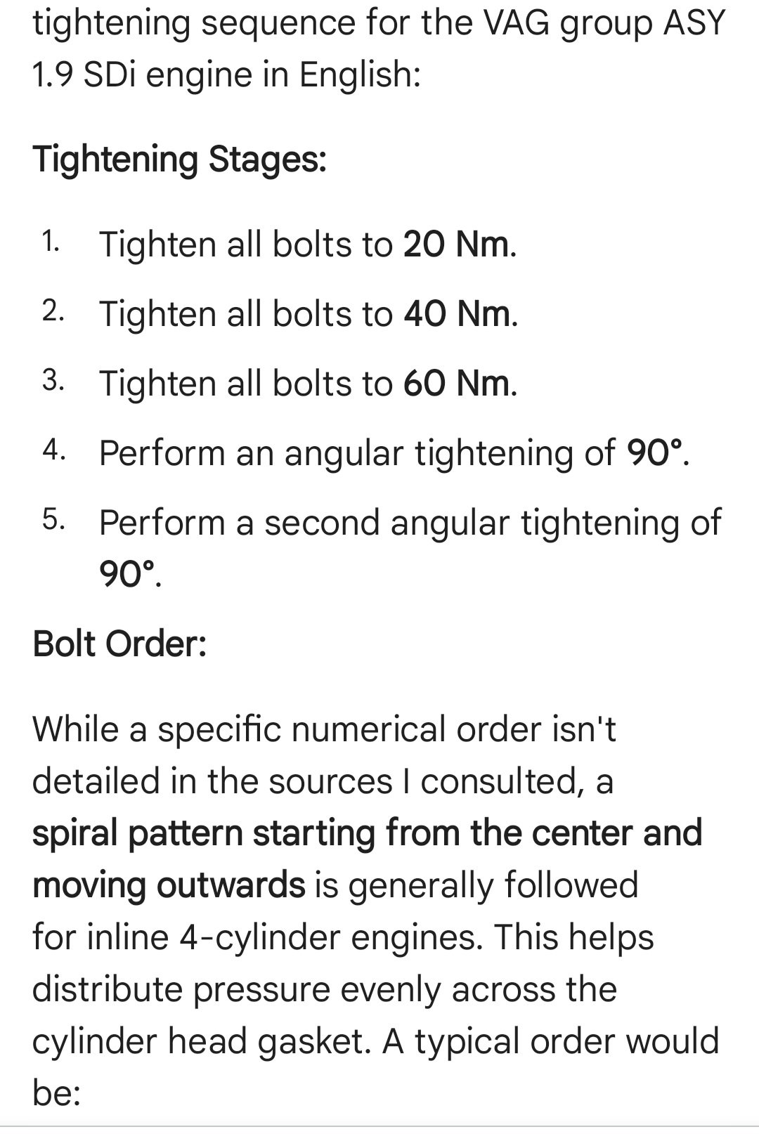

Is his tightening torque and order correct for my ASY engine correct? Screenshot_20250501_094842_Google.jpgScreenshot_20250501_094904_Google.jpg

The mechanick inatalled the head gasket wrong, upside down, and one of the oil holes was blocked, thats why the oil was diverted some how came from the water side.
We installed correctly but the mechanic didnt follow the right sequence for tightening the head bolts.

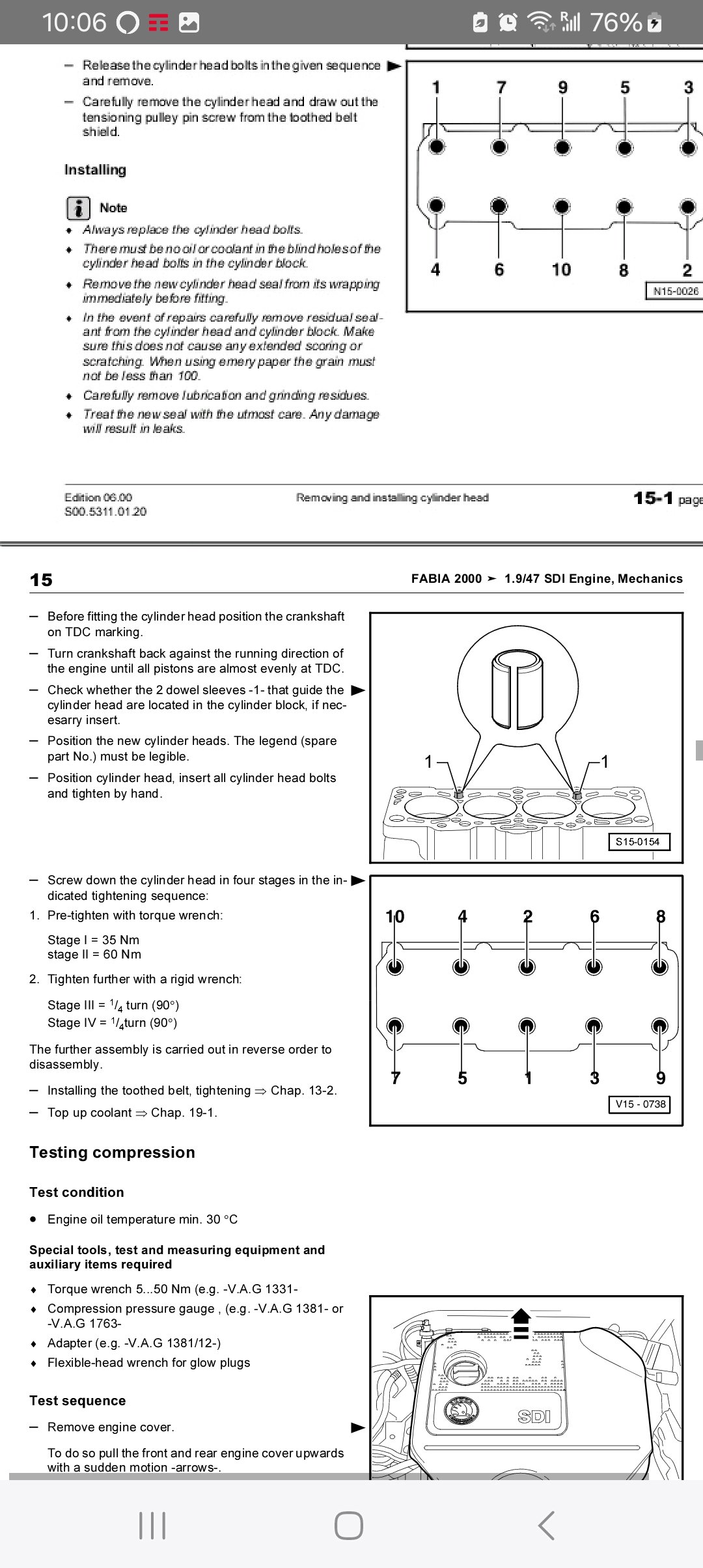

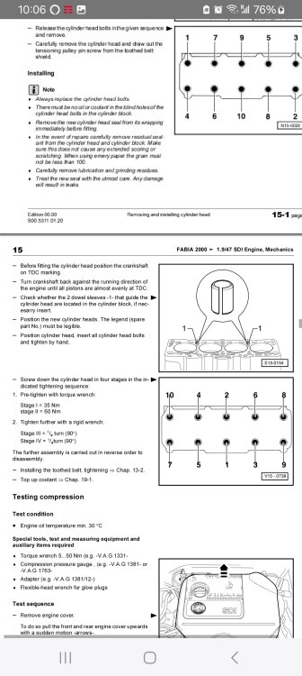

If that is for your engine it makes sense. They normally get tightened from centre outwards in stages. If loosening then in the reverse order. Make sure he cleans out the thread holes in the block completely. All it takes is some coolant or oil and you can crack the block when tightening.(end of engine). Also clean bolts of grease/oil as this will increase torque. If I remember you should always use new bolts as they are stretch bolts especially if they have already been torqued twice now. I gave away my fabia MK1 workshop manual as I don't have the car so can't check for you ut someone on here will be able to confirm that the above is correct or not.

@Kharl I don't have a Fabia manual either, but what @Alasdair1 says above is basic sound mechanics for any engine.
