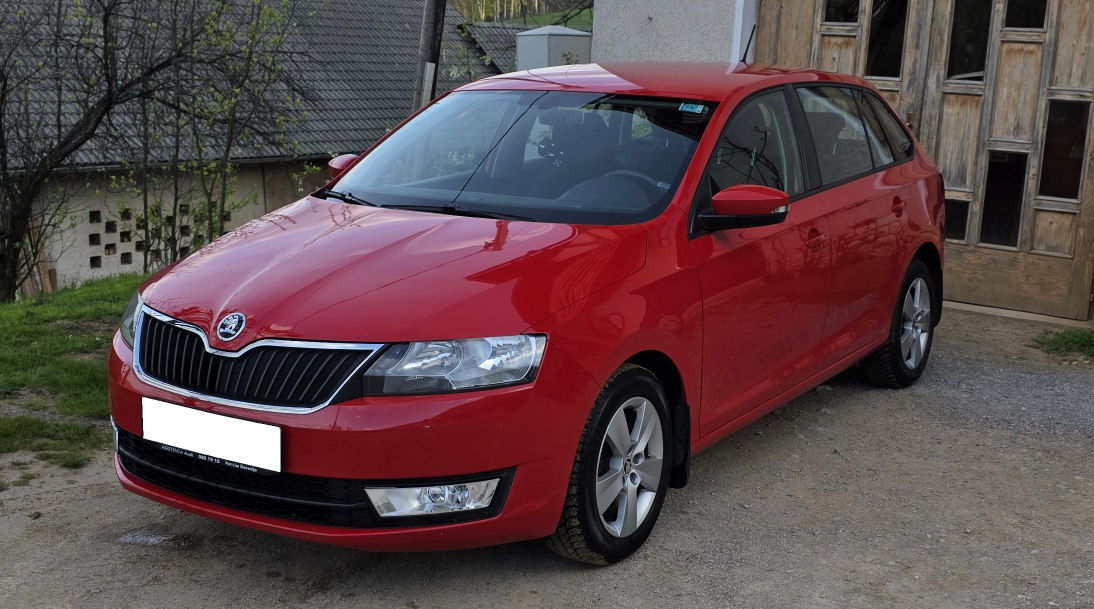

Two years ago I became the owner of this Skoda Rapid Spaceback.

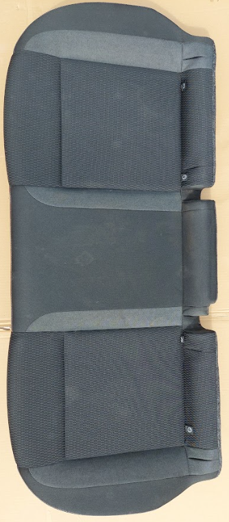

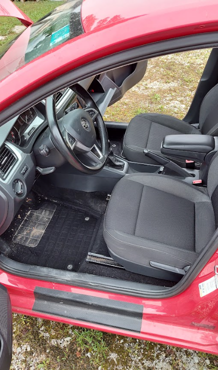

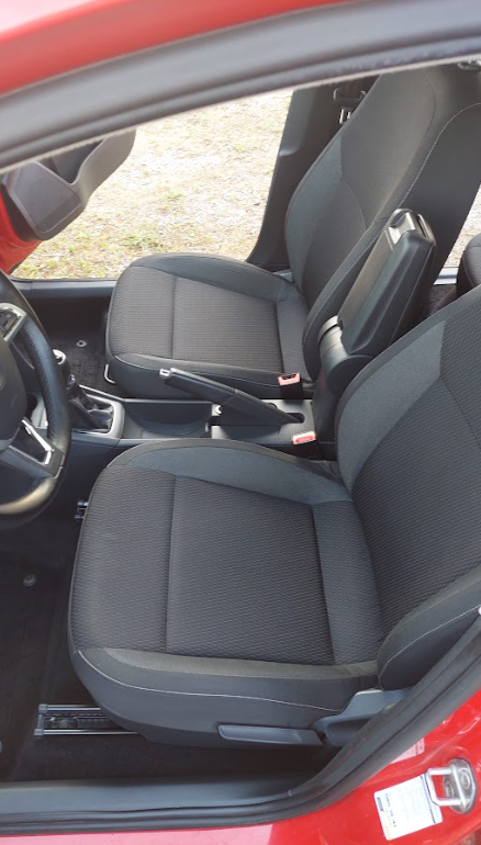

When I got the car the first thing that my friend and I did, we bought the equipment for car detailing to clean our cars and potentioally start a buissness in car detailing. Here are some pictures before cleaning and after.

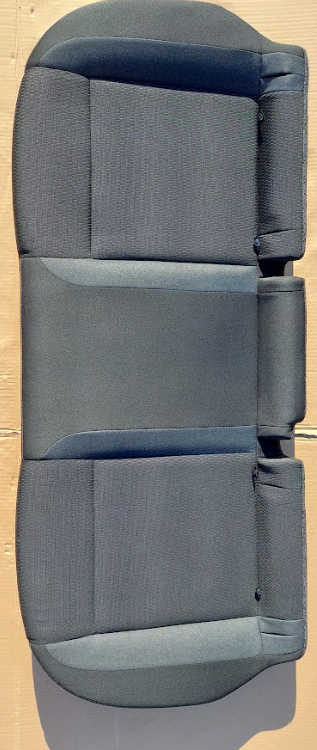

Car looked like brand new especialy seats, there were no more spots of stains.

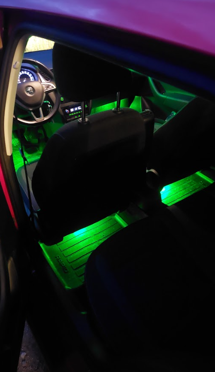

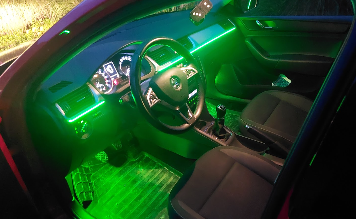

At first i didn't think I would do any mods to the car, until one day my friend and I started to look at the ambient lighting kit for car. Soon we bought one and fitted in his VW Passat B6 Variant. This was the moment wen it all begins. We bought another one and fitted in my Rapid.

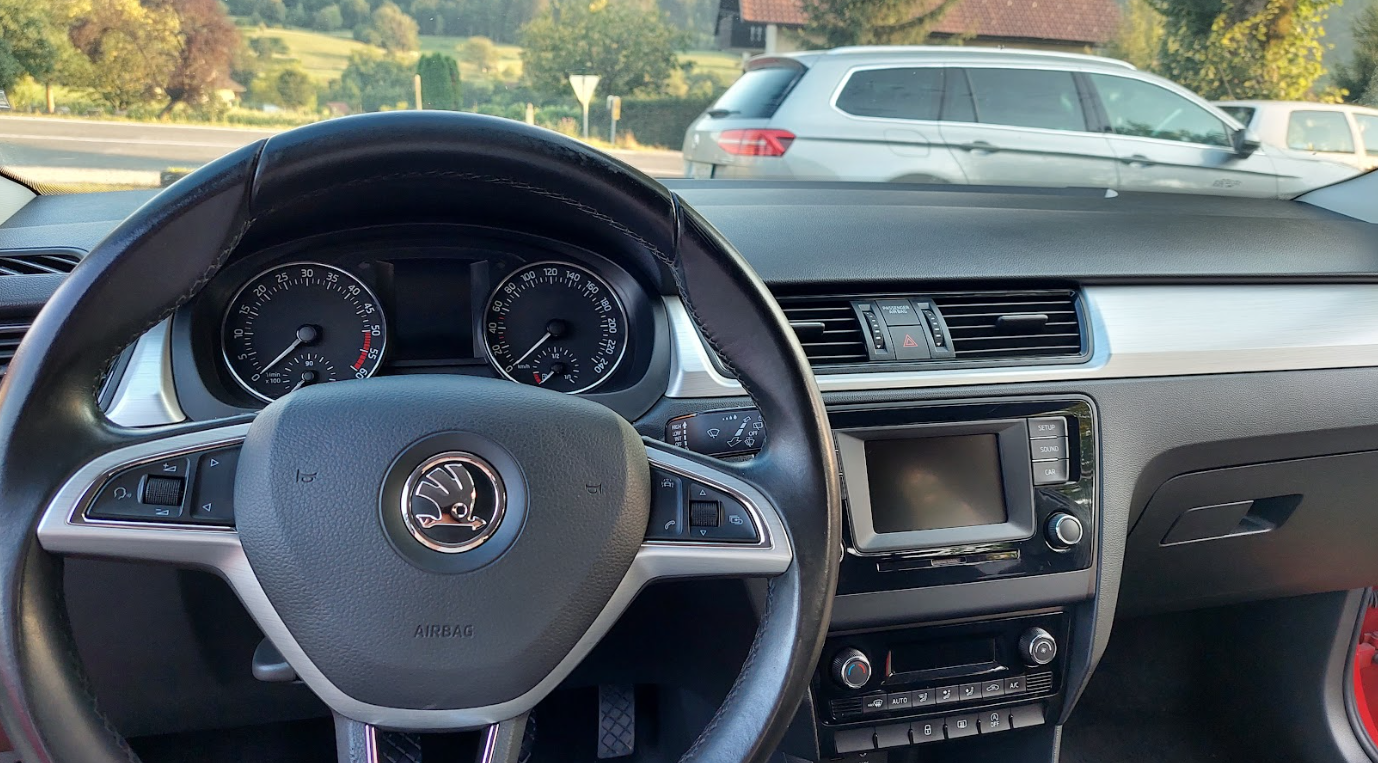

We instaled symphony kit that is controled with app. For now only dash and foot lights are installed in the future, lights will also be in door cards, in handle and storage bin on doors but for that part i have some other planes which I will explain in detail later.
For how lights are installed. In the dash there was just enough space to put the strips in and cut to the right lenght. Foot lights in front are installed on plastic trim and under the seats on metal frame which is placed so that you can't accidentaly knock it off.

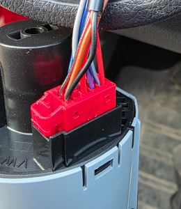

Power for the main unit is sourced form the light switch.
Black wire is put in pin 6 and red on pin 10. Now unit for ambient lights gets power whene you put light switch in DRL position(first turn of switch). Some get power from 12V socket in center console but in Rapid case this is not ok because it has permanent power, that means even when the car is not running 12V socket still has power. Second option could be to get power from infotainment unit so that whene you use infotainment system lights are on, I didn't want to mess with that as i was still learning about those things and didn't want to go that way. Recently i got an idea to get power from the fuse box on pin which was ment for OEM footwell lights. This is the option that i would probably do it now if I was doing it again. Maybe I would still do it later but for that you need to check if your fuse box has pin ready for this, if not I saw someone do the pins for the glovebox for some other project(he occupied one of the pins with something and later fit the thing that was supposed to go there and relocated the part to separete pin just for that).

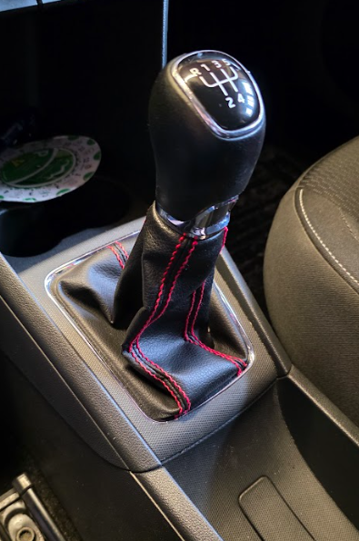

Shifter was the part to go and it tooks great the perfect touch would be VRS logo like in VRS cars but there wasn't five speed manual from MK3 Octavia or MK1 Kodiaq.
