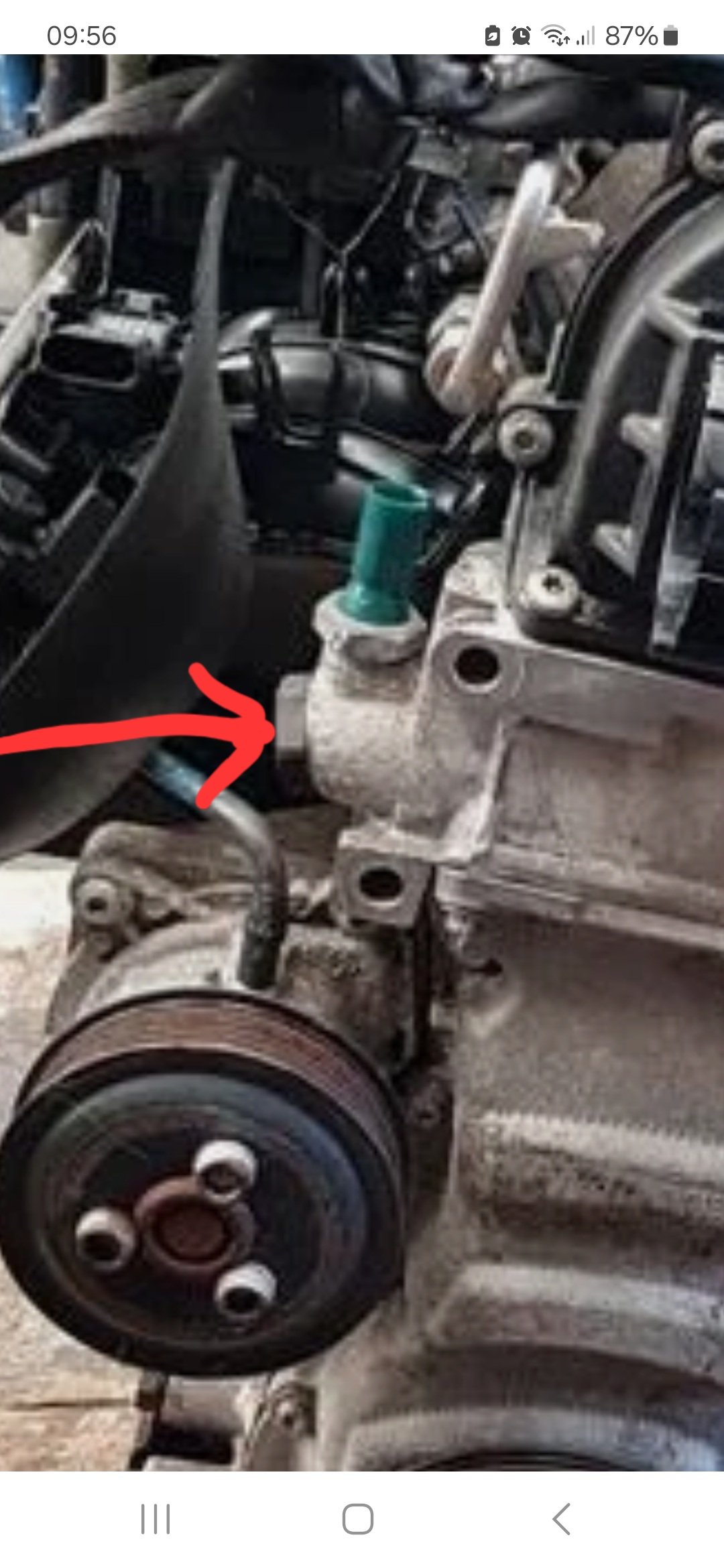

Look over the top of the engine to find the green oil pressure switch.
Tensioner is just below it, red arrow points at the 27mm hexagonal back end of it.
Unscrew, remove rearward, put new one in, tighten to 60Nm.

I think I found it :)
This is it right?
Do I have to take any precautions, or make any preparations before unscrewing the old tensioner?
Or should I just unscrew it, from a cold engine, and put the new one in?
  • Sponsor
Yes, that's it,and that's what I did.
