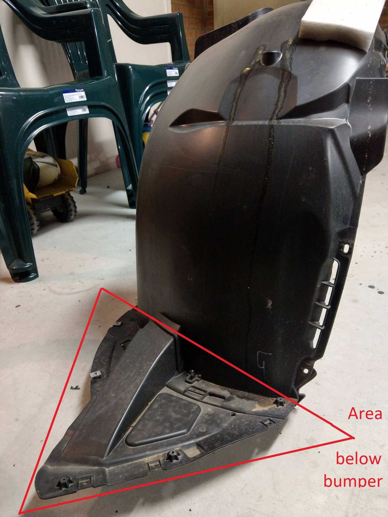

i don't have a picture of how it looks, but u can see on the pic below of the wheel arch liner, showing the 2x holes up front which lines up with the front bumper.
