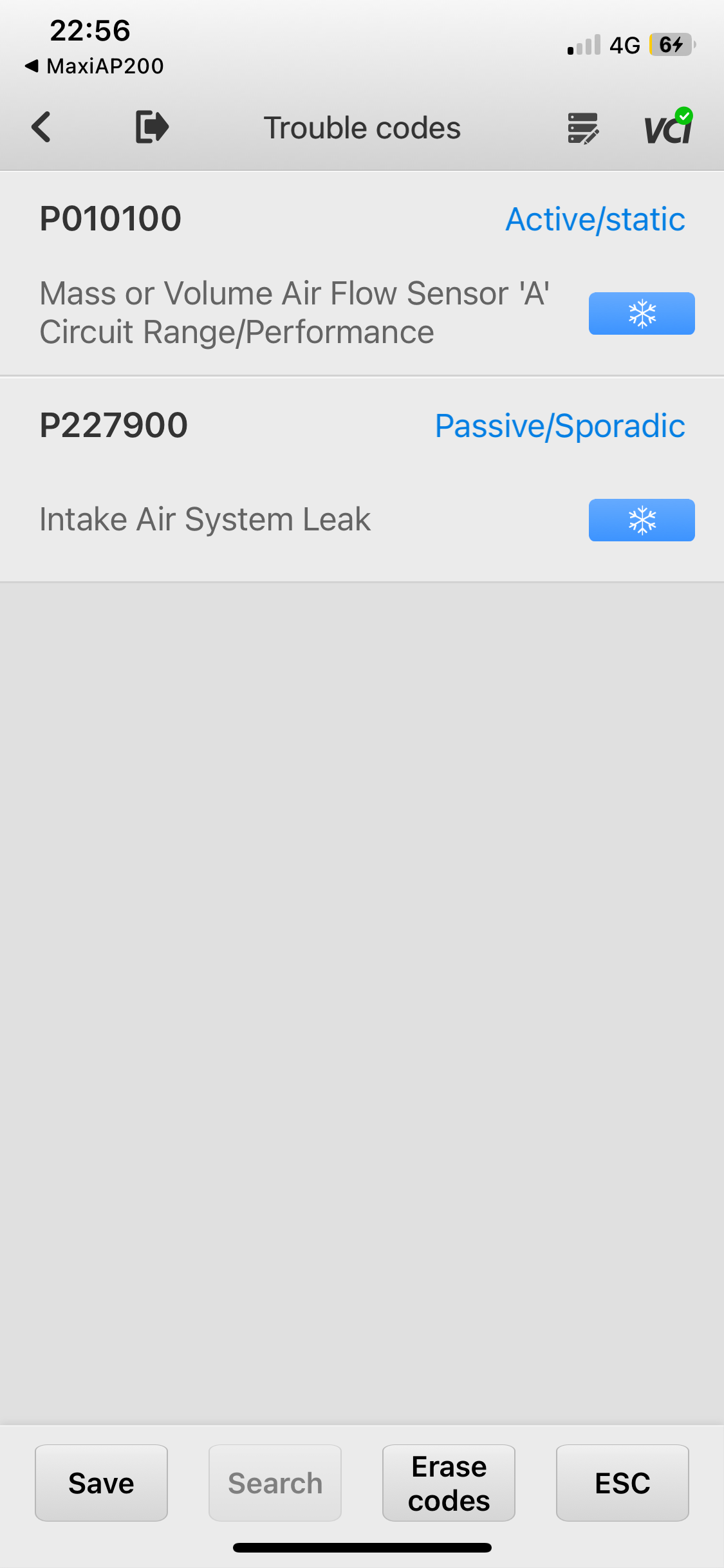

Currently has a cheap ebay Maf installed and the P010 fault might appear every 500-1000miles
Replacement with a Oem maf triggers The P010 fault immediately after installing within a few miles
the p2279 has only triggered once during this replacement install
