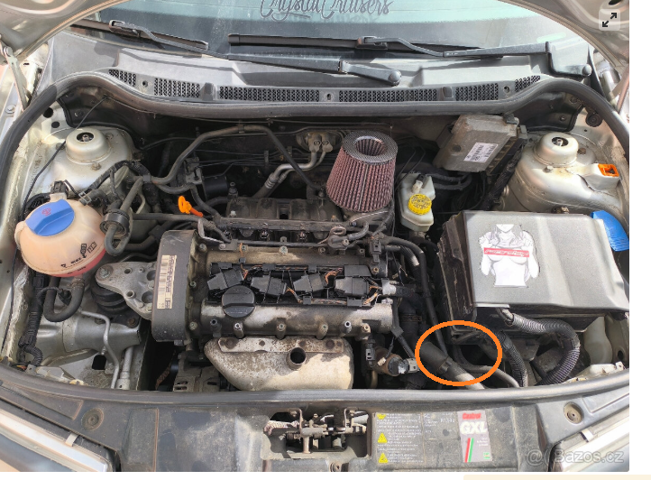

This is usually a broken starter solenoid wire. They break just outside the cable entry point of the connector.
Smallest wire going to starter motor.
More visible on some engine types than others. Which do you have?

OK, a 1.4 16V petrol.
Yours probably has a combined engine cover/air filter rather than the silly cone filter in this image, and it may be easier to see where you need to if you remove that engine cover, but that may not be necessary.
Look vertically downward, preferably with a torch, in the area where the orange ring is, trying to see something similar to the image I posted above, possibly with a wire floating around loose.
