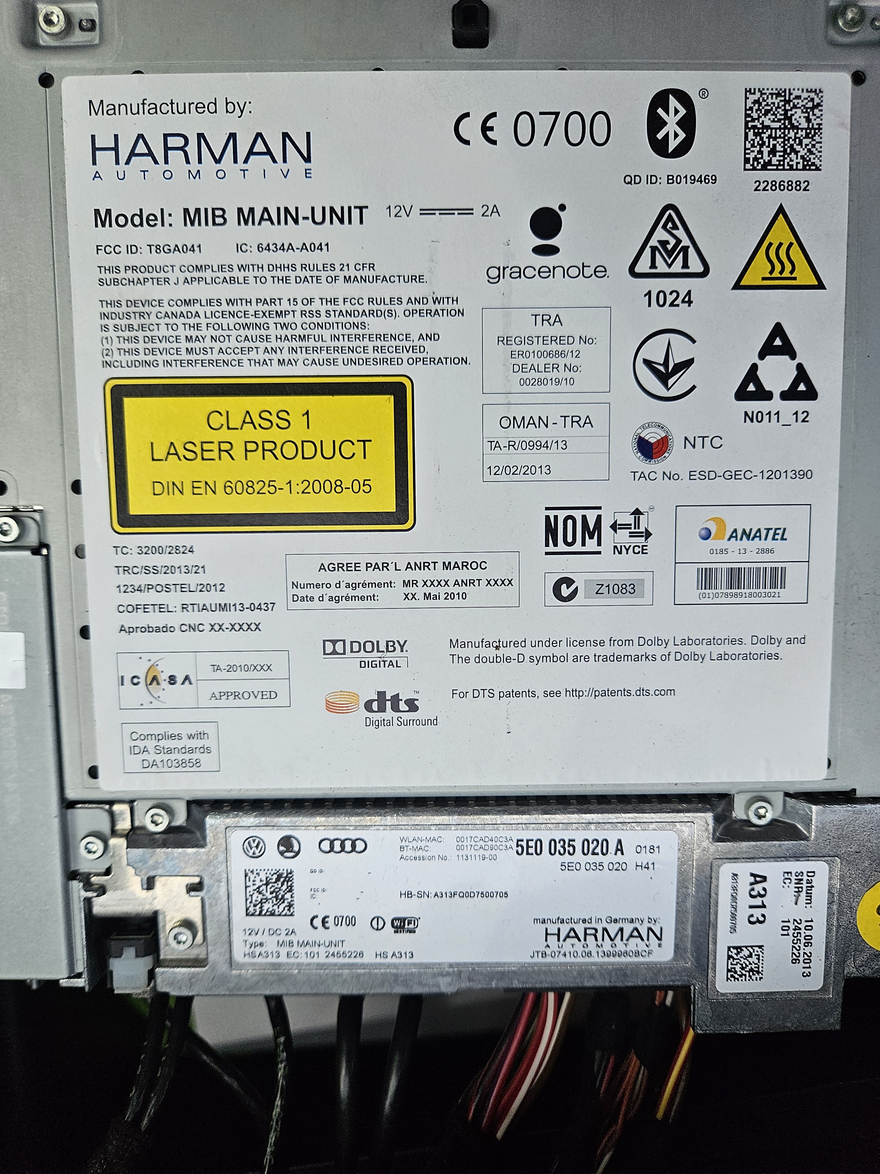

Hi, im quite new too this but I had my car at a skoda dealership to fix my mib not having any sound except for the parking sensors. Long story short they tried to update the firmware but failed. The conclusion was that I need a new head unit, but they werent able to get me a new one.

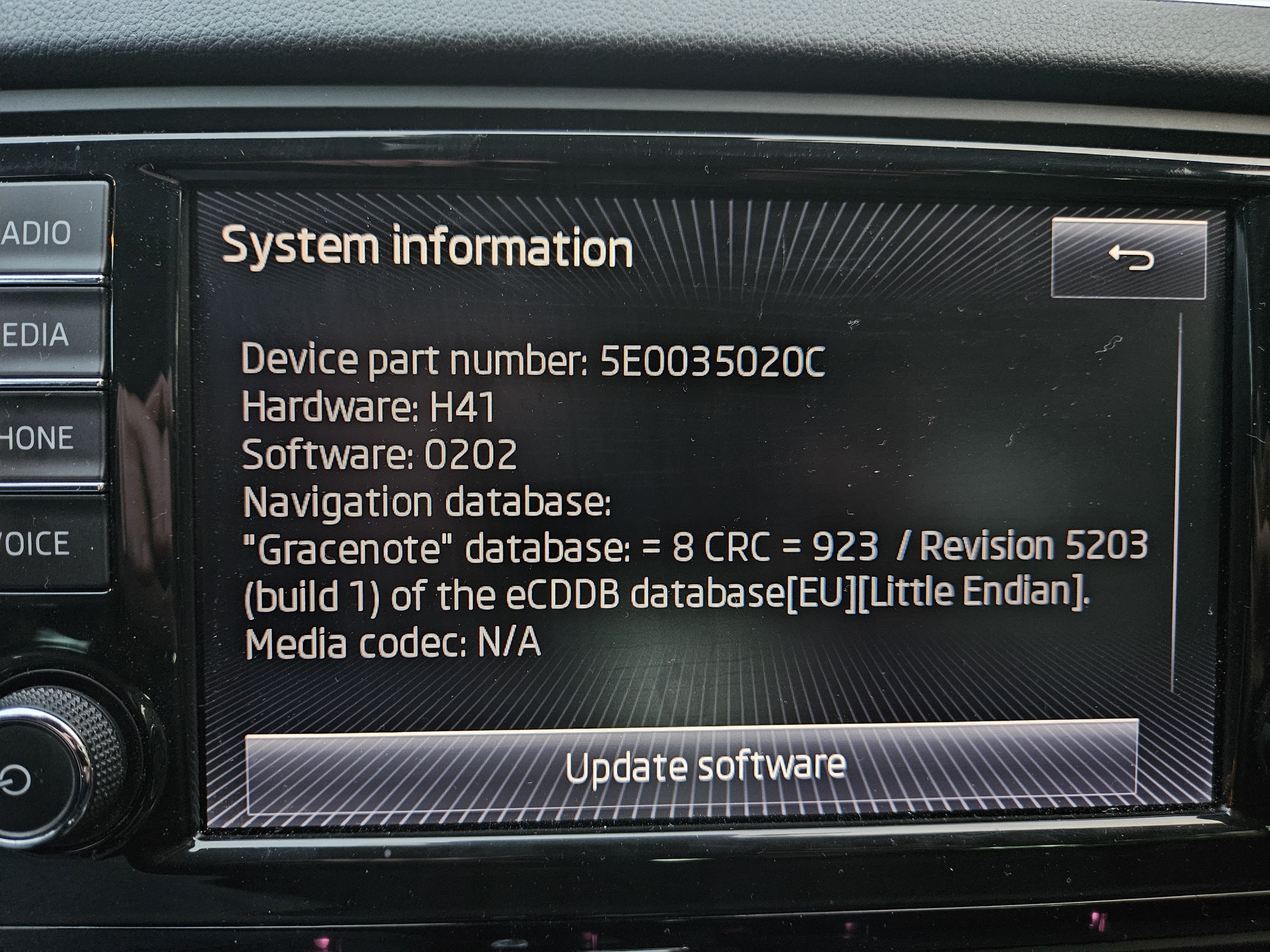

My current head unit is a harman mib 5E0 035 020 A and I found a used 5E0 035 020 C. Do anyone know if I can buy this one and just plug & play?

Probably your unit has a typical failure - dry joints in power amplifier section. It can be easily repaired by resoldering power amplifier chips.
You can replace 5E0035020A with 5E0035020C but it's not plug&play - new unit must have component protection removed by Skoda dealer, must have FEC/SWaP codes assigned to your car reinstalled and finally must be parametrized (coding and adaptiaions) to match your car equipment options.

I changed my head unit to another one with the same part number amd managed to install the newest firmware on it. The thing is that now the volume button doesn't work. Its stuck on mute and wont move when I try to turn it up through the button or the screen. Do you know anything about that @pab567 ?
Has the component protection been removed? Have you adjusted coding and adaptations to the ones from you old unit?
