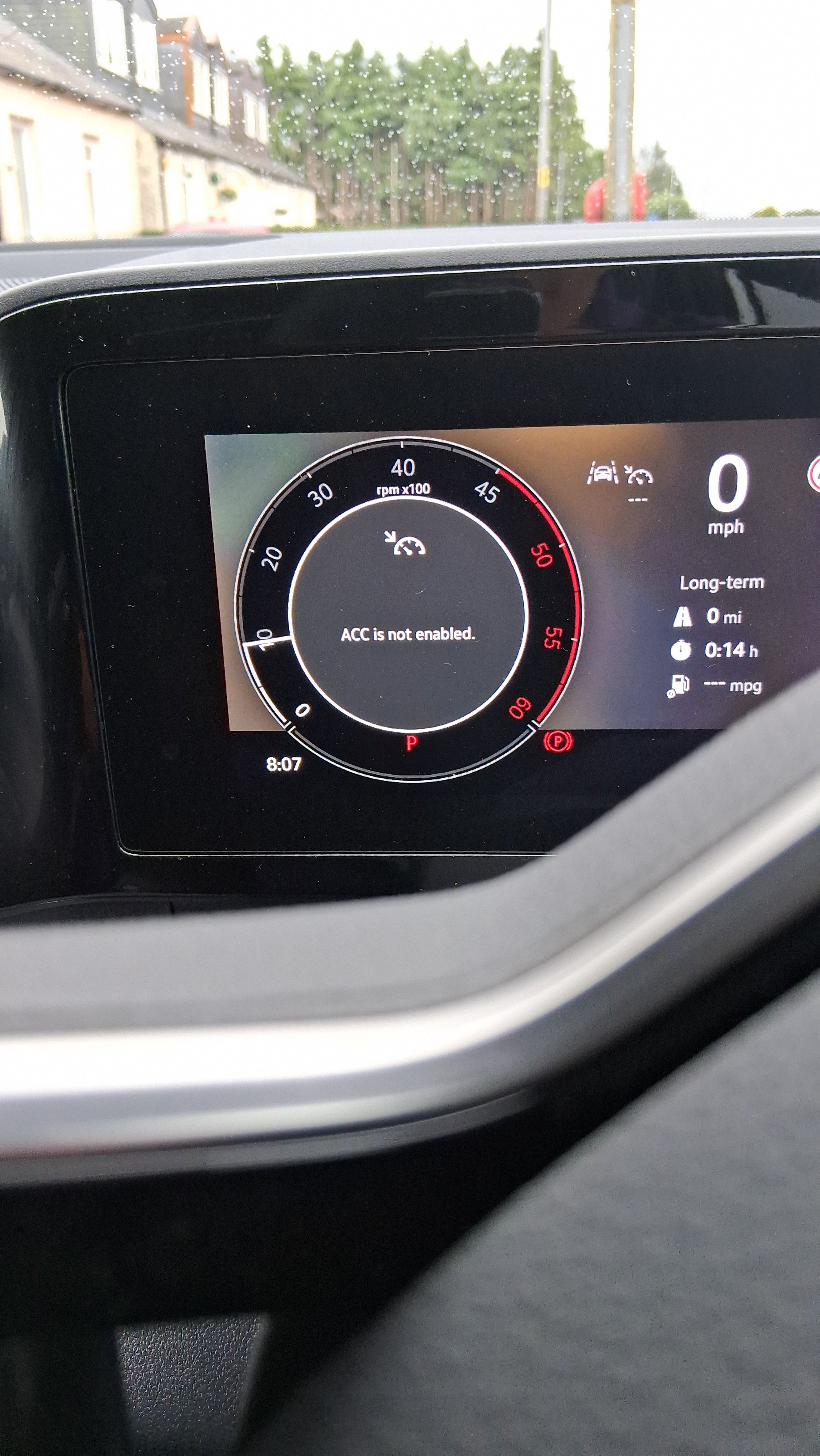

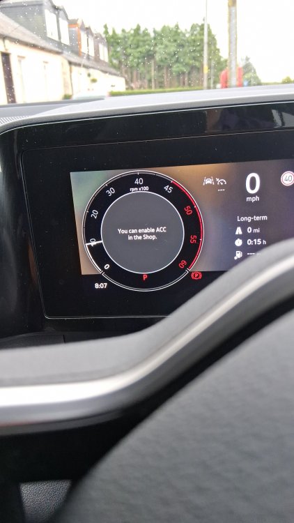

I have a query I hope the good people on here can help with. I have just taken delivery of 2024 Kodiaq SEL2.0 diesel DSG and I am having a problem with the variable cruise control. See the images attached for the messages I get when I use cruise control. I can't find how to.resolve the issue. My dealer gave me advice that didn't work and hasn't as yet responded to my follow up enquires
It looks like your vehicle doesn't have adaptive cruise control (ACC) installed. The message means you can purchase it through the shop.
I got this far but my big problem is finding the solution in Shop. Anyone got any clues?

Check your contract or offer, is ACC listed there as an option? If it is, kindly insist that your dealer honors the agreement and enables it. If not, you will probably have to purchase it presumably in the infotainment Shop

As GreenlineIIEstate has said ACC is not standard on the SEL in the UK. I'm currently finalising an order for one. It can be added as a pack during ordering (before it is accepted by the factory) this is as the Driver Assistance Package, for £830, which includes Lane Assist Plus, or can be purchased as a standalone for £655 from the shop post delivery.
My understanding of the 'shop' is that this is through the Skoda connect app. Then into more and then into service overview. There you can find functions on demand.

I picked up my Sportline 2.0 TSI on 03JUL and had a similar error. On mine I had to press a button near the RHS roller switch on the steering wheel. All I had to do was change the setting from "Speed Limiter" to "ACC" and it worked. Of course, the dealer didn't have a clue ;-)
