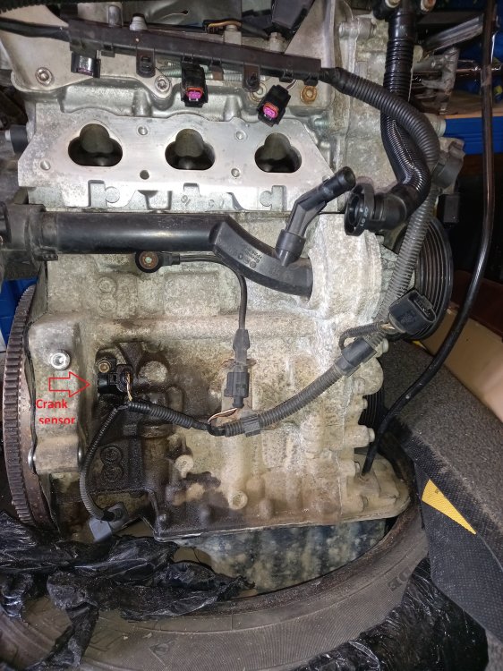

Im getting DTC 16705 Something to do with crank sensor, does anyone now the part number and where it is located on this engine?
Cheers
  • Sponsor
Crank sensor is at rear of block, awkward to access:
For part number, best to check using VIN, message me with it if you prefer not to post it.
TMBEA25J1B3034594
Thats the VIN Number
Cheers
  • Sponsor
For that VIN the crankshaft speed sensor is 03D906433 (dropped in Aug '23), superseded by 03D906433A.
