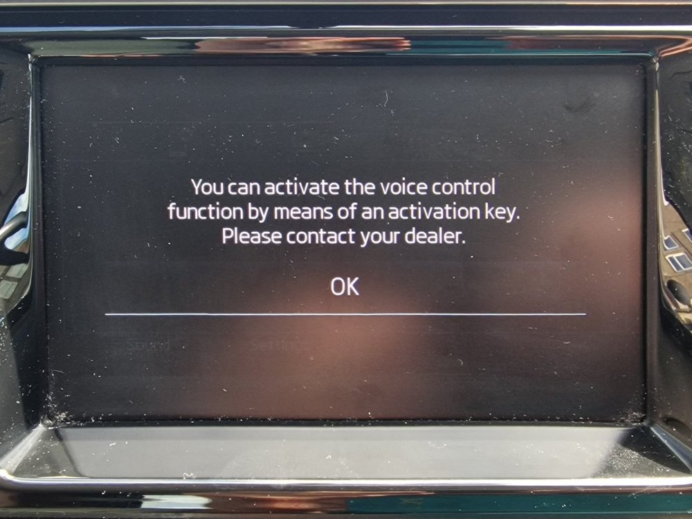

Does anyone how to get the Voice Control activated?
The message on the screen states: "You can activate the voice control function by means of an activation key. Please contact your dealer".
When I spoke to my local Skoda dealer on the phone, he was pretty clueless, so has anyone had a better experience getting this "Activation Key" from their dealer?

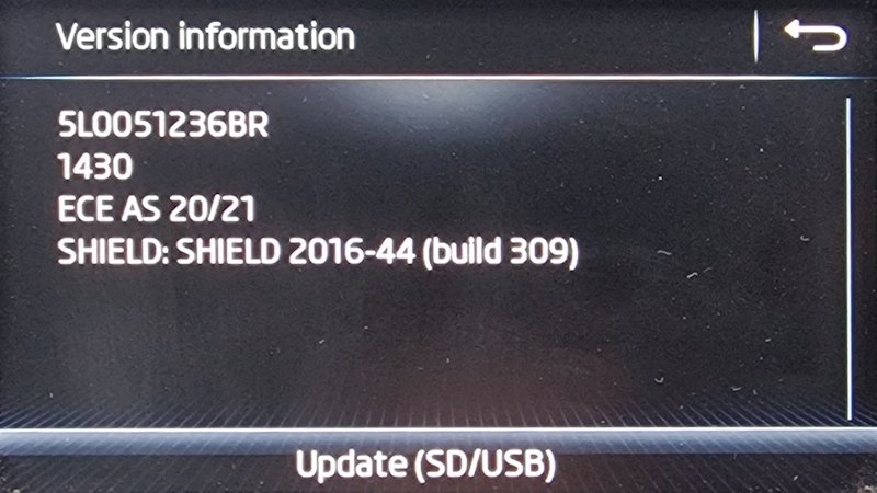

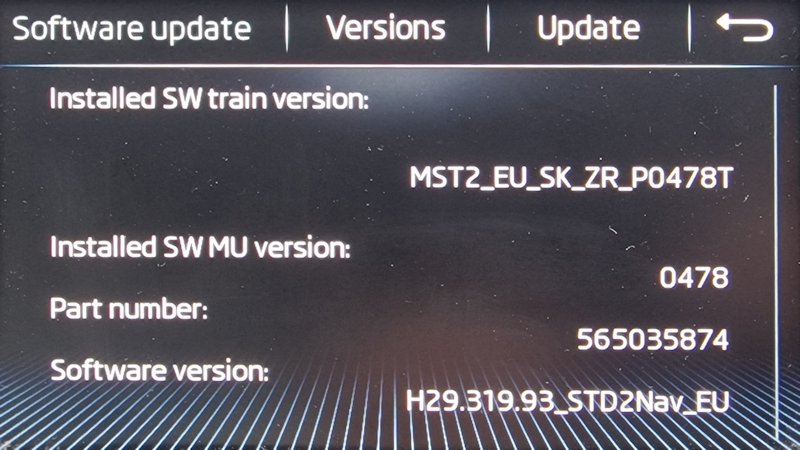

Show the unit Informationen.
You have to Patch it or buy the Key
Show the unit Information?
Can that be accessed via the Amundsen interface?
Yes,
I guess it's one of these and the other is the map version?
These were taken before I updated the head unit and also maps though.
So if the latest version info is required, I will get them tomorrow.
