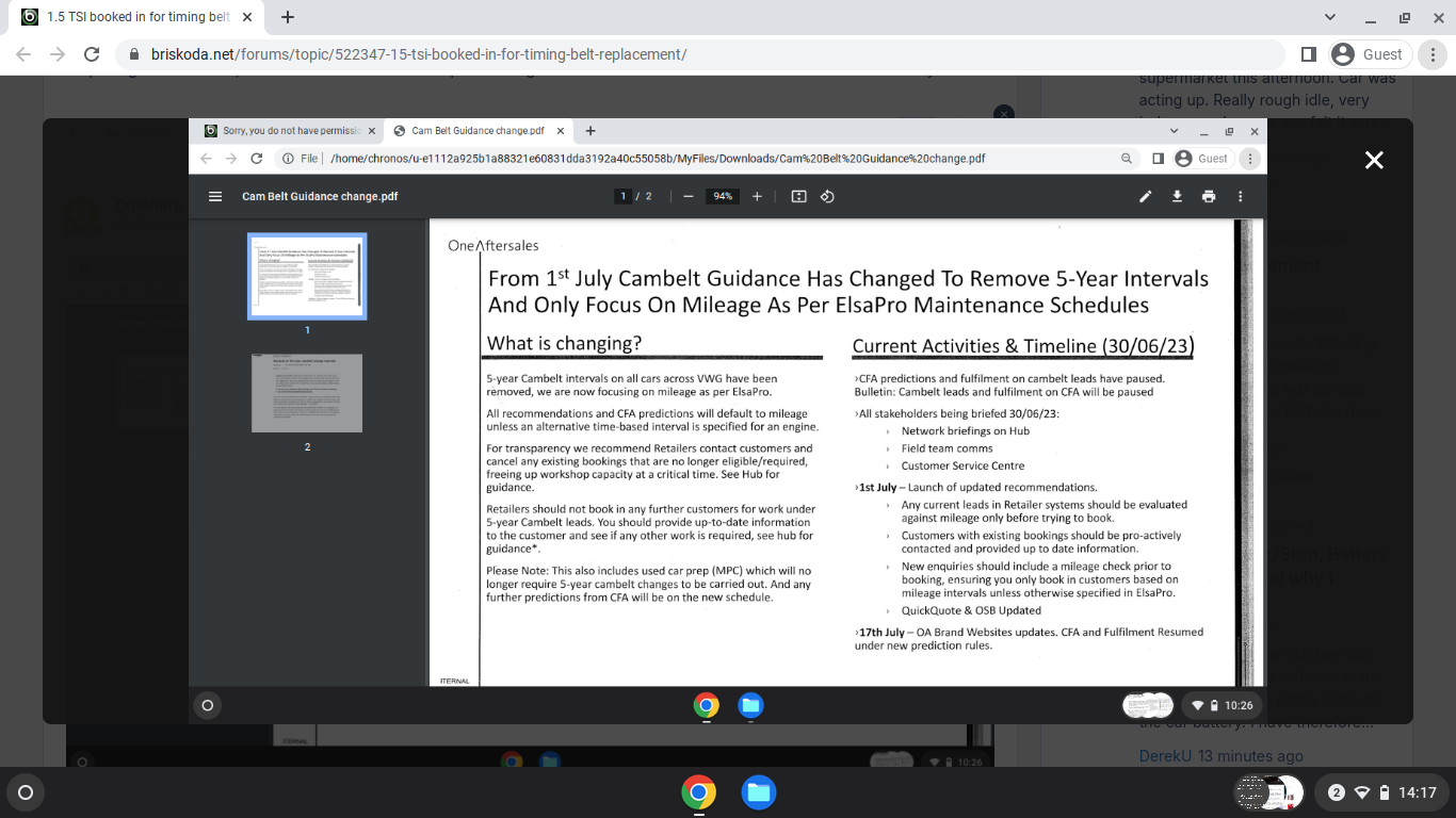

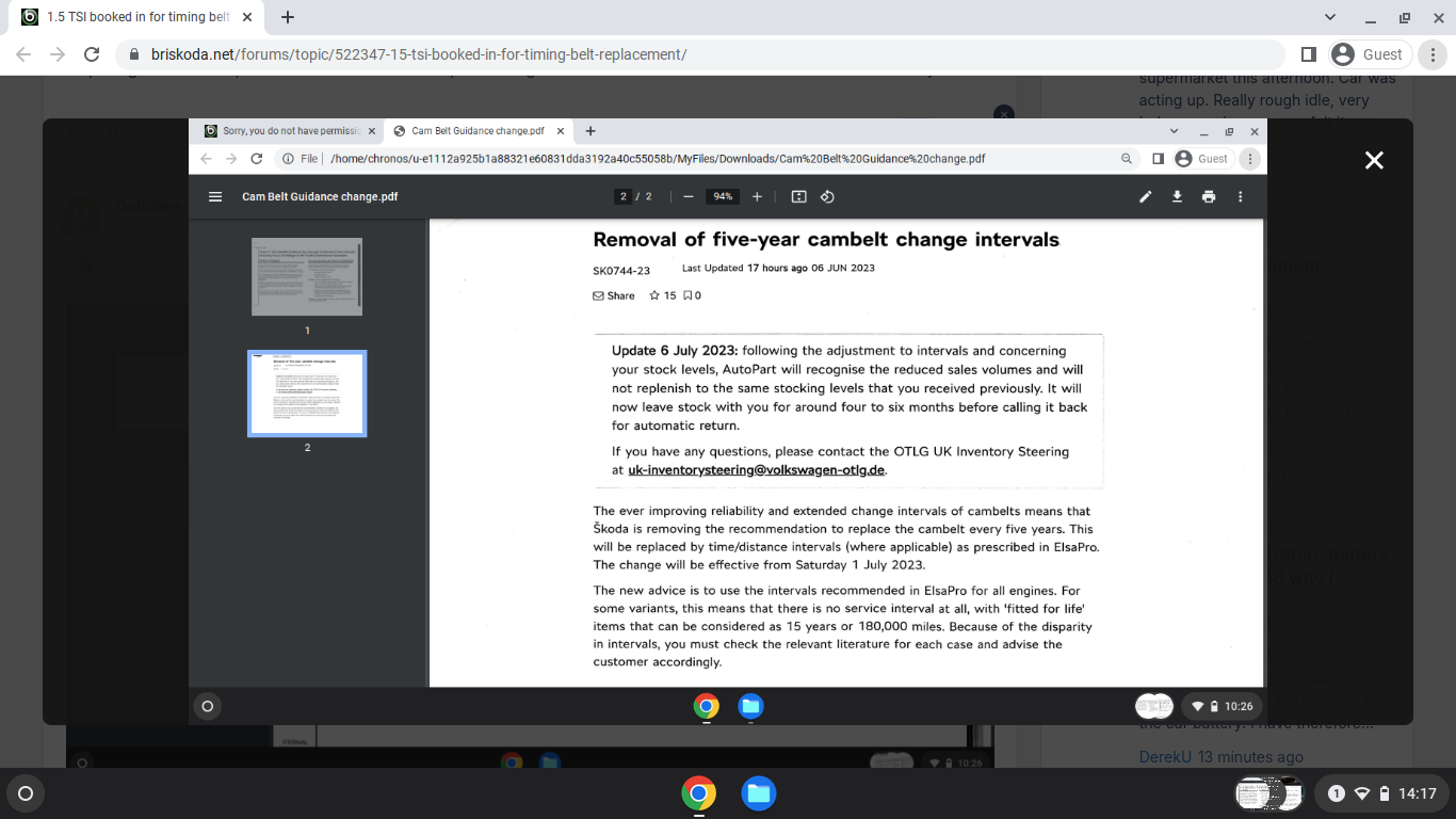

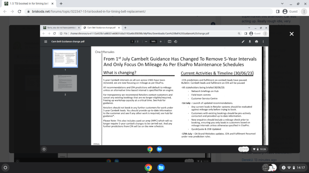

I just posted this on the Fabia forum as I own both a Fabia and a Karoq. My Karoq is due its service in a few weeks so I wanted to share this for other folk. I'm in a bit of a quandry on what to do really (not whether to change the belt or not but more whether this should be reported to VAG, Skoda UK or even the trading standards:
I would ask the Dealer Principal in writing if this is their policy.

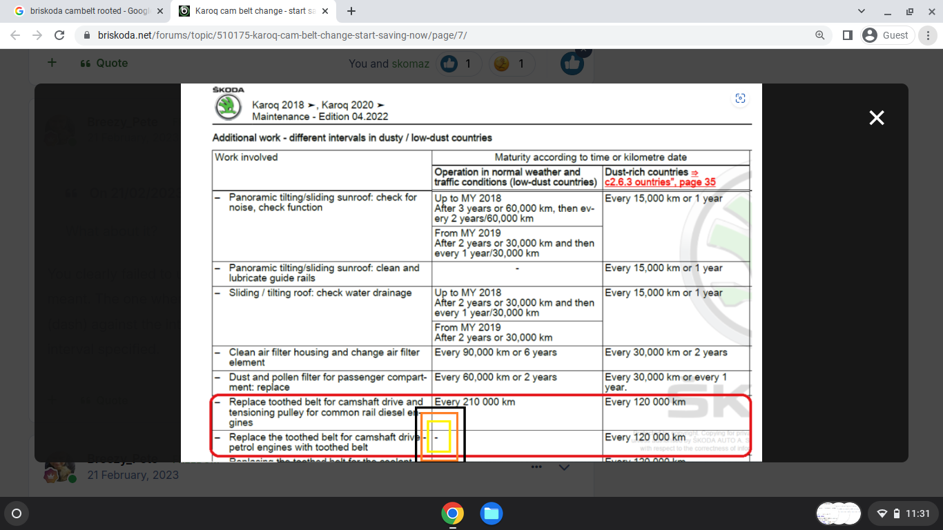

It was only in the UK which is not a Dust Rich Country up to 2023 that Main Dealers / SKODA / VW UK were advising, giving recommendations, or saying the schedule was at 5 years / 50,000 miles. Taking the p!th as it turned out.

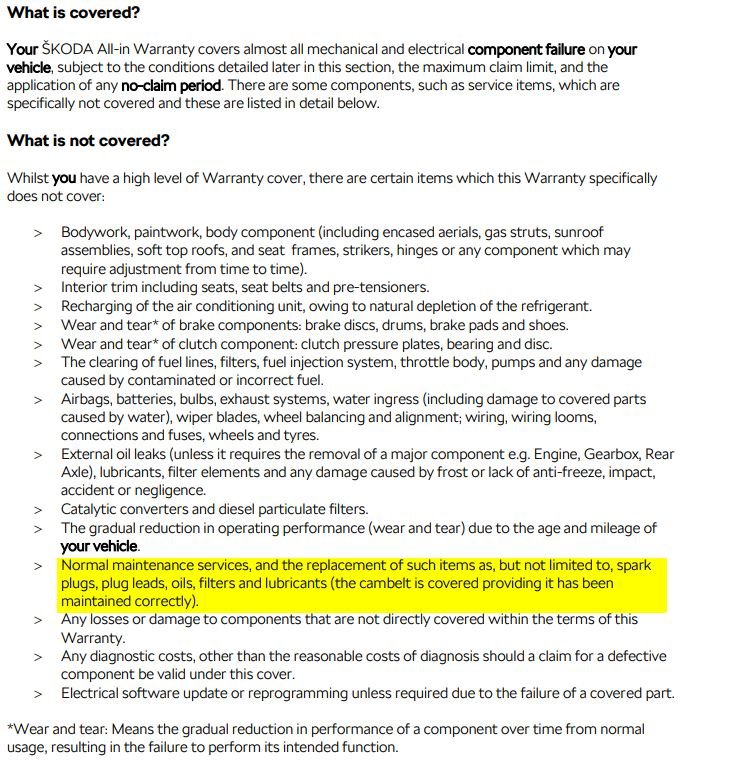

The Skoda All T&C says this but not sure about damage to rest of engine if it snaps?!?!1

I can't recall exactly without digging it up, but the SEAT one (at the time, they may have changed it - I'd be surprised if the various brands have different T's & C's) but SEAT referred to belts not being covers, and the terms did refer to un-encased belts. I'd regard the cambelt as encased, although SEAT might argue that it's got a cover on, rather than being encased.
In the Skoda term above it's clearly covered so it would be therefore be ridiculous if consequential loss wasn't covered - a new cambelt isn't going to be much use if the engine is destroyed internally!
