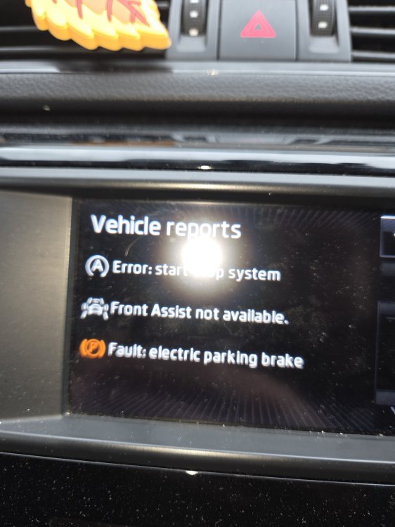

I own superb estate 2016 1.6 diesel
When I was driving I went over few pot hols and errors pop on (photo attached)
On top of that my central locking star opening and closing and error airbag com on .
After switching of the car and then start again errors gone except airbag
Did any of you have this issue ?
Can I sort this or i have to go to skoda
Thank you in advance

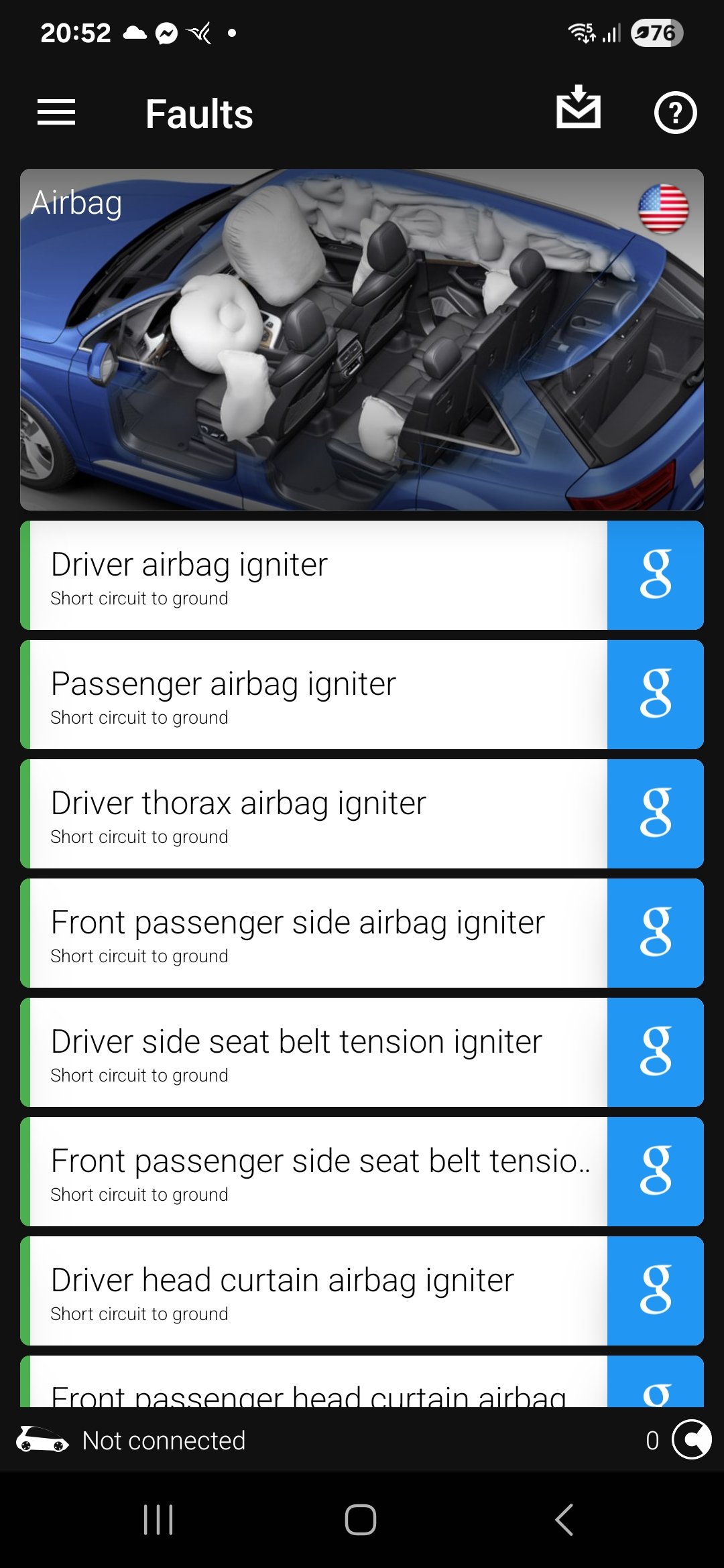

Hi all errors cleard just airbag still oon and this is what's on
So some wires issue as all airbags showing faults will look under the bonnet ower the weekend

The thing I meant is why weren't the airbag errors deleted, is more work needed, or is the scan tool used not capable, or is there an existing fault to only airbags wiring, connectors, module?
VWŠkoda Dealerships are often an expensive way of dealing with such issues, especially if they are going to charge you some high price for "diagnostics" which are only plugging in their scan tool to tell you what you already know that you have a reported issue/error code for "short to ground".
First result on Google search -
"Short to ground happens when the current flows through the car body to ground instead of flowing through the intended circuit. It can happen if there is a loose connection between the wire and the car body." - https://www.arrigochryslerdodgejeepramatsawgrass.com/electrical-short-circuit-in-car-explained

Airbag errors are perm and can not be deleted.

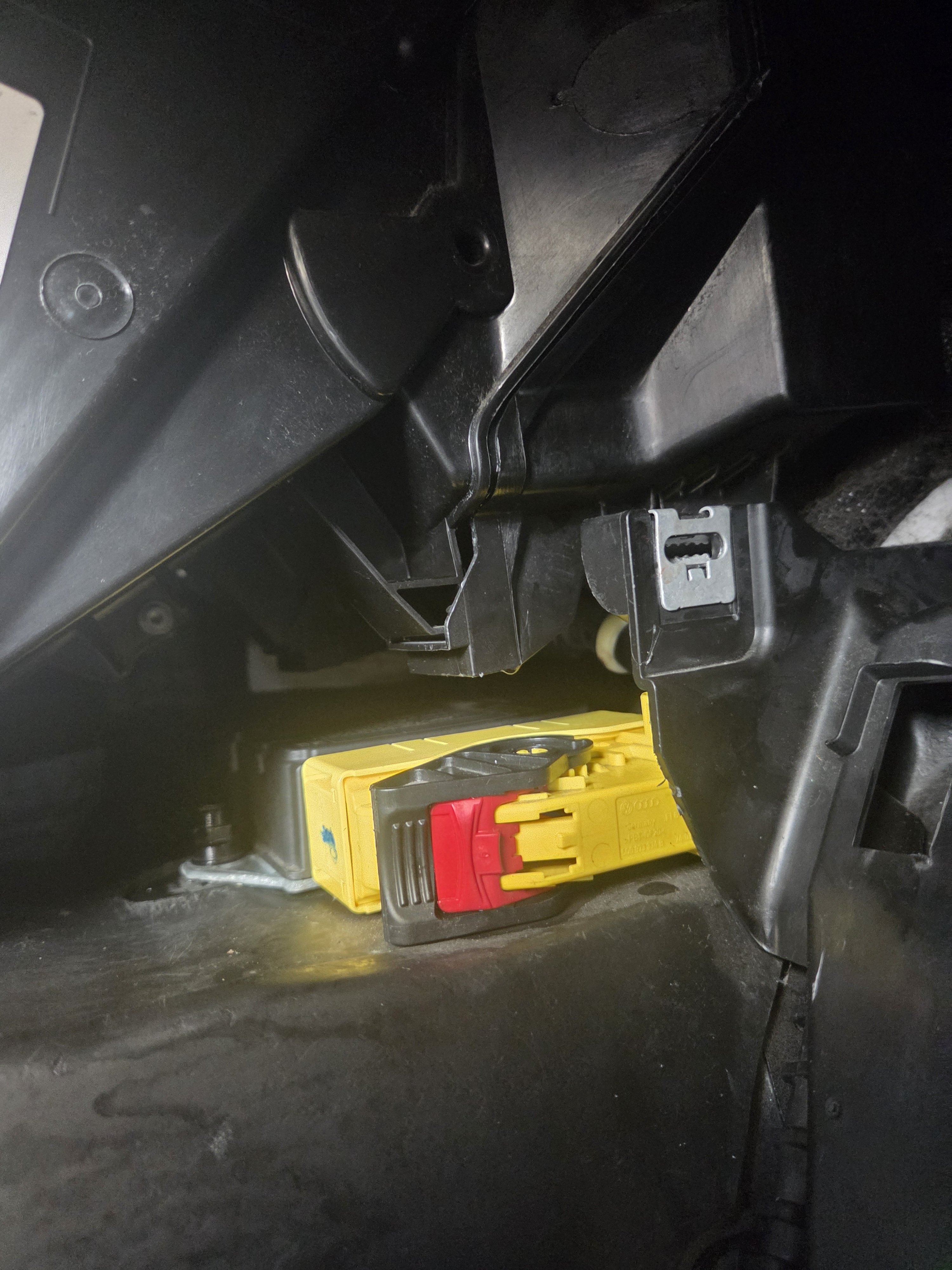

All this issue (as I discovered yesterday)
is made by aircon drain.
All fotwell is wet , under the seat are 3 plugs and wires( all wet )
Am I right can this be a main issue water and electricity ?
Now first I sort out the aircon drain
Dry out this wet spot
Check for rust in plugs
And then will see what's next
That's my plan 😌

Good afternoon
I'm putting my car to skoda garage
In 3 weeks as the problem wasn't solved by me 😀
I did what i was capable on my drive
Water still leaking on to the module from pipes above.
I clear drain for aircon, dry out footwell
Clear ground wires
I think airbag module is damage and need replacing.
Thank you all for all support and ideas
Leaking is somewhere above yellow box but I con not put my fat hands there to locate this leak photos add
I will prepare my wallet for skoda visit and let you all know what was it and the total cost
