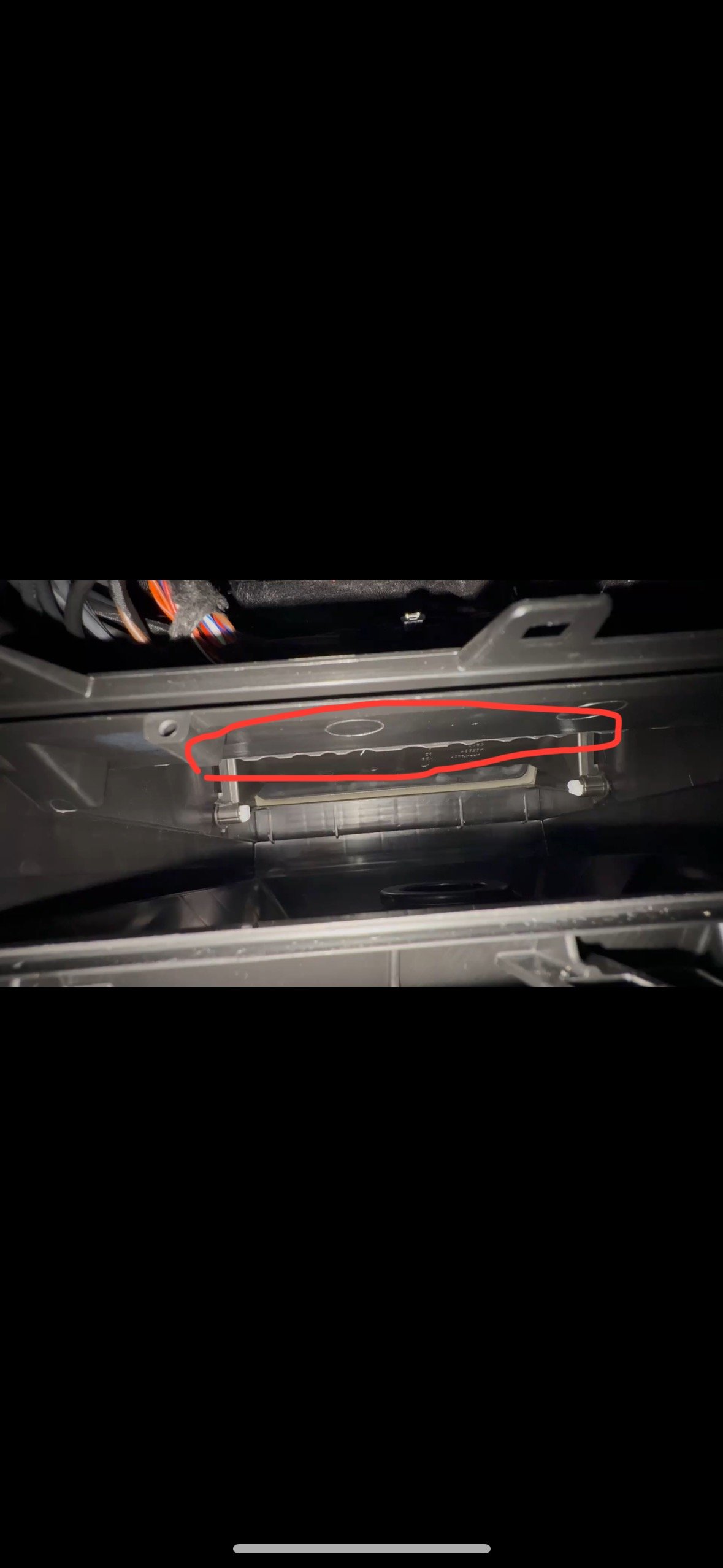

I found the culprit behind the pollen filter. It’s the flap you can see engaging here.
Nothing obvious that it’s catching on though. Least I can show them what it is now.
I don’t think it’s the big flap that’s making the noise it’s the other bit which is jaggerdy
At least you’ve found the problem, weird as your car is new, it’s almost like that bit should have some foam over it to soften the sound

Thank you, mate. I think you’re right. I’ll try and have another look tomorrow.
I tried the reset a couple of times and it doesn’t help, unfortunately.
