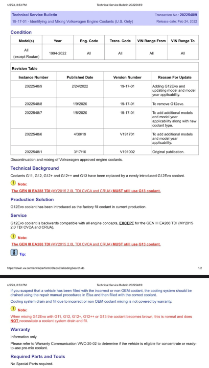

Around 4 years ago I removed the silica bag from the expansion tank on my 2017 2.0TDI 150ps.
I was planning to do a partial flush using G12evo, but I spotted a bulletin stating that EA288 must use G13 (see attached). It does say US only and there is separate conflicting info on what gen of EA288 it applies to (not just CVCA/CRUA). Does anyone know if it applies to the J623-CRLB variation? It seems that G13 is VIN order only.
