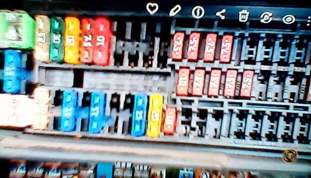

Thanks nta16 my next step will be to check the fuse box cover. I had hoped someone would have posted a picture of the fuses.

Lets approach it from the other direction, you put up a reasonable resolution photo (so it can be zoomed in on and landscape not portrait please) of your fuse box and we might be able to workout what might be wrong fuse wise.
Below is from May 2015.
In your photo -
  • fuse 5 =25a
  • fuse 6 =30a
  • fuse 7= 20a
  • fuse 8 = 7.5a
  • fuse 9 = 10a
  • fuses 10 to 13 empty
Fuse 8 according to the 2017/11 'Owner's Manual' is "Towing hitch" also on May 2015 as "Trailer detector control unit - J345".
So if you don't have a tow hook on your car try removing the 7.5a fuse from location 8 and put it in location 12 and see if the Infotainment screen comes to life.
I have only looked at Fuse (location) 8 and 12 I've not checked others.
As I put for whatever reason annoyingly VW haven't put the fuse size in the 'Owner's manual' same as they don't oil capacities, "simply (not) Clever".
Let us know how you get on.
nta16 I finally got round to changing the 7.5 fuse to the position you suggested. I now have a functioning infomation centre again. I am very grateful for your help and appreciate your time and effort, a very big thank you. Next time I will do what I usually do and take a picture first.
