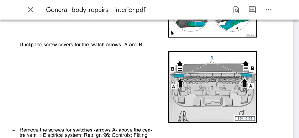

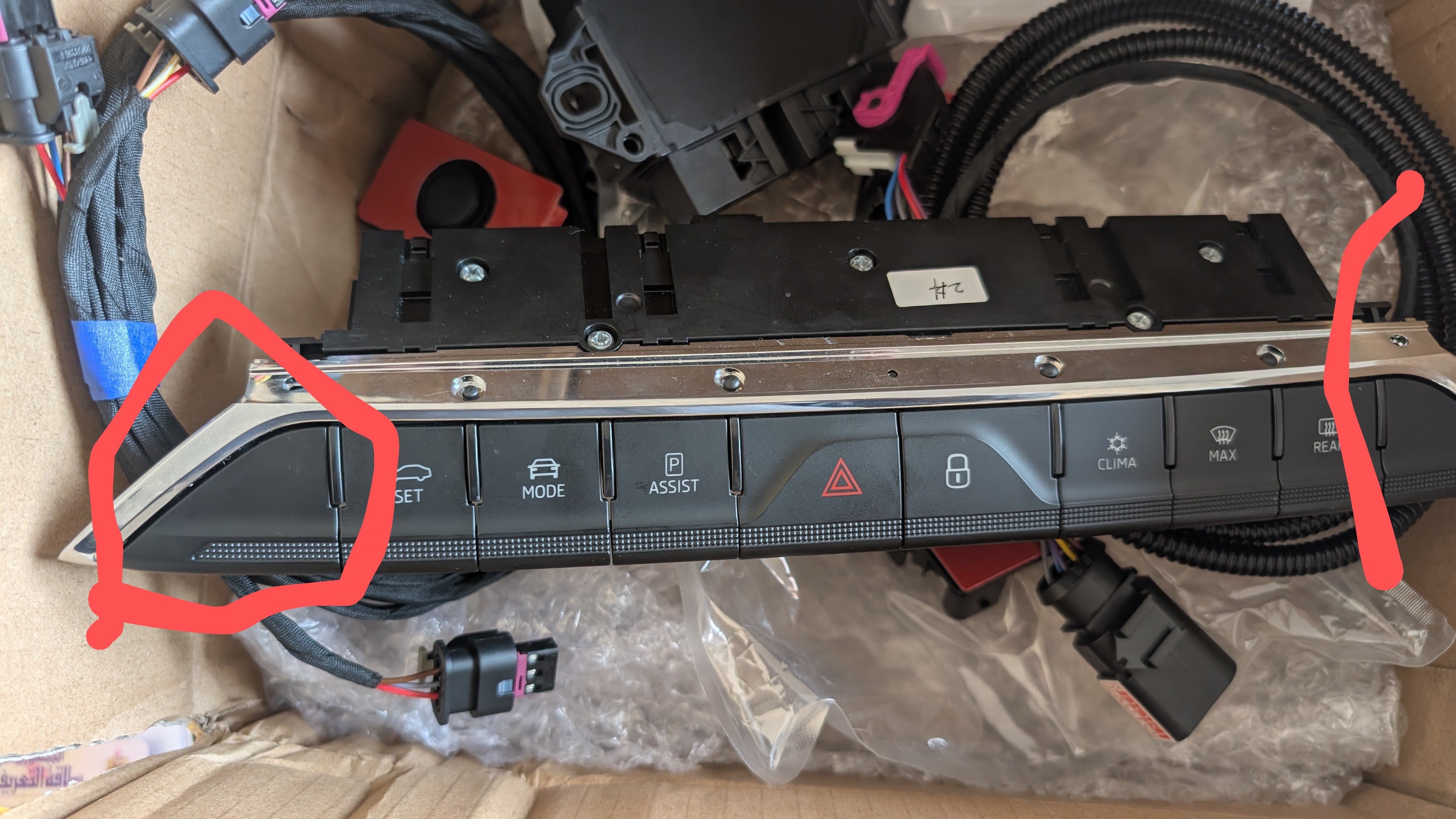

I need your help. I am looking to remove the central switch to upgrade it how to remove it?
I did not succeed to remove the two covers left and right, I think screws are behind
I’d also like to know this. I’ve found this, but I’ve tried everything to unclip the covers…
Insert a plastic tool in A and pull it with a lot of power. It is not easy
