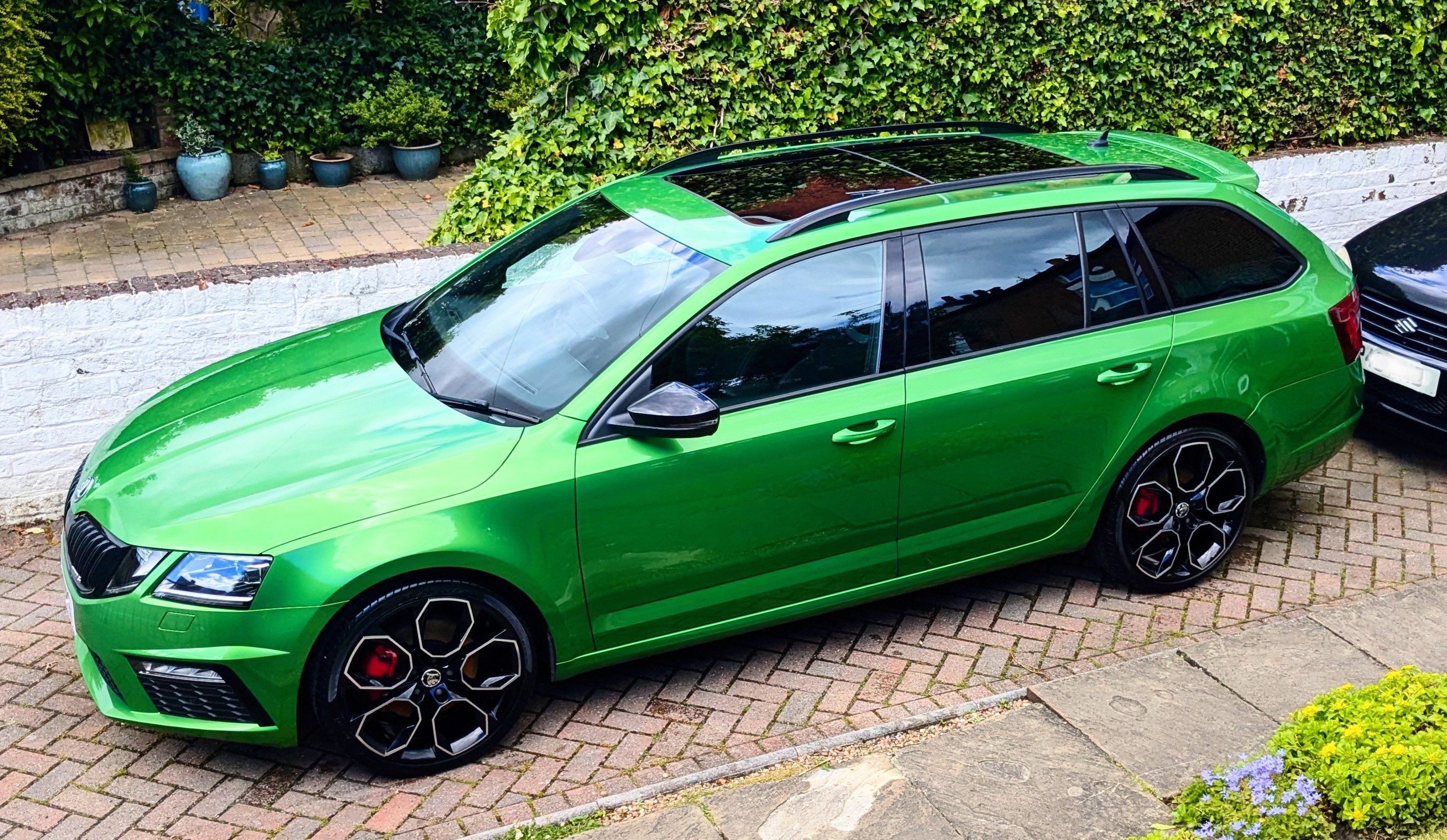

I had a 2018 Mk3.5 2.0 diesel 4x4 vRS for about seven months. I loved the car in many ways as it fitted five of us plus dog and all our stuff without the need for a roof box. The Canton stereo was great and the pan roof was also a nice touch (although it did creak a lot).
The fuel consumption wasn't as good as I expected and it averaged 43mpg over about 4500 miles. Like you our mileage is around 10k per year and I thought I'd found the perfect car as we do a mix of driving and it seemed to fit the bill perfectly.
Turns out it was a complete nightmare. I bought it from a main dealer with a year's manufacure warranty for peace of mind. In the time I had the car it needed a new dmf, a head gasket, five coolant flushes, multiple trips to the dealership and even after all that the coolant was never pink. It always turned brown after a few miles. There were a few other niggles too which I won't bore you with. I eventually sold it to Motorway and took a massive financial hit just to get rid as I couldn't trust the car.
I now have a 20 year old petrol Legacy estate as I think the Octavia has put me off diesel VAG cars for life. I would consider a petrol Mk3 vRS estate though as I've had three other petrol Octavias in the past and they have been great. Perhaps a diesel might not be right if you don't do mega miles as the petrol Octavias are pretty good on fuel in my experience.
On another note, if anyone knows where WX18 OPS is now I'd be interested to hear how it's getting on.
