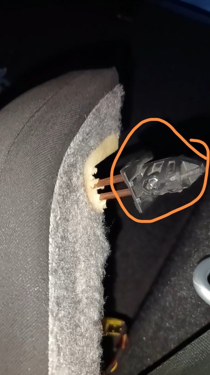

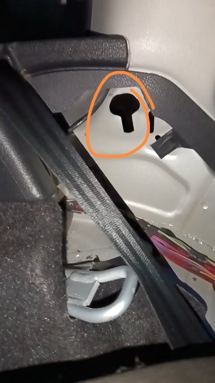

Attachment at the top seems to work by a plastic part which first goes into the elliptic hole in the sheet metal, then slides down into the slot below:

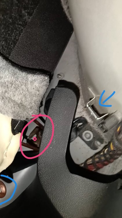

Attachment at the bottom works by a slotted metal bracket mating to a threaded stud on floor (highlighted in pink, stud not visible), and a U shaped rod sliding down into the sheet metal U (highlighted in blue):
