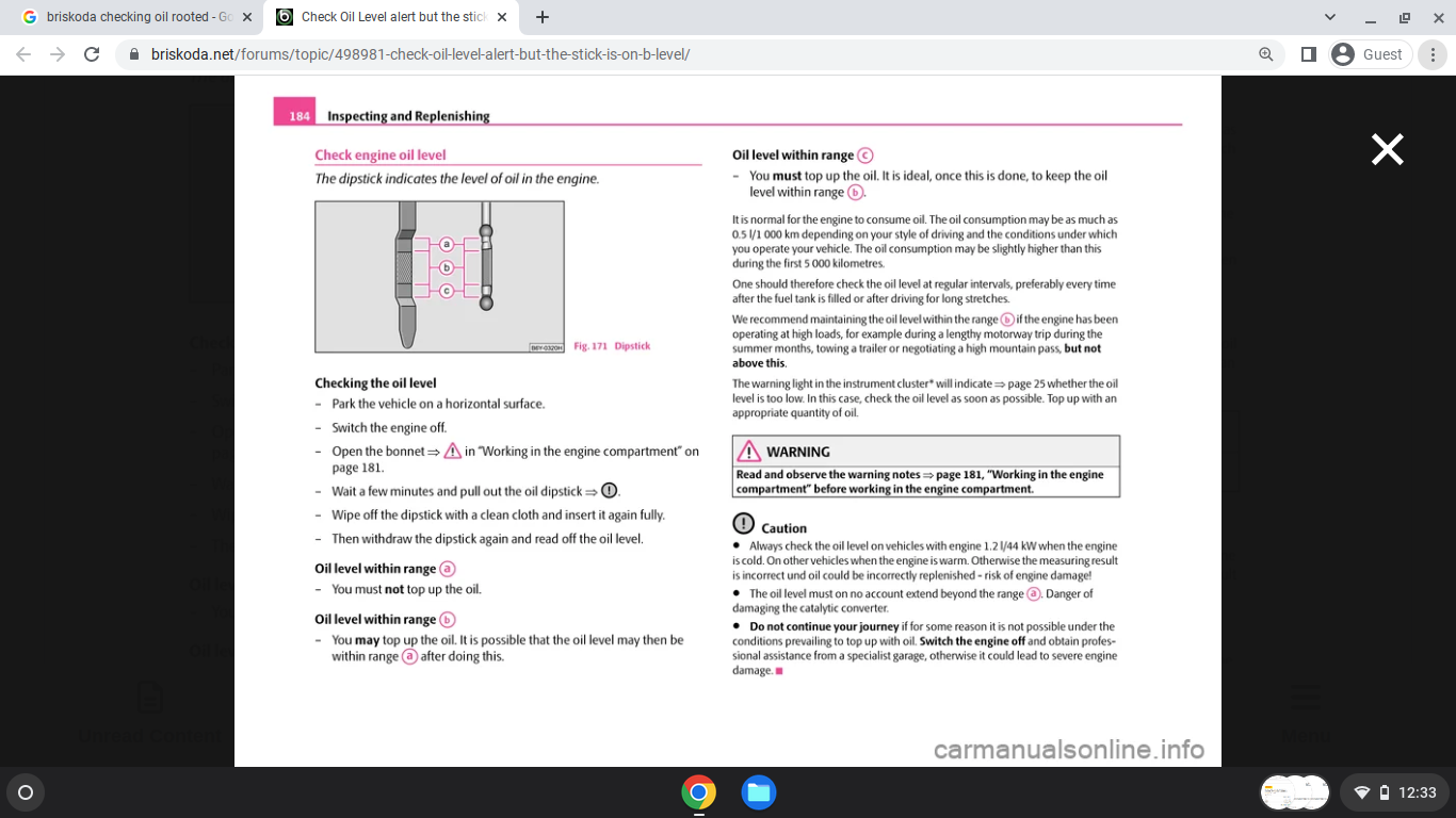

Needing oil after 4,000 miles in a TSI be it highly tuned or not is not unusual.
Fill to Area A, which is above the cross hatch as shown in a Owners Manual.. That level when at operating temperature.
Is that the level dipped with cold oil before the engine started,
or as the oil needs checked after that. @ normal operating temperature after a few minutes. (4 or 5 minutes is a few.)
Skoda Dealers might well have used Quantum by Fuchs oil.
Likely VW 508 00 / 509 00, so 0w 20 FS IV, is there no sticker under the bonnet.
Ask them if they did, or do they use 0w 30 FS III, VW504 00 / 507 00
Edited by Ootohere

Interesting it states to check the level engine off but hot. Obviously suits the maintenance work in the dealer (?)

@911hillclimber If checking cold & think that is all in the sump then great. Your theory is OK.
So now maybe check as the Manufacturer recommends, shows, and compare.
Then you will know where it should be cold before trips.
BY HAVING THE CORRECT OIL LEVEL WHEN AT OPERATING TEMPERATURE SINCE THAT IS HOW AN ENGINE DRIVES. NOT SITTING UNSTARTED & COLD.
