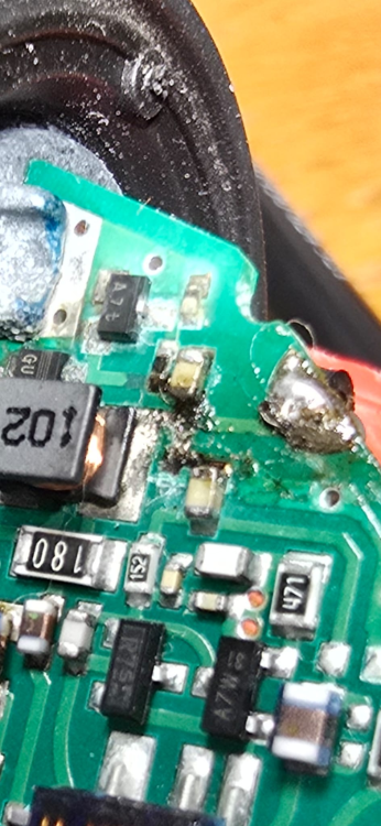

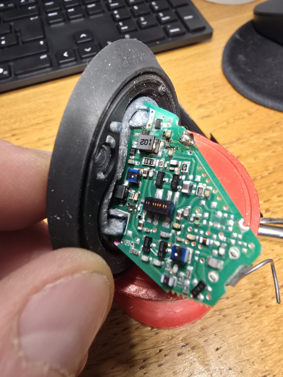

I recently purchased a 64plate and had poor FM reception, I ran VCDS and it said that the antenna was open circuit.
They suffer from corrosion so opened it up to see if I could save it but was too far gone, £5 for a 2nd hand one from the breakers (from a Polo) and all fixed.
