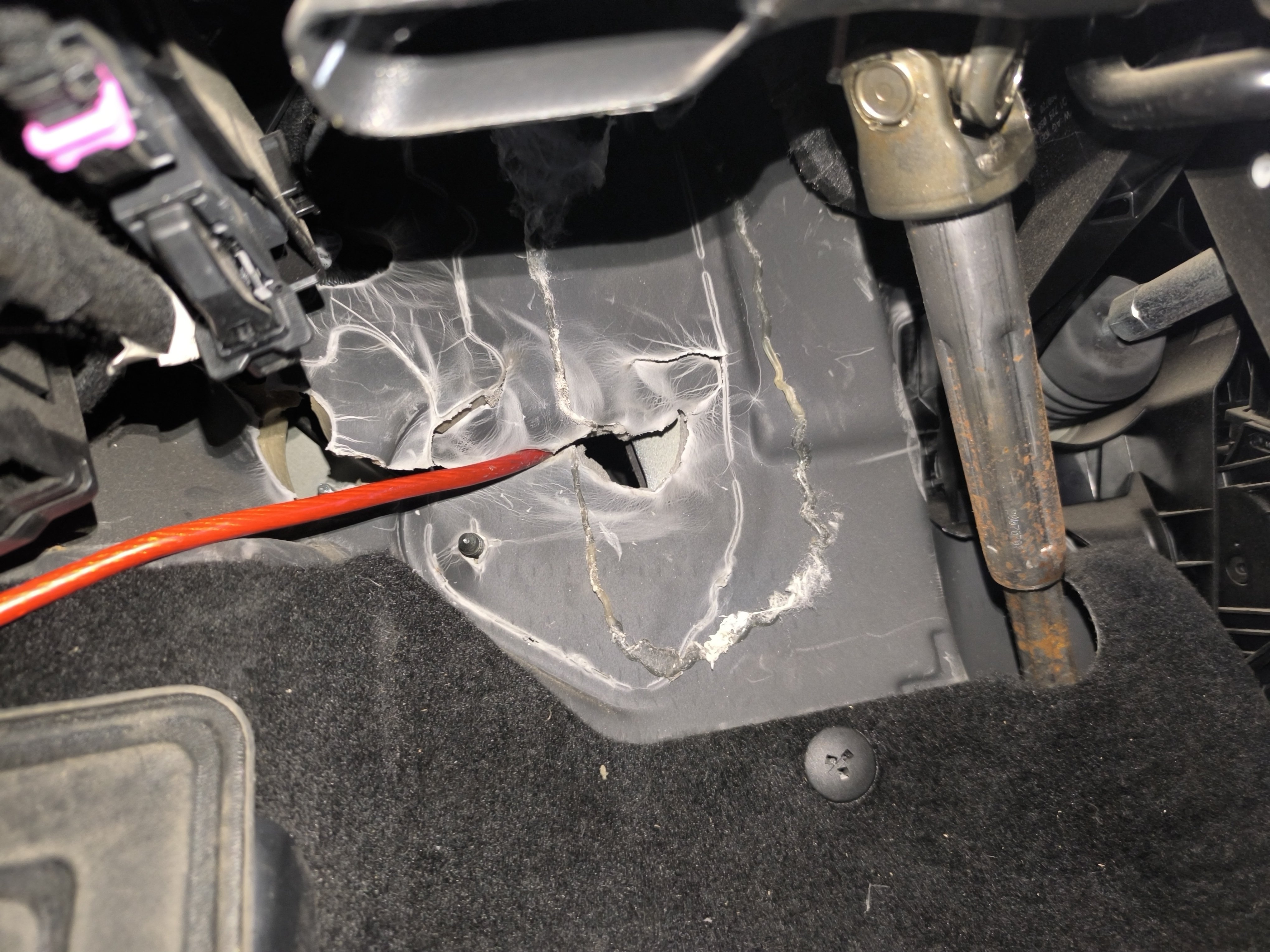

Power cable (VCC): I ran it along the left-side plastic trim, under the rear bench. To get into the engine bay, you need to remove the plastic cover near the hood release handle. Behind it, there’s a rubber grommet in the firewall that becomes easy to spot once you peel back a bit of the foam. That’s the perfect spot to pass the cable through.

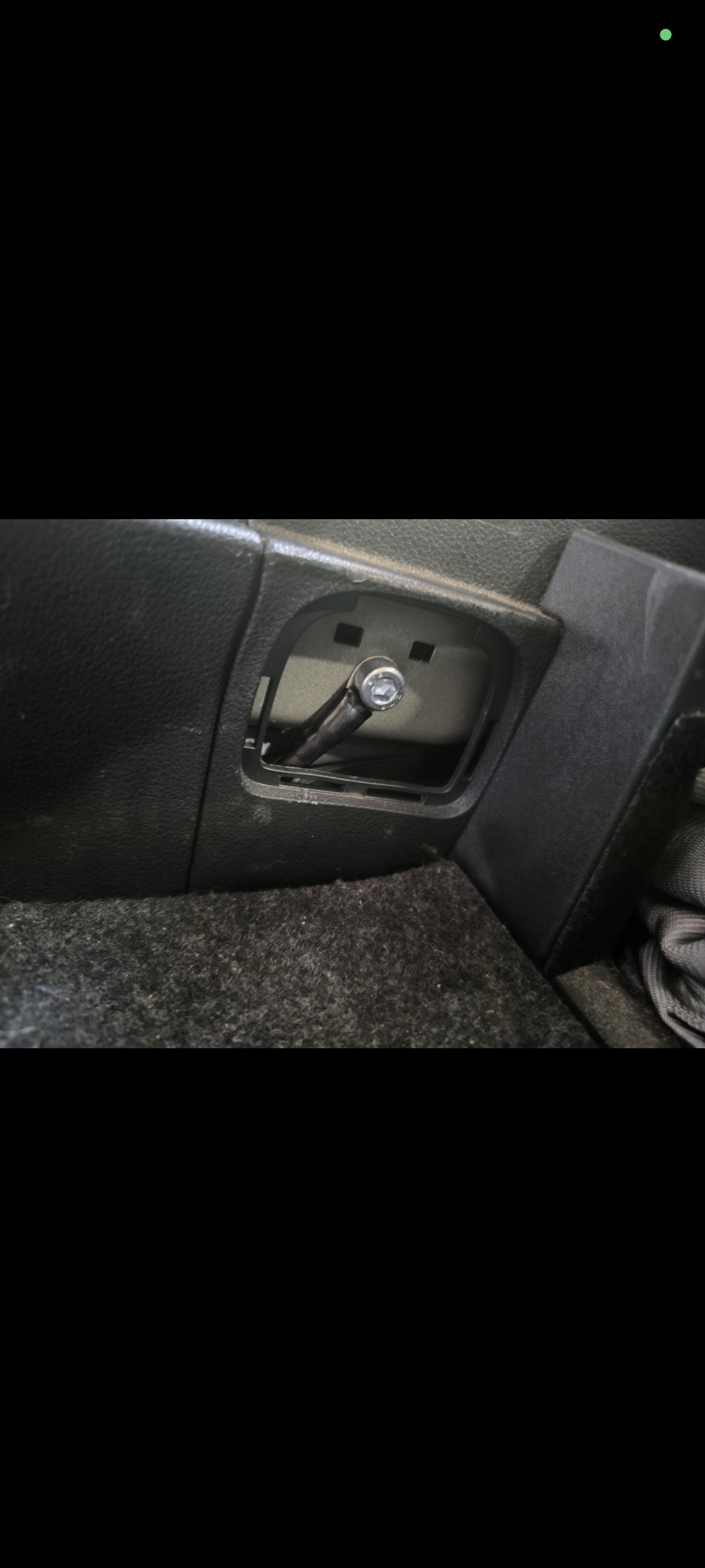

Ground (GND): In the trunk, on the left side, there’s a cover with an 8mm threaded bolt – a great grounding point.
I also had to remove the battery to pull the power cable upwards. The battery is held down by a bracket; once that’s off, you can slide the battery forward to release it from its lock.
To feed the wires more easily, I used a fish tape (the kind electricians use to pull wires through conduits). That saved me a lot of time and effort.

for wiring the power cable:
