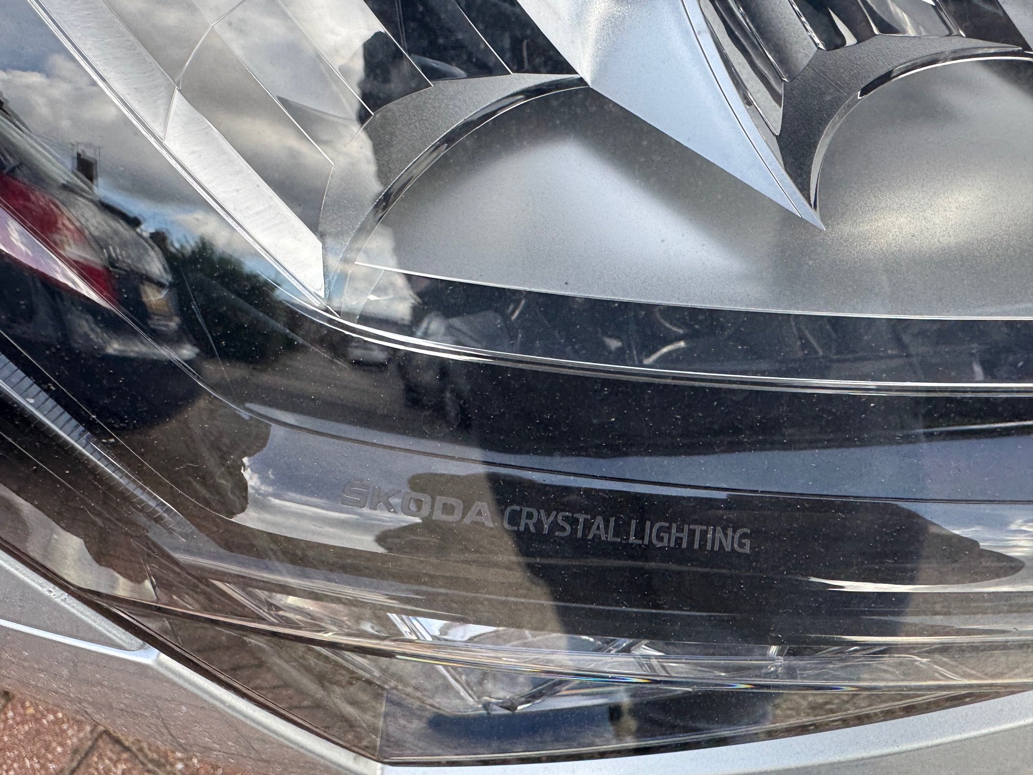

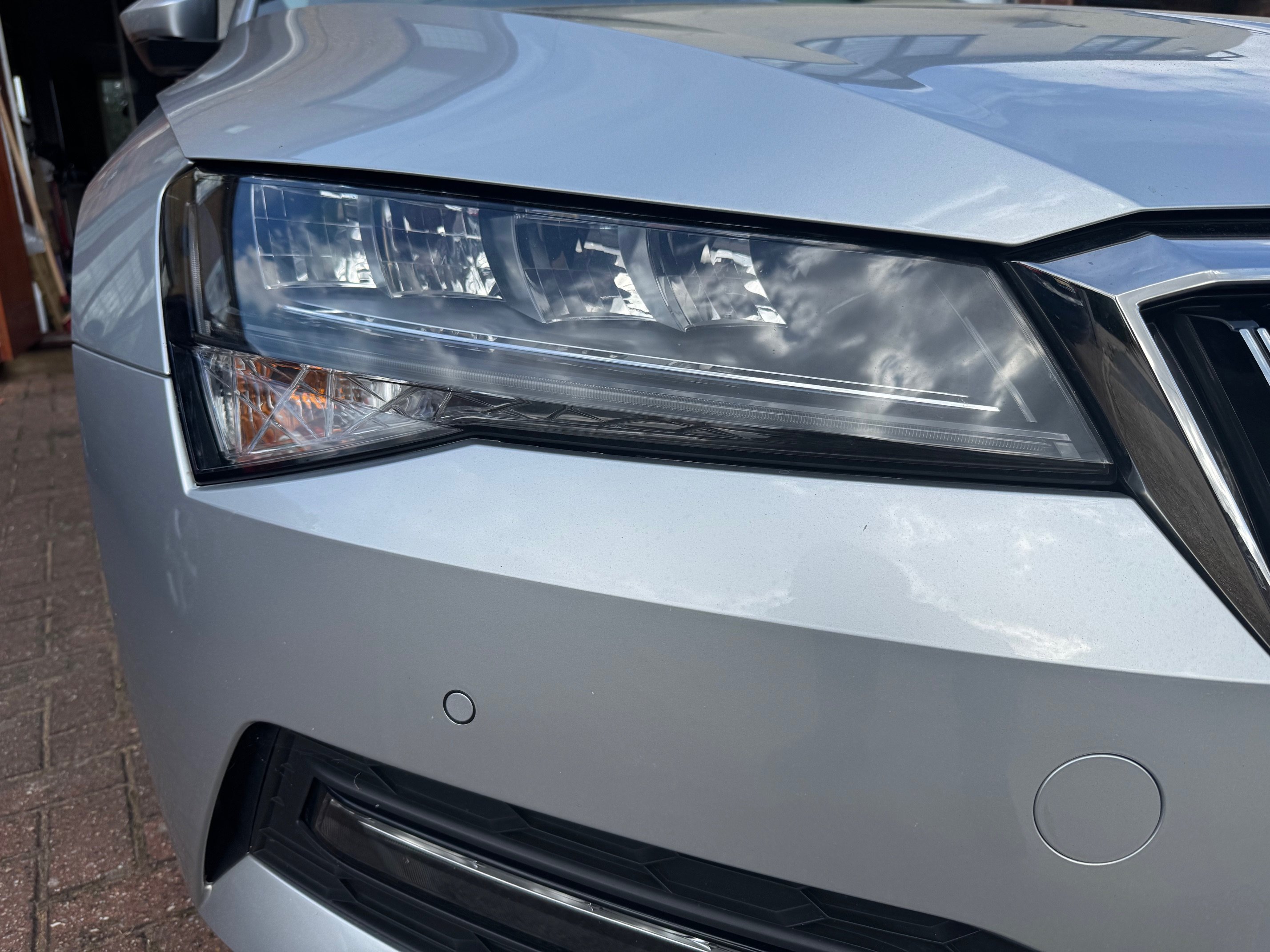

Hello. Drving to Germany via France and Belgium next month. First time I've taken the Superb out of the country. I am unclear whether the lights need beam converters or not (and I can't see anything in software to deal with it).
These are the lights in question:

Those are reflector headlights for the FL base models so yes you do.
For the Matrix LED's on the FL SEL and above you don't.

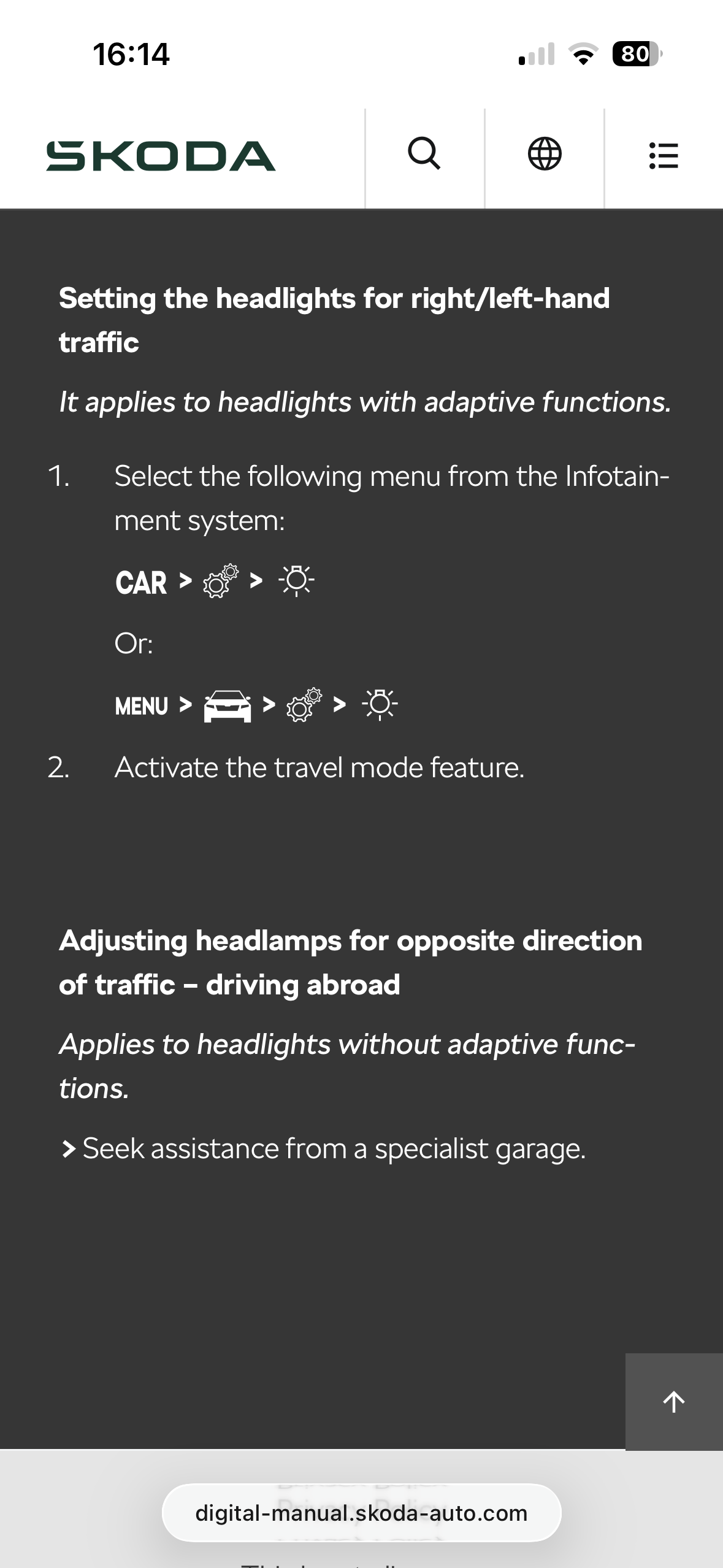

Just to confirm this is where you checked the travel mode
LED relfector headlights don't have that. The beam pattern is fixed so a beam deflector is needed to mask the beam kick.
