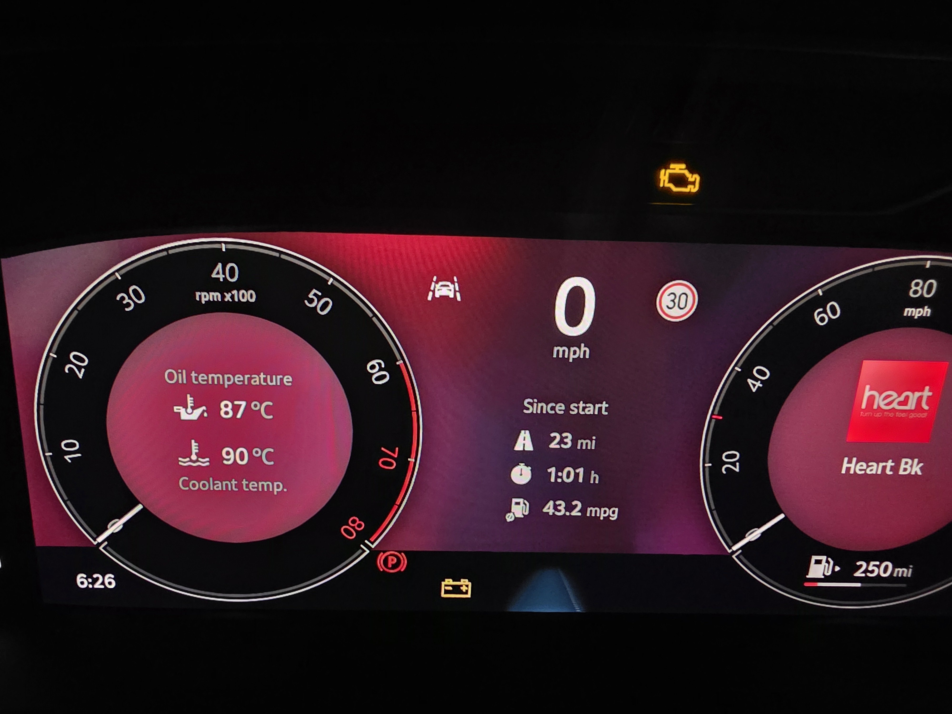

With just ignition on after a minute the yellow battery light comes on if gose off when I start car. The start stop works ok for about 3 to 4 hours then stops working last week it stopped completely so I charged the battery then it worked again for 3 to 4 hours.
Any ideas?

    Got my car back. Verdict was defective battery so replaced with new one

    Took the car for an errand today and it stopped and started so many times I turned it off. So it works properly now :)

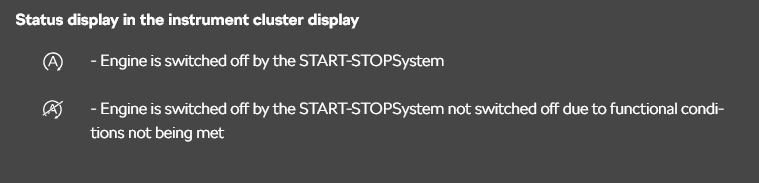

Do you get either of these on the display
No just stops working i drive all day it's fine for about 4 hours

Do you not see either when it is working?
No just the A with a line through it
When the a with the line through it appears it means the stop/start system is operating but has chosen not to stop the engine because the battery is not within the parameters required for the system to function.
There maybe too many other demands on the battery Aircon, cooling fan , headlights, heated seats etc.
Or the battery is below 80% or a combination of all above.
I would doubt the battery or alternator have a fault with the age of the car.
Potentially it is use and the demands of the eu that is stopping it working.
