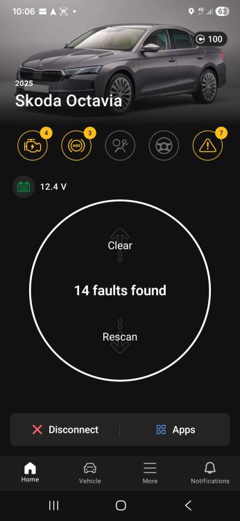

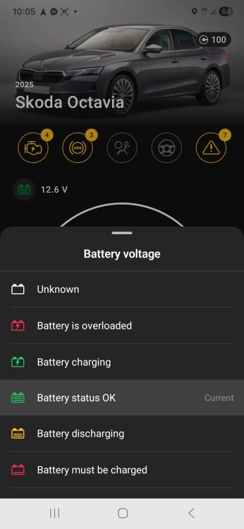

At 9:26 the battery voltage was 12.2v but appeared to have no trouble starting the engine at
9:29 14.9v engine running alternator charging
If you left it running until
10:05 got up to 12.6v engine stopped
surface charge dissipating until
10:06 12.4v
no data to see if this carried on back down to 12.2v
Data visible suggests the Battery is very low on charge.
The scanner says battery condition currently ok at 12.6v 10:05
10:06 12.4v

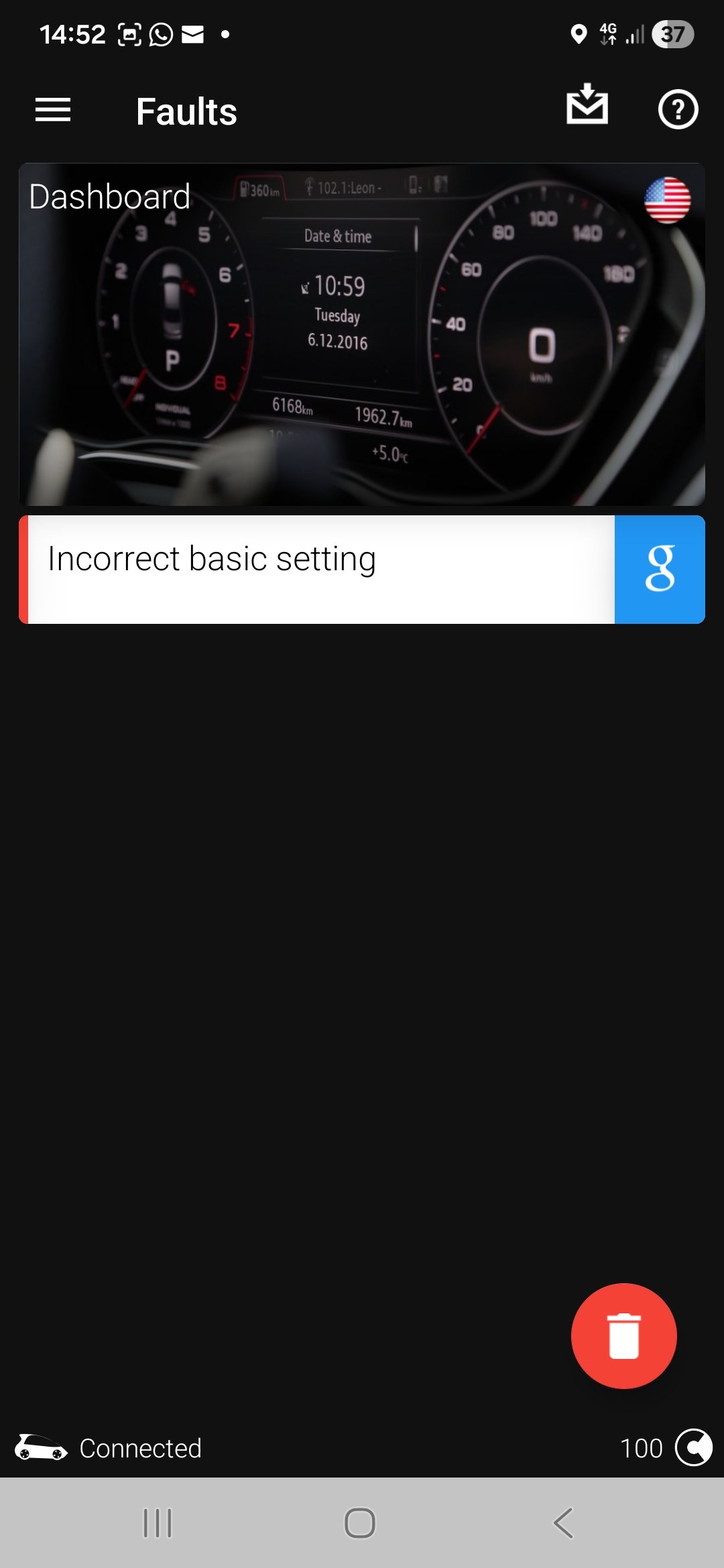

I scanned it again with the obd eleven vag app this time and only bought up 1 fault?
