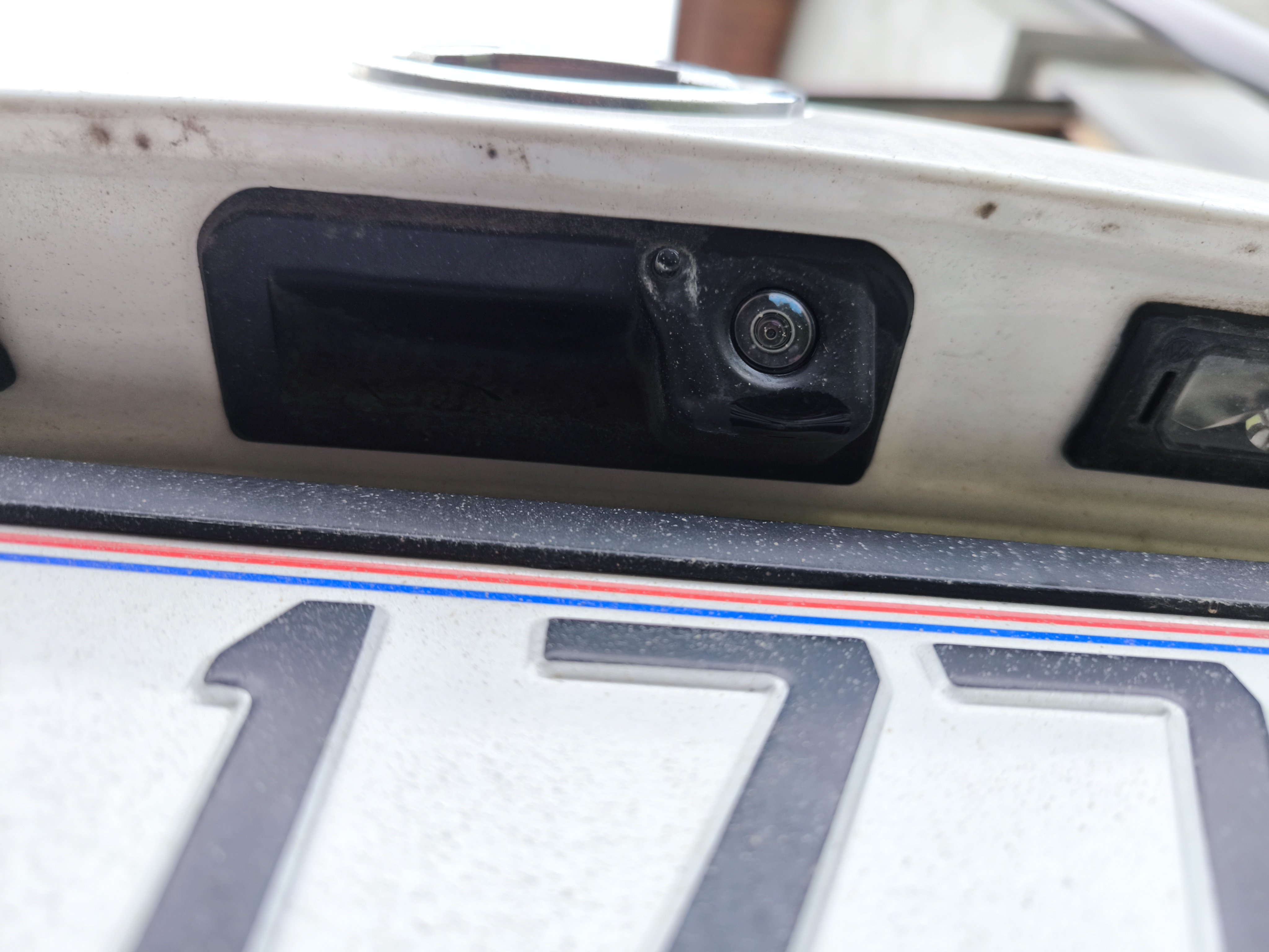

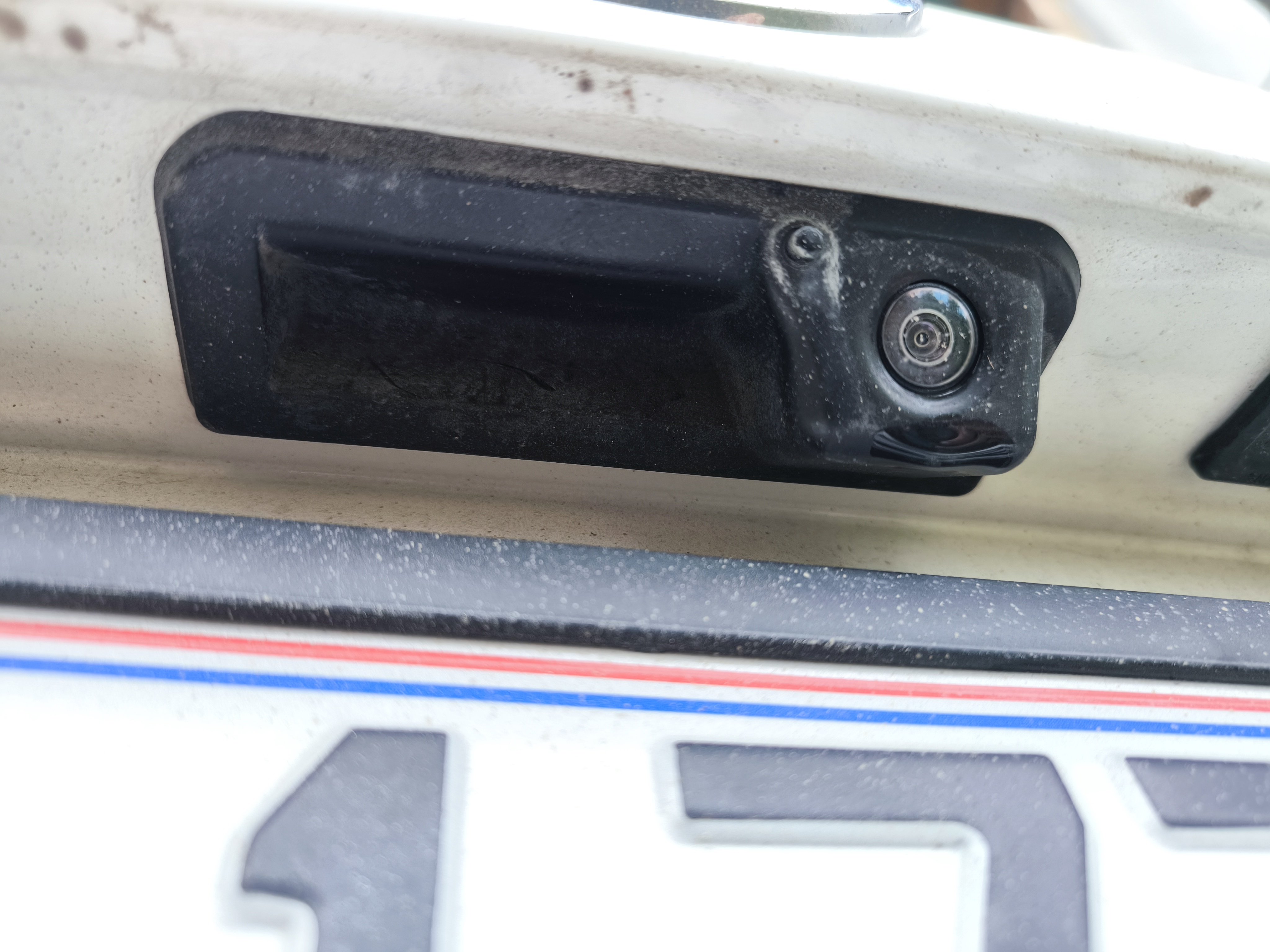

The kit has arrived and I appear to have been sent the round edge handle, mine is a all square handle.
Can this handle fit before I start the process or should I send it back?
Pic pls
Should be fine, I will take pic of main later
Ok thanks, i won't need to trim the panel?
No need to cut anything for sure
So it just fits still, had wondered if the curved part would expose where the more square would of been but I guess thats underneath the handle
Assume they produce two or more type of tailgate only because of handle switch..
Is your's a square edged all round and then fitted this rounded edge one?
This one is from factory. Check the video at 1:20
Thanks but they seem to be removing a rounded edge one for a rounded edge with camera
Im pretty sure the hole is same for any type of camera
It would appear it doesn't fit the rear of the housing is now slight longer which doesn't allow for the unit to be installed no matter how hard i try to push it in
