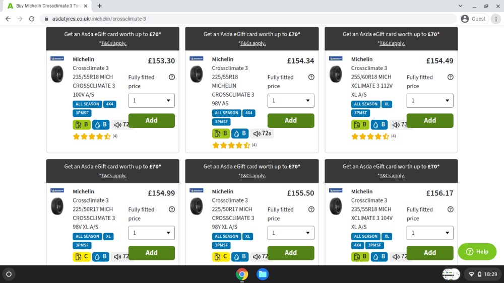

Are the CrossClimate 3 not available yet in the size required?

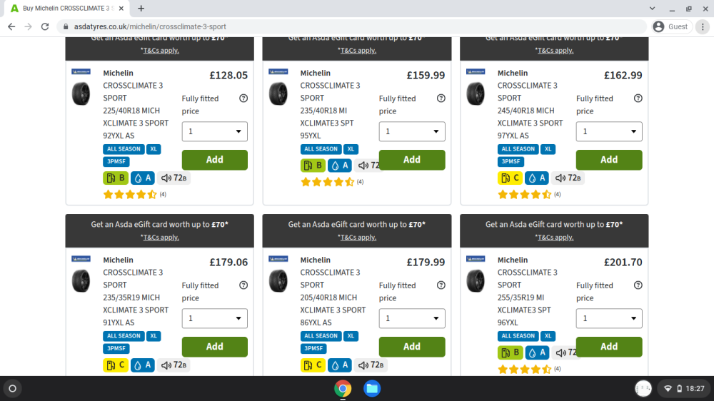

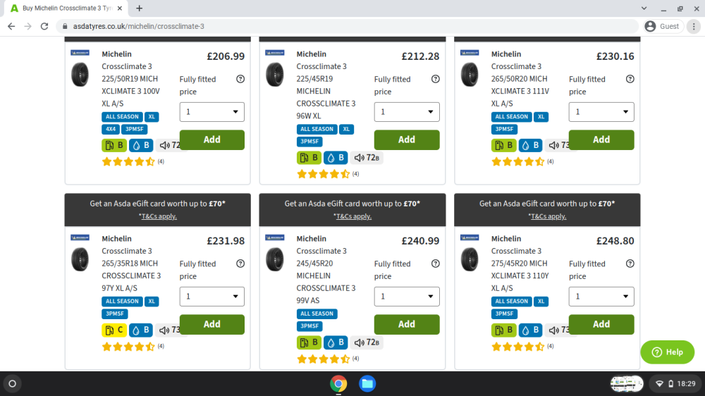

There are CrossClimate. CrossClimate + ,CrossClimate 2 CrossClimate 3, CrossClimate 3 Sport
& CrossClimate SUV,s.

The CrossClimate 3 is produced in the smaller sizes, the CrossClimate 3 Sport in the larger, with little overlap.
The CrossClimate 2 is thoroughly superseded. Michelin actually admitted in private that they made a mistake with the CrossClimate 2, at least for the UK market, by giving it superb snow performance at the expense of its grip on cold wet roads. In a UK winter we get quite a lot of the latter and not much of the former.
