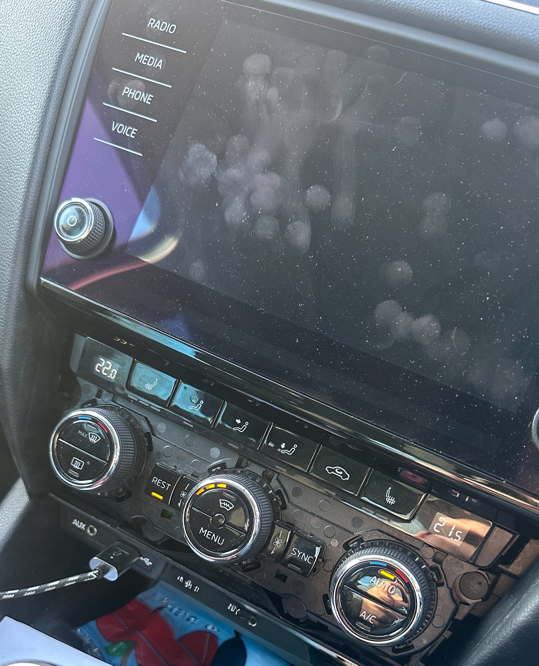

I fitted the superb panel to the Octavia as I wanted the recirculating option for when the car is off, the trim doesn’t fit properly, do I need to get the superb trim or is there something I can do with the trim?
You just need to dremel the plastic lugs off beside the temperature display and it will fit no problem
Hvac.docx
Ahhh Great! Thankyou, I've tried to open the attached document but it won't let me :(
Ah it was just a pic of where too cut but if you compare it to the one that came off you’ll see
