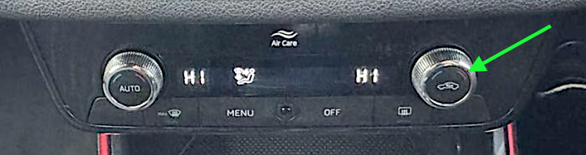

My Fabia's Owner'Manual indicates that two types of air-conditioning system are possible - manual or 'automatic' ("Climatronic").
Both have an air-recirculation button (marked with the usual symbol)
ScreenShot2025-11-17at18_27_41.png.93642
The button for the manual A/C is between the left and central rotating switches and the button for the Climatronic system is in the head of the right rotating switch.

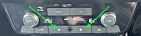

Hello , this is different to my 2023 Fabia, it's touch screen controls and no recirculation button or the usual symbol.
My 2024 Fabia SE L Climatronic air-con system is controlled through a mixture of physical buttons and the car's Amundsen infotainment full-touchscreen display .
Having looked at several online Fabia 2023 online adverts, it appears that this model's A/C system was controlled similarly, except the standard infotainment display was the "Bolero" unit that had no 'navigation' and (having a couple of physical buttons) was not 'full touchscreen'.
This image (taken from a 2023 Fabia Monte Carlo advert) is of the Bolero unit
Having looked at several online 2023 Fabia Monte Carlo online adverts, it appears that this model's A/C system was controlled similarly, except the standard infotainment display was the "Bolero" unit that had no 'navigation' and (having a couple of physical buttons) was not 'full touchscreen'.
and this image is of the car's air-con controls with the air-recirculation button green-arrowed.

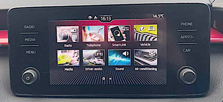

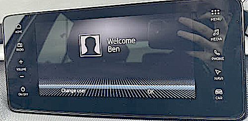

I notice that the design of the Amundsen infotainment touchscreen on my Fabia SE L (built on 16 January 2024) was revised for later models. Images of the two screens are shown below (oldest first) and it will be seen that the 'look' of the virtual buttons and their position differs with the more recent (lower "Welcome Ben") screen.
ScreenShot2025-11-20at08_06_47.png.97324

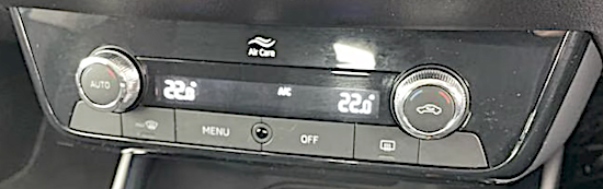

Perhaps more significant for a Fabia Mk4 driver are the modifications made to the controls for the Climatronic air-conditioning system.
The controls on my car are as shown in this image
and it will be seen from the image below of the later controls that the MENU and OFF buttons have been relocated upwards and their original positions now have manual buttons to decrease or increase the fan speed, rather than (infuriatingly) having to do this through the infotainment touchscreen.
I don't know exactly when the changes were made, but the online Owner's Manuals show the 'old' controls in the 19/6/2023 document (that applies to my car) and the 'new' controls in the 15/1/2024 version.

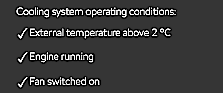

The AC is not operating if the ambient / outside temp is below 4*oC.
ALL Skoda Fabia Mk4 Owner's Manuals carry this information on the air-conditioning's operating conditions

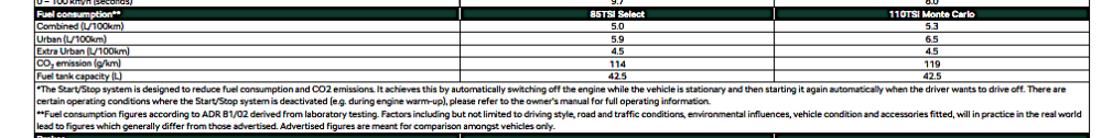

The rear page of my car's EC Certificate of Conformity carries WLTP fuel-consumption data (litres/100km). The combined figure given is 5.7 equating to 49.56 British MPG.
The fuel-consumption of one of my 1970s cars (a turbo-enhanced Reliant Scimitar GTE) could drop below 20mpg at the least provocation, so - if my Fabia can produce a genuine average consumption approaching 50mpg - I'll be delighted.
Edited by DerekU
That Worldwide Harmonised Testing is not bothered about all around the World as it is kidology and not Real World any more than the RDE2 figures are. Certainly the testing is nothing to do with vehicles having to breath air in with is below 10*oC. TSI,s do love colder / denser air. Then if the same tyres are fitted as in the summer the road surface might well have less friction. But for swings and roundabouts there is the extra warming up times and loads put on the battery if turning stuff on.
What makes you think an average 49mpg isn't good for a 1.0, 3-cylinder, turbo Monte Carlo version of the (modern, heavy) Fabia Mk4, what are you comparing it with, did you have the car at this time of year last year or before under same driving use and conditions to compare against?
There is a Skoda website relating to the current UK range of Fabia cars and each model has the WLTP combined fuel-consumption stated. All models, from the 'basic' SE Edition to the 130, have a WLTP datum of at least 50mpg.
It should be obvious that, if an owner of a Fabia SE Edition drives their car gently to consciously minimise fuel consumption and an owner of a Fabia 130 thrashes their car mercilessly, the amount of fuel used in each case will vary substantially.
However, to the best of my knowledge, there are no alternative-to-WLTP recognised data available to provide 'more realistic' fuel-usage information.
