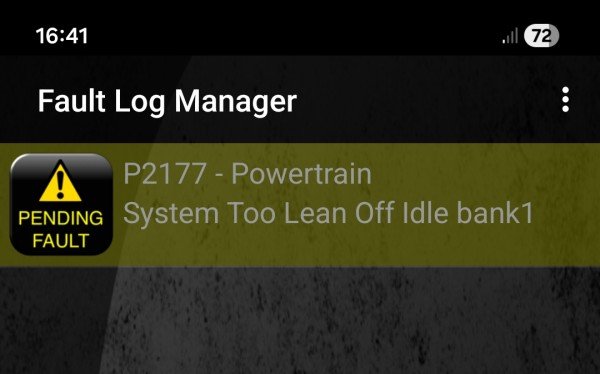

I used the app again yesterday as the fault once again reared it's head with the PID mpg dropping to 36 on a flat motorway journey down the M55 at 63mph. And yes I do think it looses power as the throttle response was not as expected when the problem was showing. When back at home I used the mobile app and it showed a "Pending Fault P2177 Power Train System too lean off idle bank 1". No other indications.
