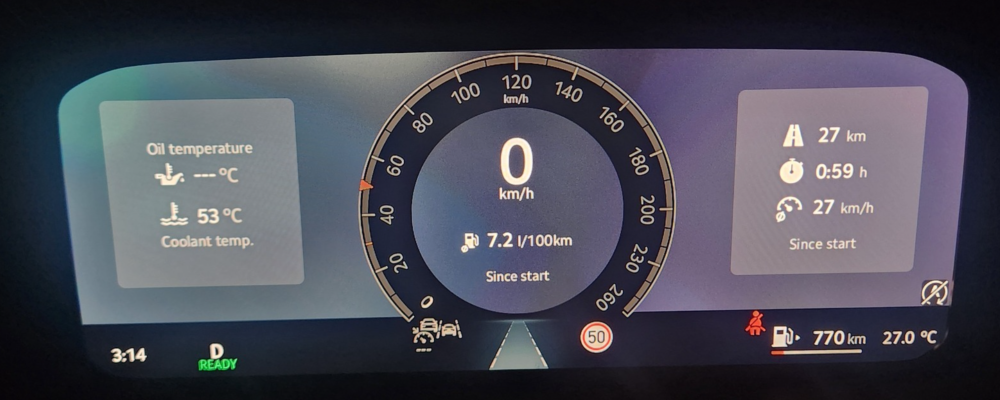

i have lots of problems using waze or Gmaps and spotify with android auto (Galaxy s25 ultra) in my Octavia 2025 FL SEL..
i was told by the dealer, its known issue, and to fix it, they need either update the version of the infotainment, or replace the GPS controller in the car, or replace the SOS module.
because in my car, there is also this virtual cluster:
and there no option to answer phone calls.. and they have recall on that..
