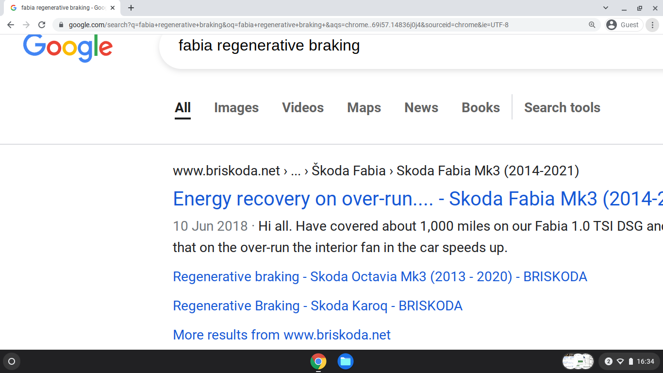

Is that a Skoda Dealership you called? Even with just petrol engines there is regenarative braking / recuperation to help put charge to the battery. Helps with efficiency / fuel reduction.

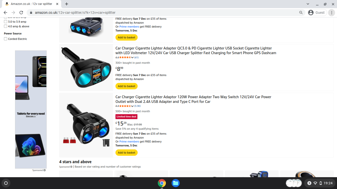

Consider getting one of the little LED-display voltmeters that plug into the accessory socket and give you a continuous readout of the battery voltage whilst on the move. Then you can get a feel for what the voltage ranges between and peaks at (probably on the over-run).
I have a dashcam plugged into that 😂
You get an adapter to plug in so that you can plug in 2 things.
